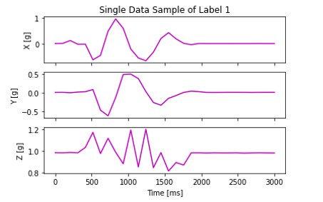

Plot data sample
This code block plots the accelerometer data of one training sample.
def plot_single_sample(data_sample, label='Not Specified'):
plt.clf()
scaling = 2**10 # The STM ADC is 10bit so scale to get [g]
fig, axs = plt.subplots(3)
t = np.linspace(0, data_sample.shape[1] * 100, data_sample.shape[1])
# Accelerometer sampled with 100 ms
axs[0].set_title(label='Single Data Sample of Label {}'.format(label))
axs[0].plot(t, data_sample[0]/scaling, c='m')
axs[0].set_ylabel('X [g]')
plt.setp(axs[0].get_xticklabels(), visible=False)
axs[1].plot(t, data_sample[1]/scaling, c='m')
axs[1].set_ylabel('Y [g]')
plt.setp(axs[1].get_xticklabels(), visible=False)
axs[2].plot(t, data_sample[2]/scaling, c='m')
axs[2].set_ylabel('Z [g]')
plt.xlabel('Time [ms]')
plt.show()
idx = random.randint(0, len(data)-1)
plot_single_sample(data_sample=data[idx], label=labels[idx])
Example output is shown below:
