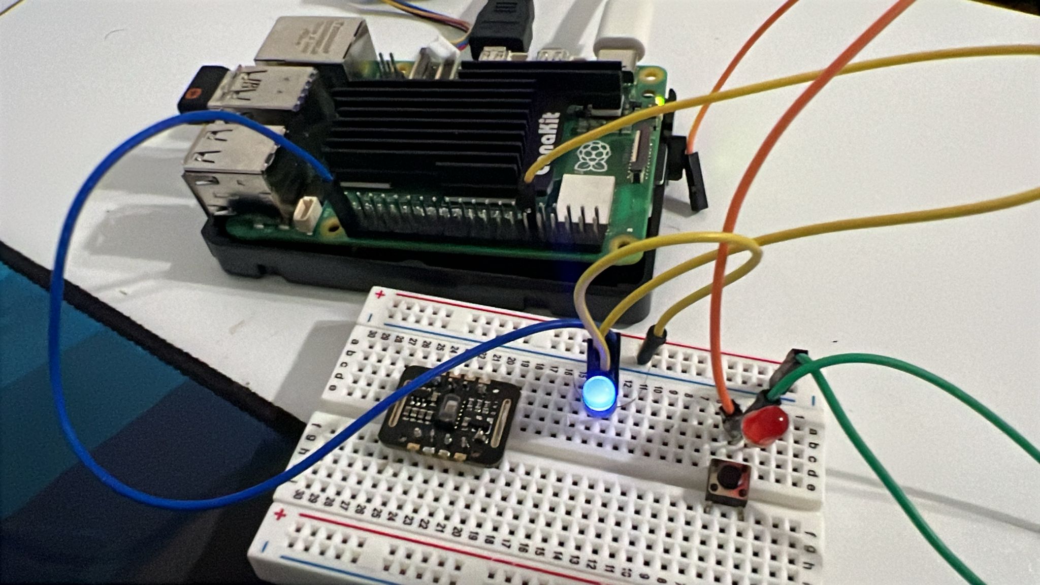

In the previous section, you configured a LED on GPIO pin 17. The smart home assistant is by default associating this with a living_room_light device. The single LED setup is enough to run through this Learning Path. If you’d like to connect actual devices, or play with more mock sensors, the default configuration looks like the table below. You can repeat the steps on the previous page to verify the hardware setup on the different GPIO pins. See the image below for an example.

Setup that includes a blue LED (mapped to Living Room Light on GPIO 17), a red LED, push button, and a sensor module.
This setup illustrates a simulated smart home with controllable devices.

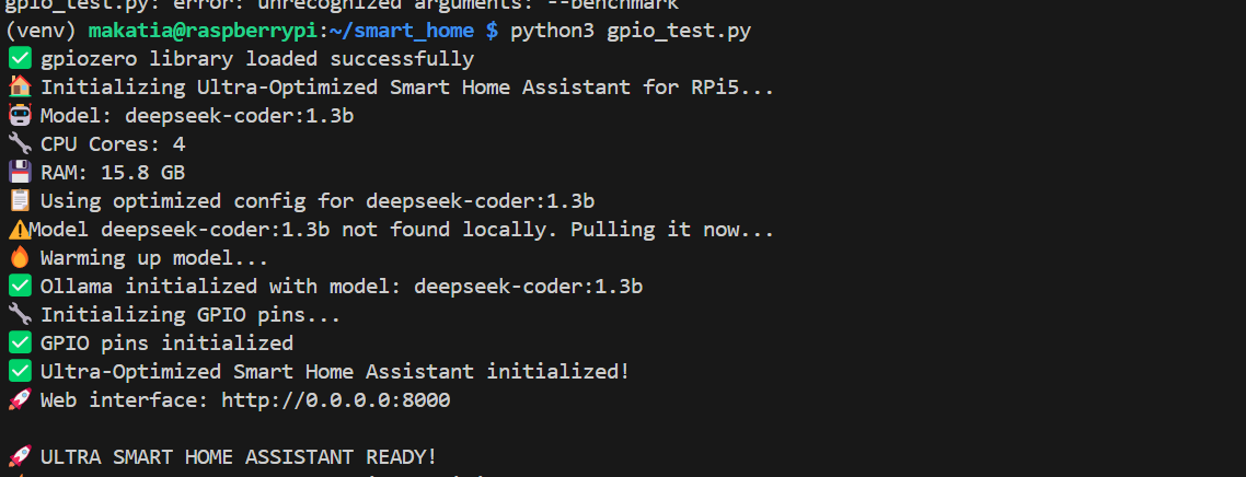

If everything is set up correctly, you should see the following output on running the default command:
Running the code in default mode

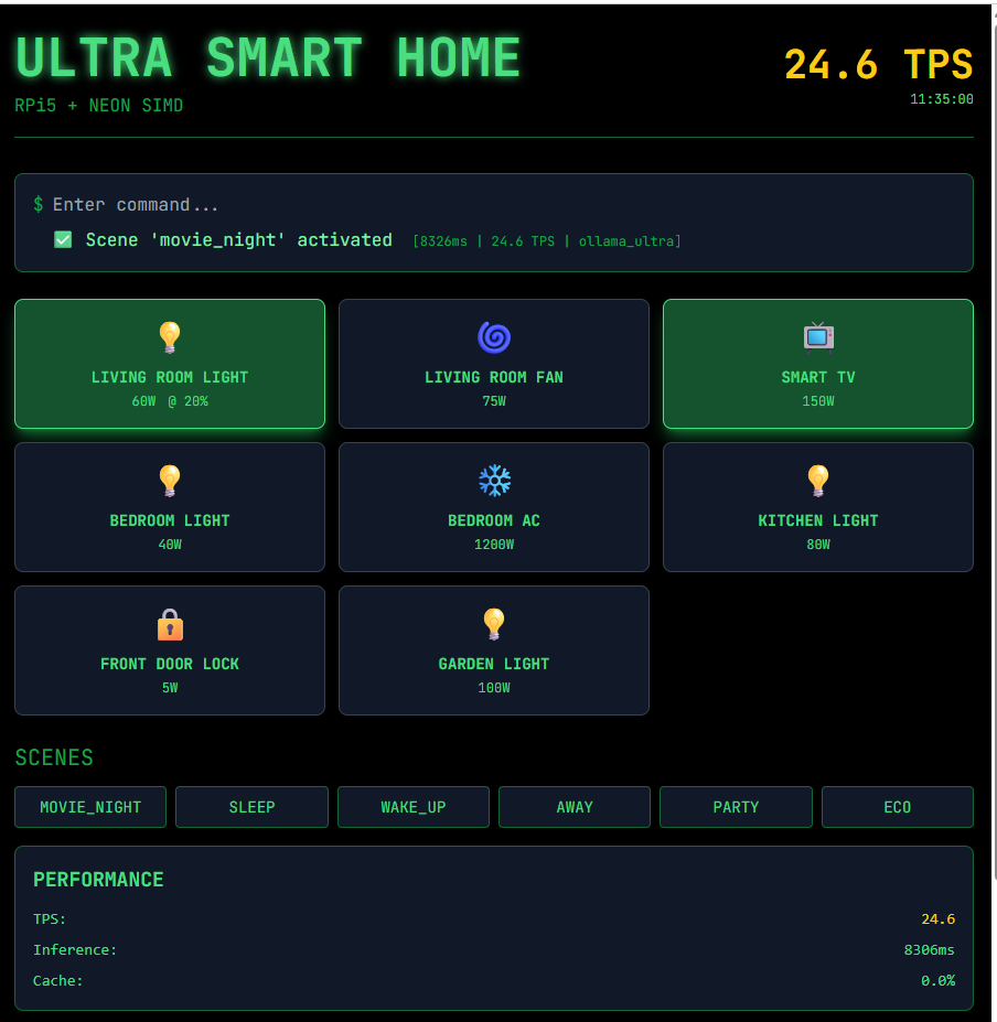

Try asking the assistant to turn on living room light. If you’ve connected additional devices, come up with prompts to test the setup.
Open your browser and navigate to http://0.0.0.0:8000, or as printed in the terminal output.
Interacting with the LLM through the web interface

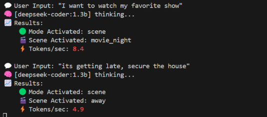

Type commands directly in the terminal.
Sample commands:
I want to watch my favorite show
its getting late, secure the house
Interacting with deepseek-coder:1.3b
