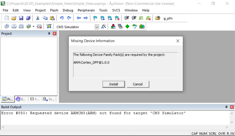

## Missing device
The following error occurs when you try to migrate a project to CMSIS v6 but you have not installed the Cortex_DFP pack:
![Image Alt Text:Requested device not found for target](https://learn.arm.com/learning-paths/embedded-and-microcontrollers/project-migration-cmsis-v6/device_missing.png)
**Resolution**
Install [ARM.Cortex_DFP.1.0.0.pack](https://www.keil.arm.com/packs/cortex_dfp-arm) or above.

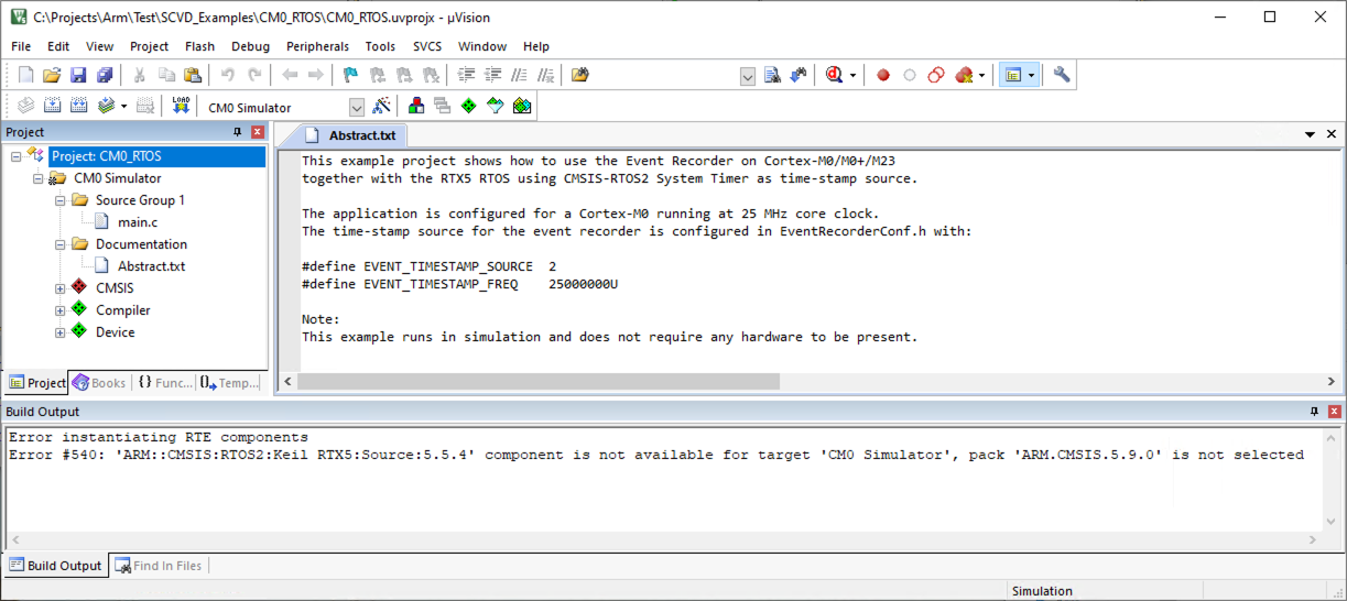

## Error instantiating RTE components
The following error occurs when you try to migrate a Keil RTX-based project but you have not installed the CMSIS-RTX pack:
![Image Alt Text:Keil RTX5 component not available for target](https://learn.arm.com/learning-paths/embedded-and-microcontrollers/project-migration-cmsis-v6/cmsis-rtx_missing.png)
**Resolution**
Install [ARM.CMSIS-RTX.5.8.0.pack](https://www.keil.arm.com/packs/cmsis-rtx-arm) or above.

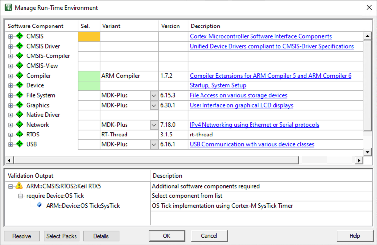

### Migrating Keil RTX5-based projects
The following warning is shown in the Validation Output window when you try to migrate a Keil RTX-based project:
![Image Alt Text:Additional software components required](https://learn.arm.com/learning-paths/embedded-and-microcontrollers/project-migration-cmsis-v6/os_tick_missing.png)
**Resolution**
Use the **Resolve** button to select the missing component automatically.

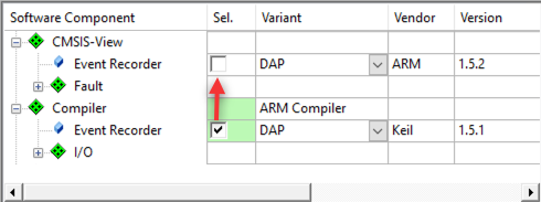

1. **Compiler:EventRecorder migration**
   Deselect the `Compiler:Event Recorder` component and select the `CMSIS-View:Event Recorder` component:
   ![Image Alt Text:Event Recorder migration](https://learn.arm.com/learning-paths/embedded-and-microcontrollers/project-migration-cmsis-v6/eventrecorder_migration.png)

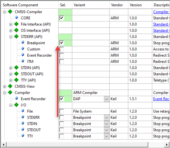

2. **Compiler:I/O migration**
   Deselect any component of `Compiler:I/O` and select the corresponding `CMSIS-Compiler` component:
   ![Image Alt Text:I/O migration](https://learn.arm.com/learning-paths/embedded-and-microcontrollers/project-migration-cmsis-v6/io_migration.png)
   This table helps you to identify the correct components:
   | Compiler:I/O:   | CMSIS-Compiler:           |
   | STDERR@Breakpoint | STDERR (API):Breakpoint    |
   | STDERR@ITM       | STDERR (API):ITM          |
   | STDERR@User      | STDERR (API):Custom       |
   | STDIN@Breakpoint  | STDIN (API):Breakpoint    |
   | STDIN@ITM        | STDIN (API):ITM          |
   | STDIN@User       | STDIN (API):Custom       |
   | STDOUT@Breakpoint | STDOUT (API):Breakpoint   |
   | STDOUT@EVR       | STDOUT (API):EventRecorder |
   | STDOUT@ITM       | STDOUT (API):ITM         |
   | STDOUT@User      | STDOUT (API):Custom       |
   | TTY@Breakpoint    | TTY (API):Breakpoint      |
   | TTY@ITM         | TTY (API):ITM           |
   | TTY@User        | TTY (API):Custom         |
**Note**
All CMSIS-Compiler components require CMSIS-Compiler:Core to be present.

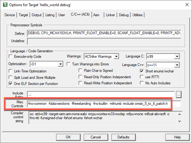

### Resolution for µVision projects
1. Please download this [header file](https://armkeil.blob.core.windows.net/developer/Files/downloads/cmsis/cmsis_5_to_6_patch.h) to a `<known_location>`. A good place would be the project directory.
2. Go to **Project - Options for Target** and switch to the **C/C++ (AC6)** tab. Add `-include <known_location>\cmsis_5_to_6_patch.h` to the **Misc Controls**:
   ![Image Alt Text:Add patch file](https://learn.arm.com/learning-paths/embedded-and-microcontrollers/project-migration-cmsis-v6/coredebug_uvision.png)
3. Rebuild the project.
