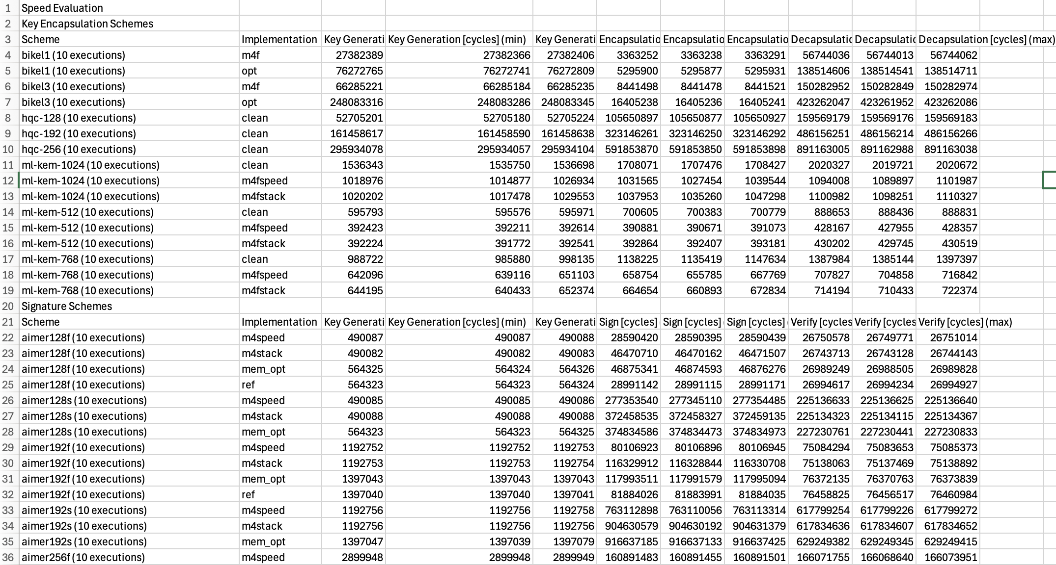

Results are saved to `<code>benchmarks.csv</code>`. The screenshot shows an example of the benchmark output:
![Example benchmark results for ML-KEM-768](https://learn.arm.com/learning-paths/embedded-and-microcontrollers/pqc_pqm4/./benchmarks.png)
*Example benchmark results for ML-KEM-768*
