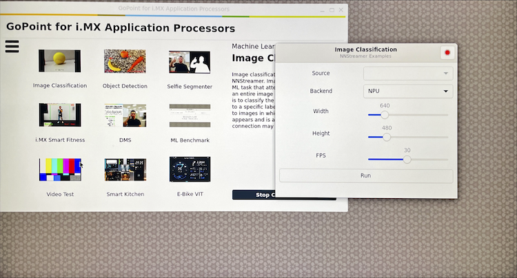

Run the built-in NXP demos (optional)
Connect the board to a monitor via HDMI and plug a mouse into the board’s USB-A port. NXP includes several ML demos that run out of the box.
Image Alt Text:NXP board built-in ML demos alt-textNXP board built-in ML demos
