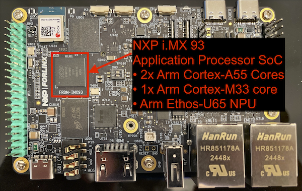

Why this board is useful for ML on Arm
The NXP FRDM i.MX 93 board is a practical way to validate ML workloads on real Arm hardware early in your workflow.
It combines:
  • An Arm Cortex-A55 application processor for Linux-based development
  • An Arm Cortex-M33 microcontroller for real-time tasks
  • An Arm Ethos-U65 NPU (neural processing unit) for on-device inference acceleration
The following image highlights the i.MX 93 SoC and the NPU location on the board:
Image Alt Text:NXP FRDM i.MX 93 Board SoC Highlighted alt-textArm Ethos-U65 NPU location

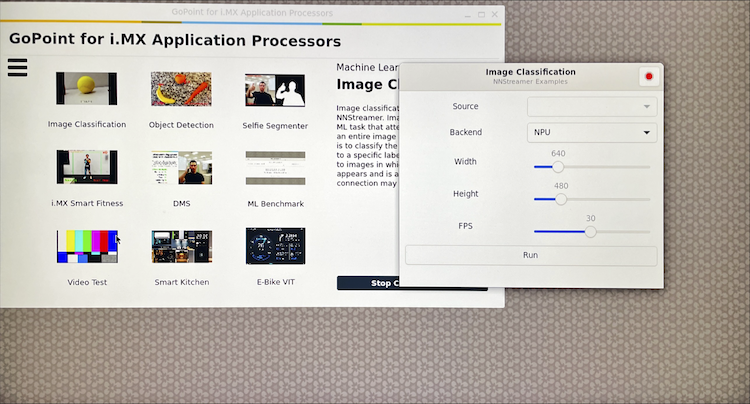

(Optional) Run the built-in NXP demos
If you connect the board to a display, you can see ML demos and application output directly on the device. This is useful when you want quick visual confirmation that your model runs on the target hardware. As per the setup instructions in NXP’s getting started guide :
  • Connect the board to a monitor via HDMI.
  • Connect a mouse to the board’s USB-A port.
The demos will then show up automatically.
Image Alt Text:NXP board built-in ML demos alt-textNXP board built-in ML demos
