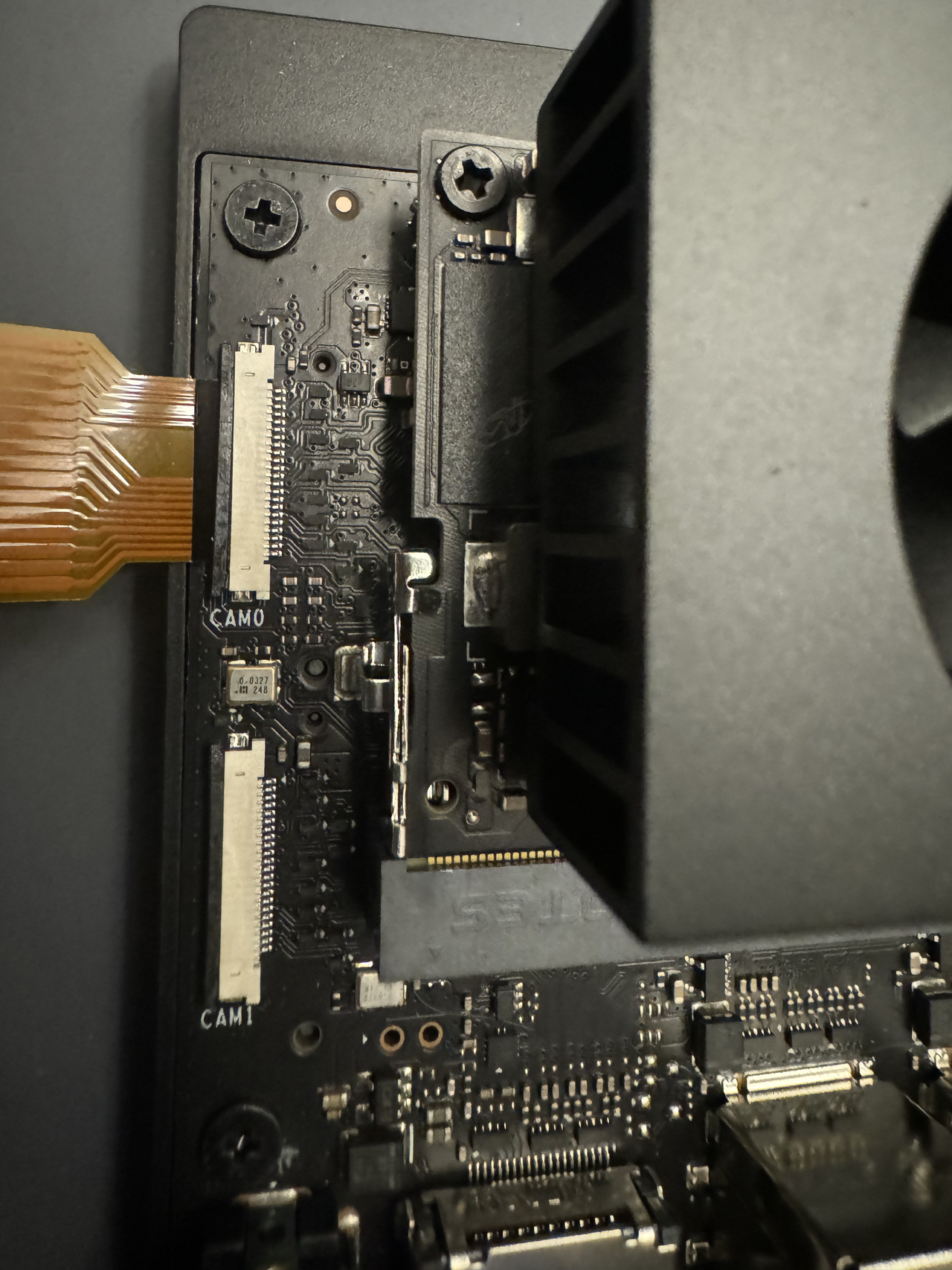

## Connect the camera to the Jetson Orin Nano
Insert the 22 pin side (it is smaller than the 15 pin side) of the ribbon into the CSI connector labeled “CAM0.” It should be inserted silver pin side down. If you are unsure of how to insert the ribbon into the connector, [watch the video explaining the process](https://www.youtube.com/watch?v=EuRXAUU61yM&t=7s).
> **Note**
> You can use a USB camera instead for object detection, but the instructions below assume a MIPI CSI-2 camera.
![Image Alt Text:image of the ribbon inserted into the connector](/learning-paths/embedded-and-microcontrollers/jetson_object_detection/./cam0connector.webp)
