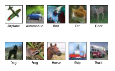

This code block below will visualize the saved images.
```python
# Show saved images
files = os.listdir(path_images)
for img in files:
    if os.path.splitext(img)[1] == ext and os.path.splitext(img)[0] in class_names:
        #print(os.path.splitext(img)[0])
        plt.subplot(2, 5, class_names.index(os.path.splitext(img)[0]) + 1)
        plt.xticks([])
        plt.yticks([])
        plt.grid(False)
        plt.imshow(mpimg.imread(path_images + img))
        plt.xlabel(os.path.splitext(img)[0])
plt.show()
The expected output is shown below.
![Output 1](https://learn.arm.com/learning-paths/embedded-and-microcontrollers/img_nn_stcube/images/lab4_1.png)

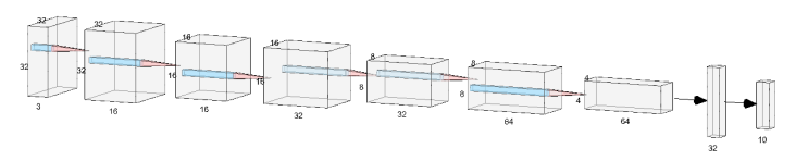

You are going to create a small convolutional neural network for image classification. The image size of CIFAR10 is 32 by 32, and the number of color channels is 3. So, the input shape of the first convolution layer is (32, 32, 3). Since the number of classes is 10, so the last dense layer should have 10 units.
Here is an image illustrating the network architecture. Note that only convolution and dense layers are illustrated in this image.
![Output 2](https://learn.arm.com/learning-paths/embedded-and-microcontrollers/img_nn_stcube/images/lab4_2.png)
Execute the code blocks below to create a sequential model and add the layers.
