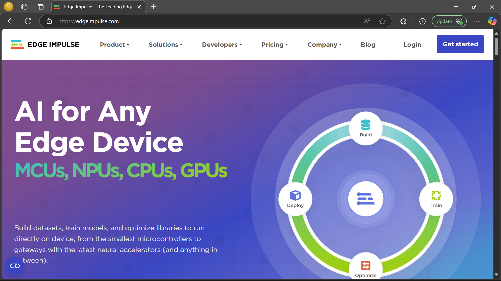

 Home page of Edge Impulse website

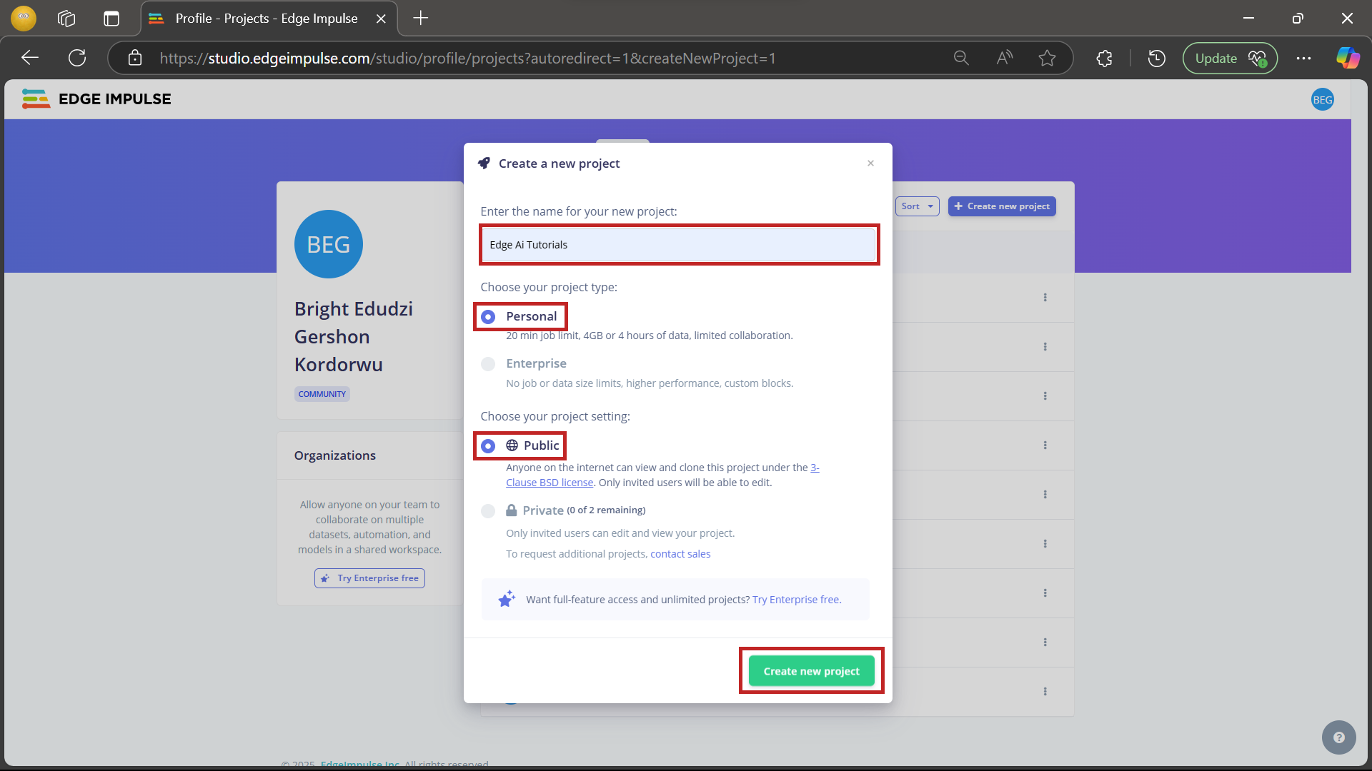

After you create your account and log in, the first step is to create a new project. Give your project a name that clearly reflects its purpose. This helps with easy identification, especially if you plan to build multiple models.
For example, if you’re building a keyword-spotting model, you might name it Wake word detection.
You’ll also need to select the appropriate project type and project settings, as shown in the screenshot below.
 New project setup
New project setup

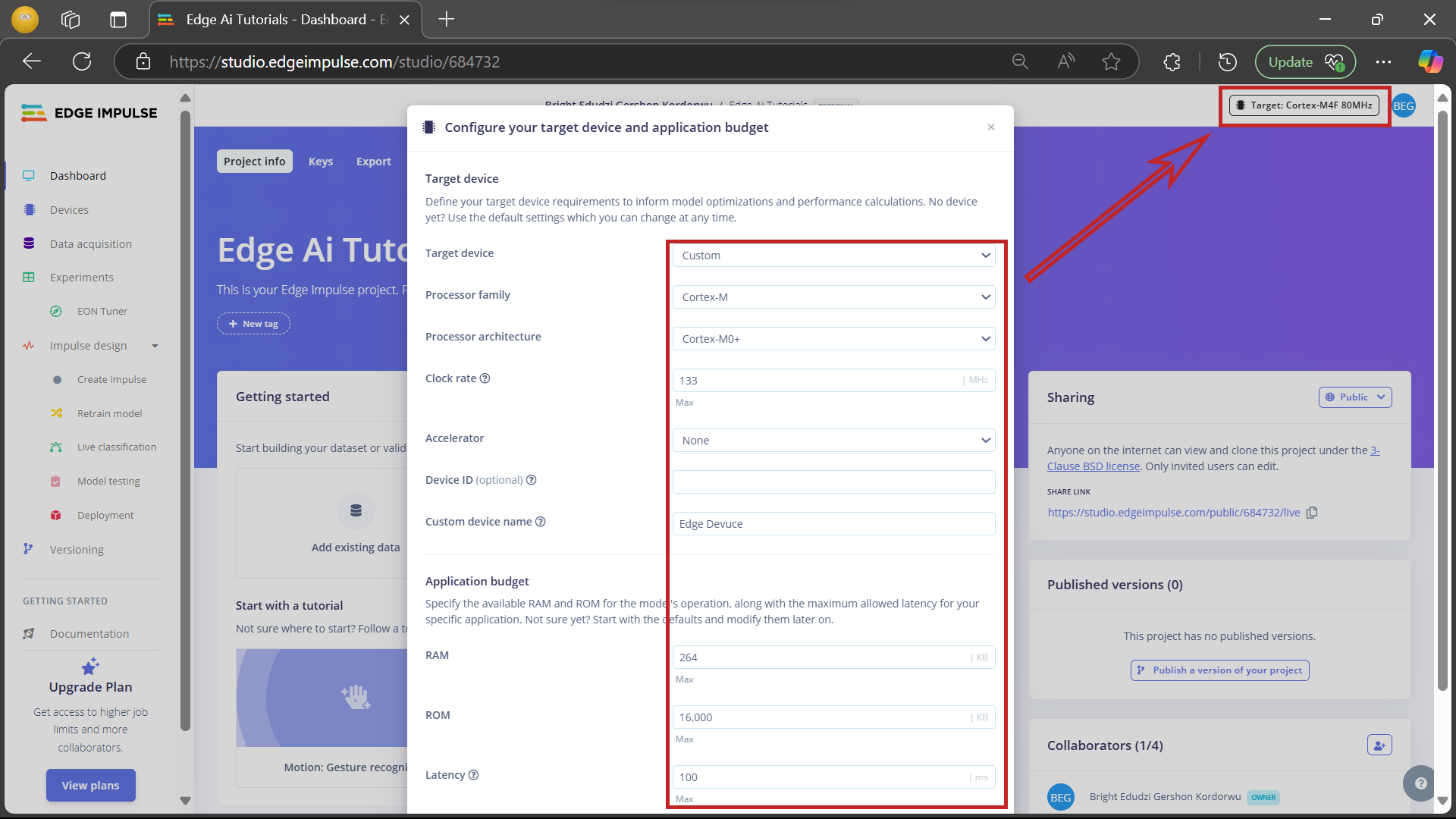

After creating your project, the next step is to configure the target device. As you’re using the Arduino Nano RP2040 Connect, click the button highlighted in the screenshot to begin the configuration process. This ensures that data collection, model training, and deployment are optimized for your hardware.
You can find the full specifications for the Arduino Nano RP2040 Connect on Arduino’s official product page .
Follow the settings shown in the screenshot to complete the configuration.

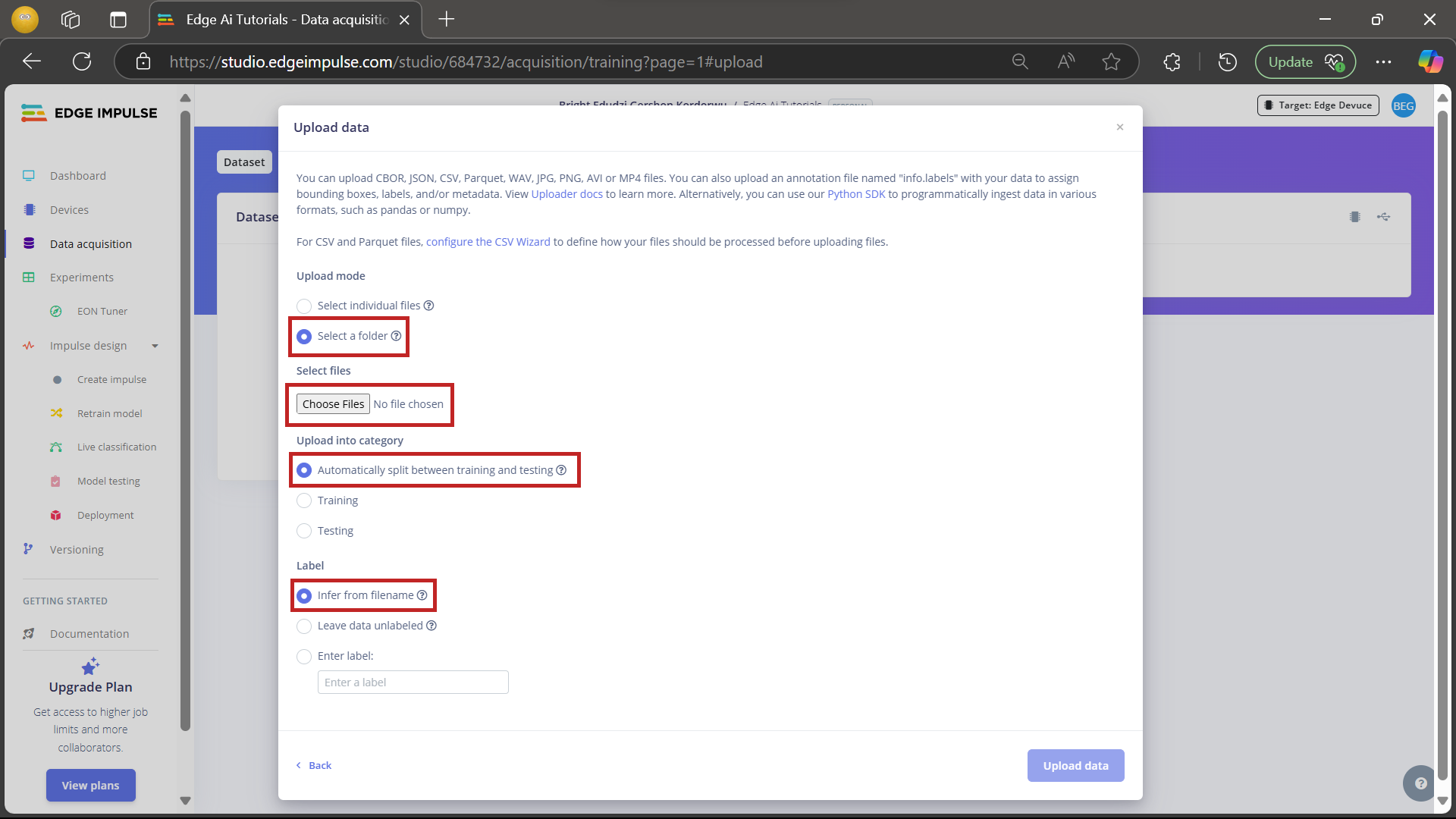

With your device configured, the next step is to add your dataset to the project. Click Add existing data and follow the configuration settings shown in the screenshot. This lets you upload pre-recorded data instead of collecting it live, which can save time during development.
An example repository has been prepared with assets used throughout this Learning Path. You can clone it with the following command:
git clone https://github.com/e-dudzi/Learning-Path.git
The repository contains a Dataset.zip file with the dataset used in this project. Extract the contents to your local machine. For convenience, the dataset is already split into training and testing sets.

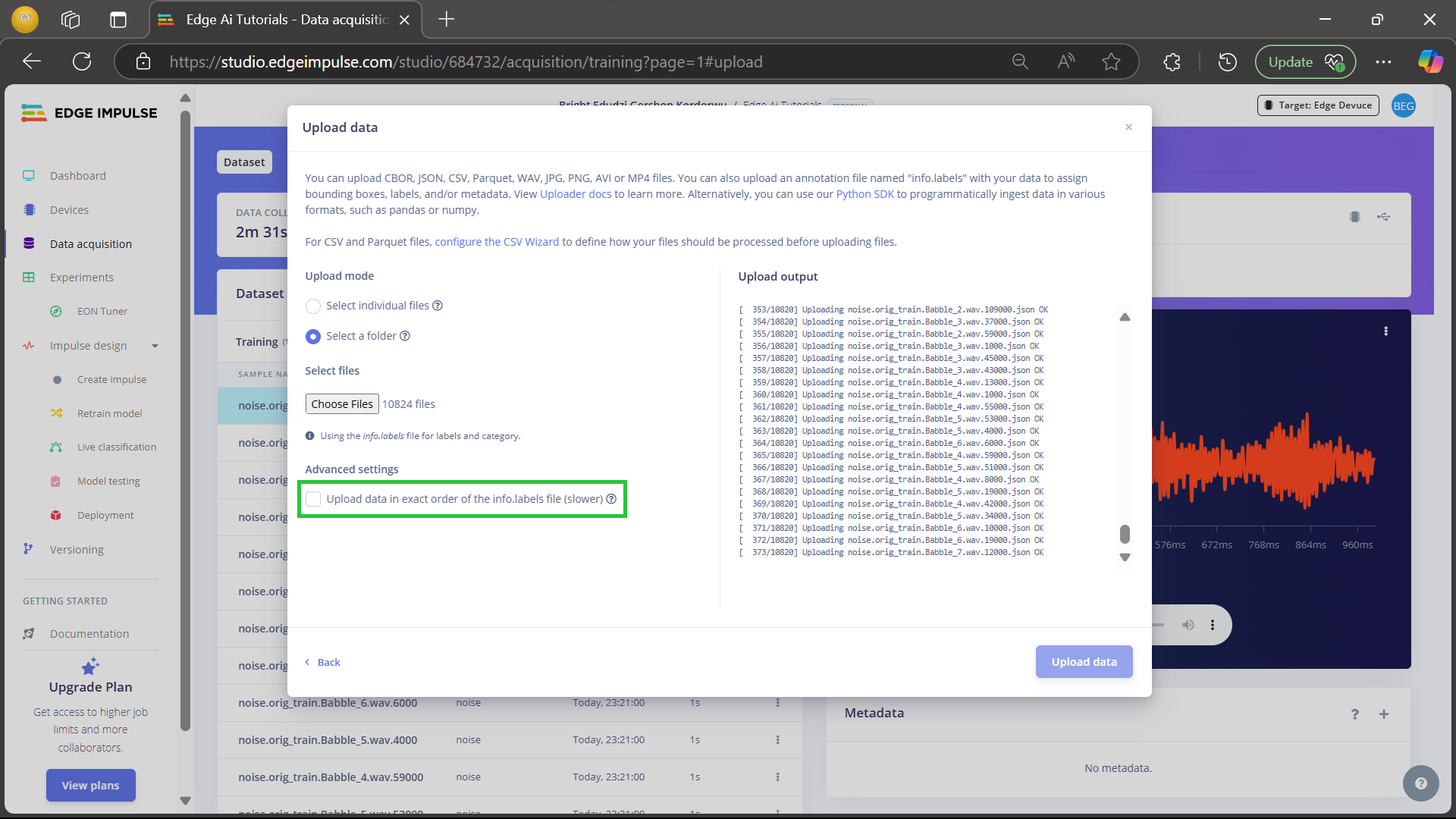

Do not check the green highlighted area during upload. The dataset already includes metadata. Enabling that option may result in much slower upload times and is unnecessary for this project.

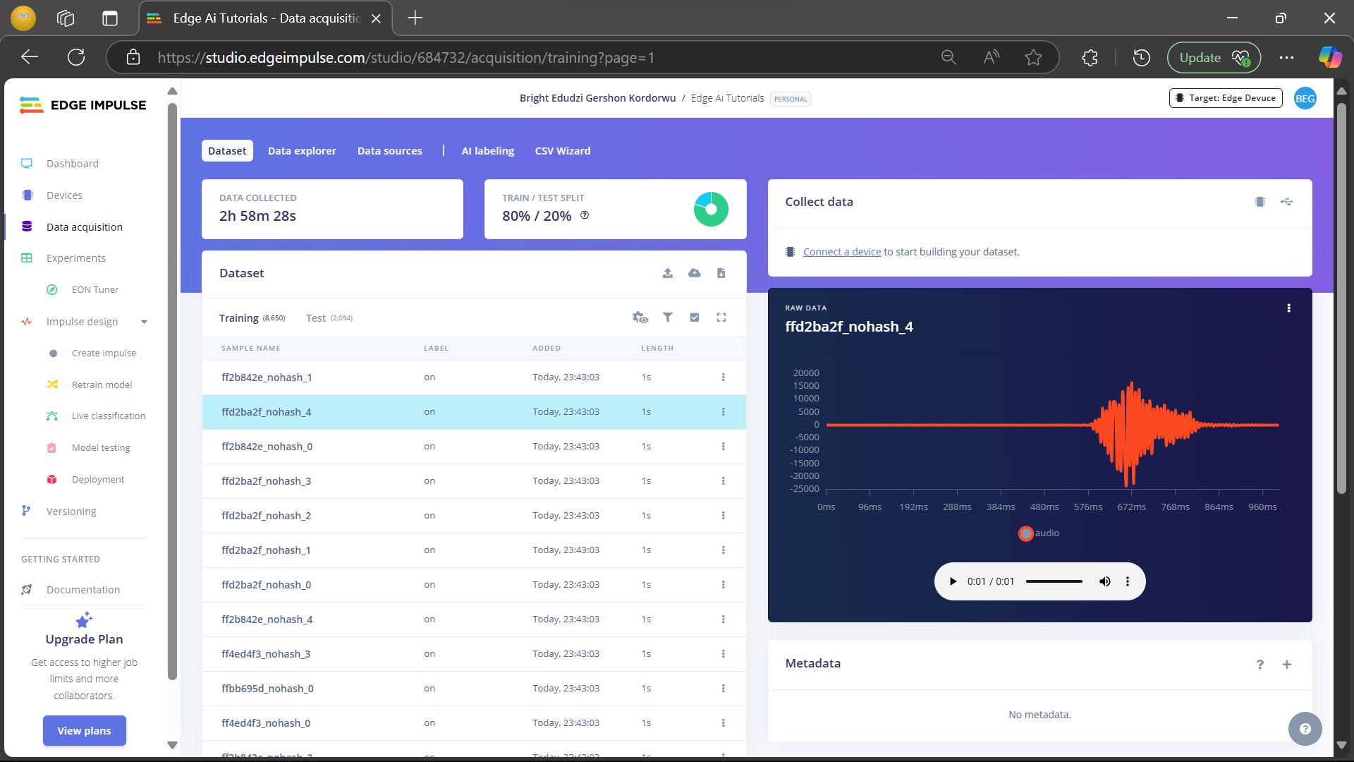

After the dataset is uploaded, you’ll see the samples listed in the Data acquisition tab, organized by their labels. You can click each sample to inspect the raw signal, view metadata, and even listen to the audio recordings directly within the Edge Impulse interface. This helps confirm that the uploaded data is accurate and ready for training.
This dataset is consists of four labels:
 Dataset overview
Dataset overview

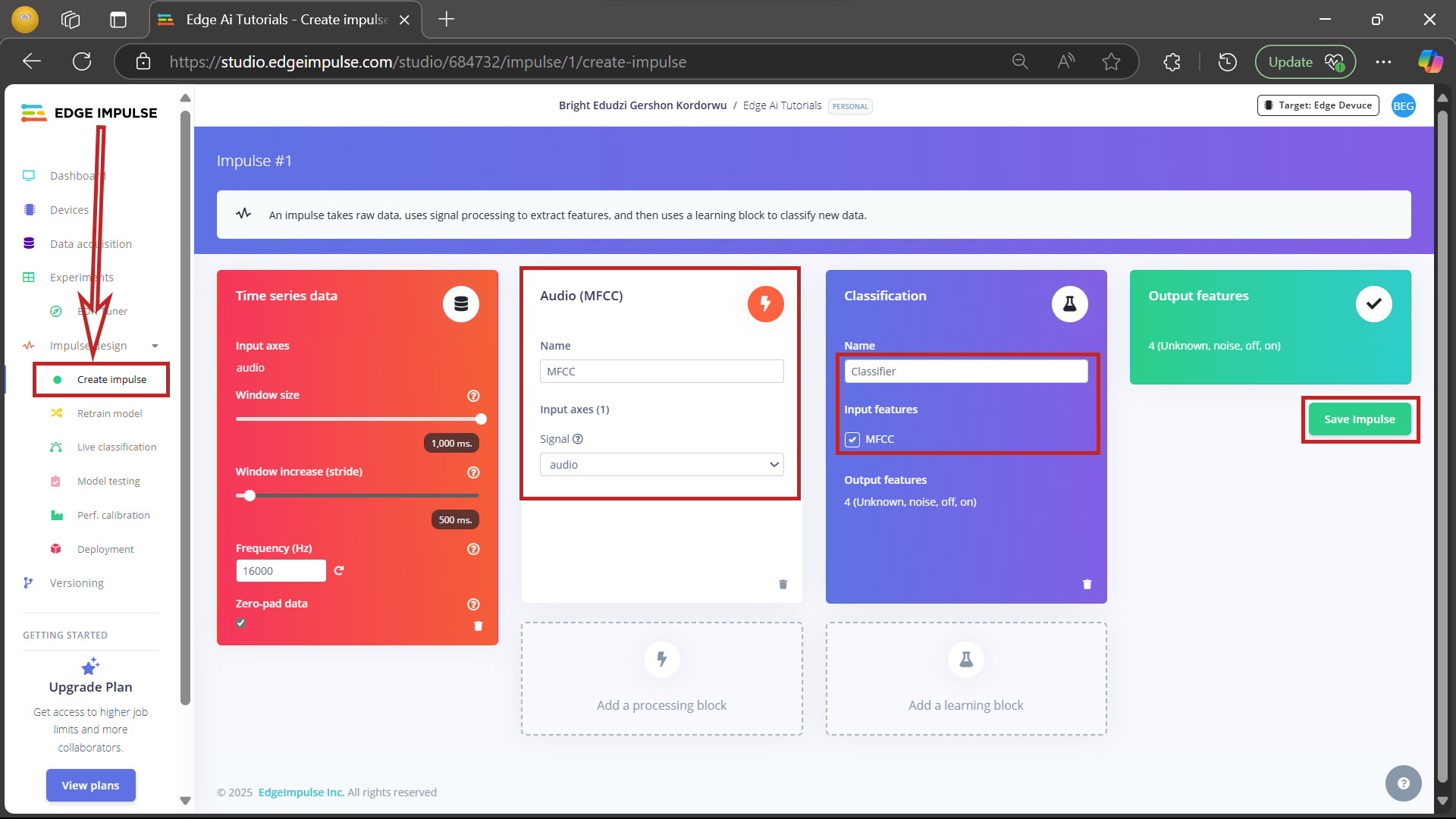

Now that your data is ready, it’s time to create the impulse. An impulse defines the flow of data from input to output using processing and learning blocks.
Click Create impulse in the menu and configure it as shown in the screenshot. Typically, this includes setting the input data type (such as audio), adding a processing block (like MFCC), and a learning block (such as a neural network classifier).
After configuring the impulse, make sure to save your changes.

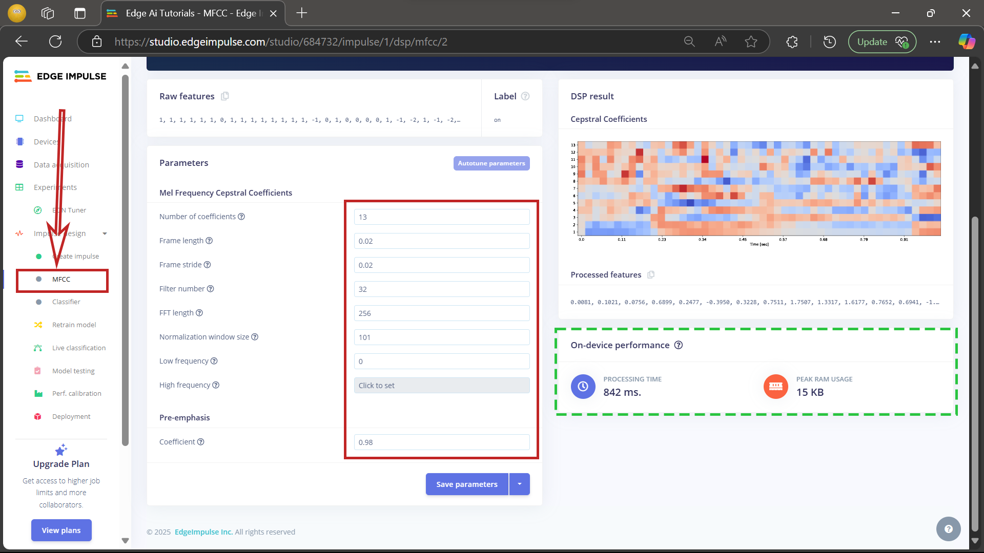

Next, you’ll configure the MFCC (Mel Frequency Cepstral Coefficients) processing block. This block transforms raw audio into features suitable for training your model.
Click MFCC in the left-hand menu under the Impulse design section.
Set the parameters exactly as shown in the screenshot. These settings determine how the audio input is segmented and analyzed. Once complete, make sure to save the parameters.
These defaults are chosen for this Learning Path, but you can experiment with different values once you’re more familiar with Edge Impulse.
 MFCC block configuration

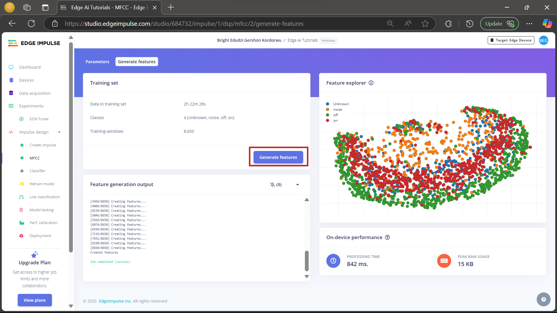

After saving the MFCC parameters, the next step is to generate features from your dataset. Click Generate features to begin. Edge Impulse will process your data using the MFCC configuration and create a feature set for training.
When complete, you’ll see a 2D feature plot that shows how the data is distributed across the four labels: on, off, noise, and unknown. This helps visually confirm whether the classes are distinct and learnable.

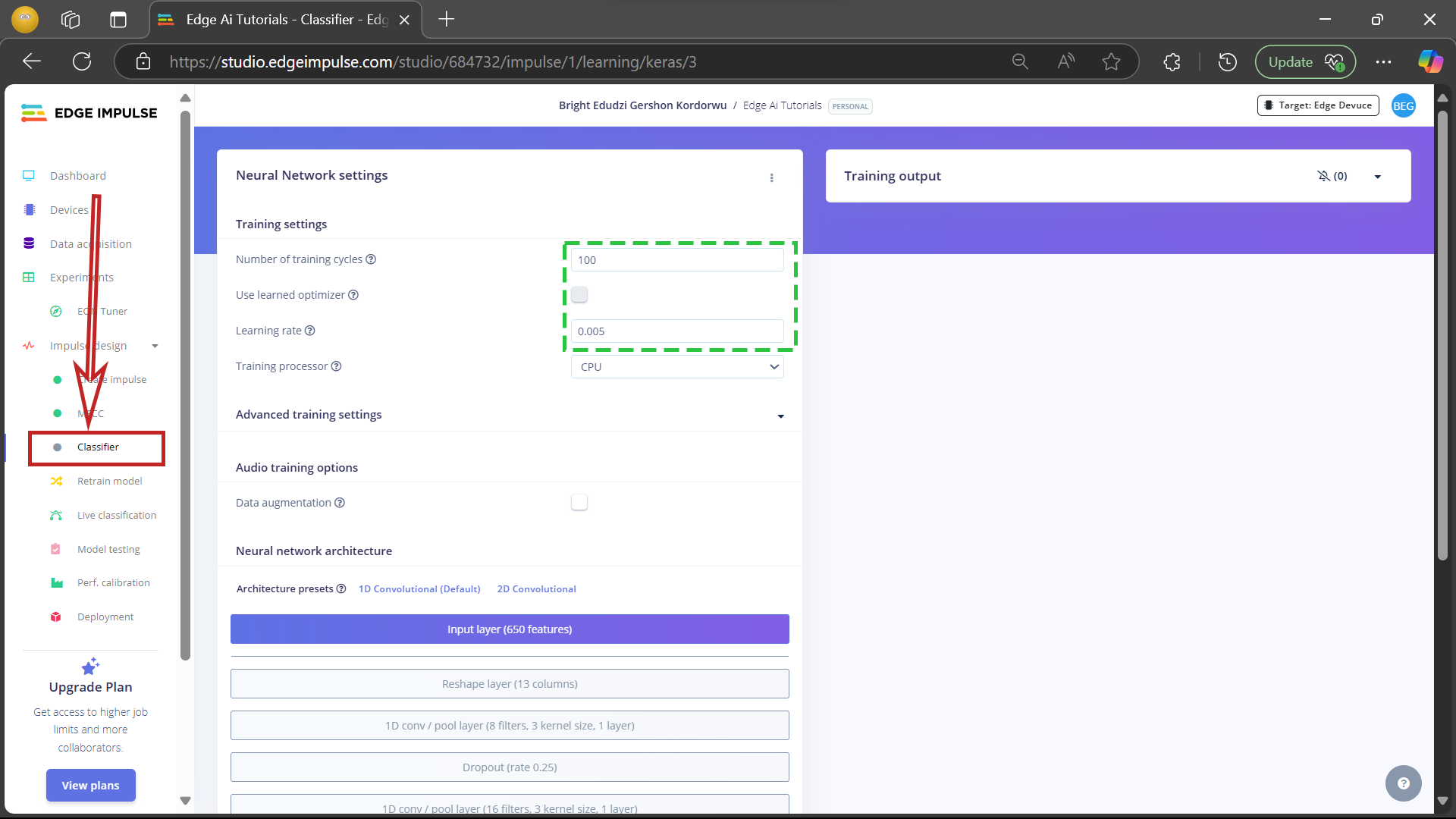

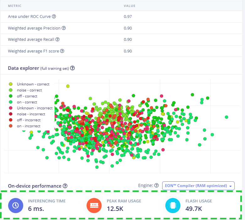

Now it’s time to configure the neural network classifier, which learns to recognize different audio commands. Click Classifier under Impulse design and set the parameters as shown in the screenshot.
Once all parameters are set, click Save and train to begin training your model.

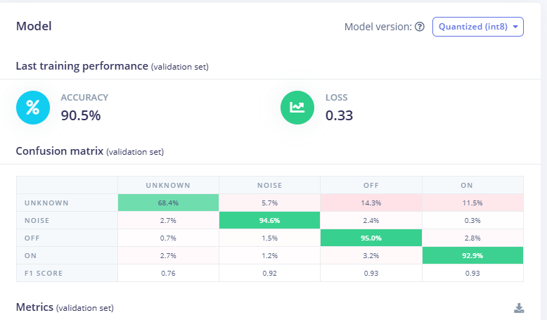

After training is complete, Edge Impulse displays key performance metrics, including accuracy, loss, and a confusion matrix.
Review these results to evaluate how well your model learned. If needed, adjust the configuration or retrain to improve accuracy.
On-device performance (EON Compiler – RAM optimized):
| Metric | Value |
| Inference time | 6 ms |
| Peak RAM usage | 12.5 KB |
| Flash usage | 49.7 KB |

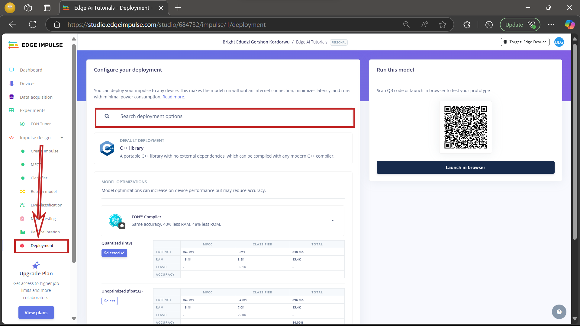

To run the trained model on your Arduino Nano RP2040 Connect, export it as an Arduino library:
The model will be downloaded as a .zip file, which you can import into the Arduino IDE.
