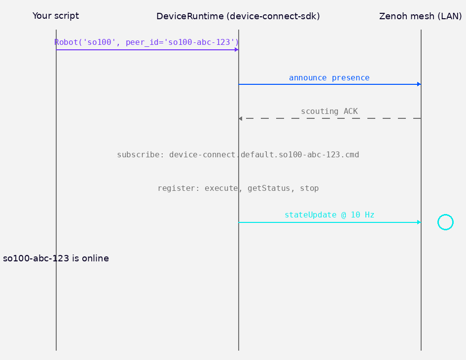

Two things happen when this script runs.
Robot('so100') calls the factory function, which checks for USB servo hardware and, finding none, creates a MuJoCo Simulation instance. On the first run it downloads the SO-100 MJCF physics model from Hugging Face — this can take up to 20 minutes depending on your connection. Subsequent runs use the local cache and start immediately.
r.run() calls init_device_connect_sync(), which does the following:
  1. Creates a SimulationDeviceDriver — a Device Connect DeviceDriver adapter that wraps the simulation and maps its methods to structured RPCs.
  2. Starts a DeviceRuntime with the Zenoh D2D backend. No broker or environment variables are needed; devices discover each other on the LAN via Zenoh multicast scouting.
  3. Subscribes the device to its command topic: device-connect.default.<PEER_ID>.cmd.
  4. Registers RPC handlers: execute, getStatus, getFeatures, step, reset, and stop.
  5. Starts a 10Hz background loop that emits stateUpdate and observationUpdate events to any listener on the mesh.
Image Alt Text:Sequence diagram showing the call flow when r.run() executes: the script calls Robot() and DeviceRuntime, which announces presence to the Zenoh mesh, subscribes to the command topic, registers RPC handlers, and starts emitting stateUpdate events at 10 HzCall flow inside r.run(): device registration and event publishing over Zenoh
The output is similar to:
        device_connect_sdk.device.so100-abc123 - INFO - Using ZENOH messaging backend
device_connect_sdk.device.so100-abc123 - INFO - Connected to ZENOH broker: []
device_connect_sdk.device.so100-abc123 - INFO - Driver connected: strands_sim
device_connect_sdk.device.so100-abc123 - INFO - Subscribed to commands on device-connect.default.so100-abc123.cmd
🤖 so100-abc123 is online. Ctrl+C to stop.
Leave this process running. The simulated robot is only discoverable as long as this process is alive.
