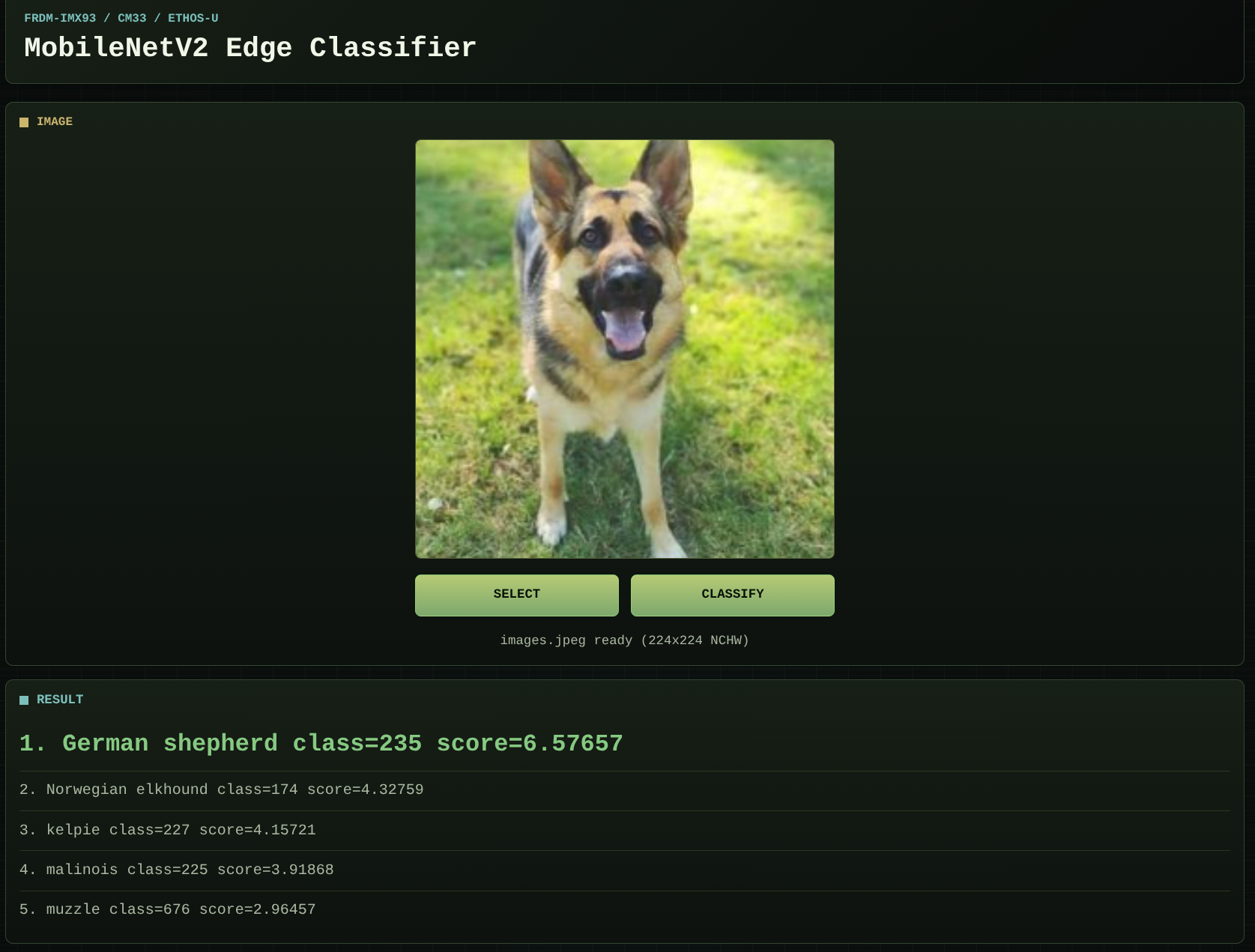

The application shows:
- an image selector
- a **Classify** button
- board prerequisite checks
- classification results
- an expandable analysis section with runtime details
![Image Alt Text:Screenshot of the web interface running on an Arm-based target, showing an image and the model response. This confirms successful deployment and provides a visual reference for the expected result.](https://learn.arm.com/learning-paths/embedded-and-microcontrollers/deploy-ml-model-to-npu-with-topo/topo_npu_classifier.png "Image classification web app showing correctly classified German Shepherd")
When you choose an image in the browser and select **Classify**, the web application:
1. Resizes and normalizes the image to classify into an input tensor compatible with the [MobileNetV2](https://arxiv.org/abs/1801.04381) model.
2. Writes the ExecuTorch `.pte` program and input tensor into reserved physical memory.
3. Sends a `RUN` command to the Cortex-M33 runner over `RPMsg`.
4. Waits for the Cortex-M33 firmware to run inference using Ethos-U65 acceleration.
5. Displays the top-1 and top-5 ImageNet classification results in the browser.
