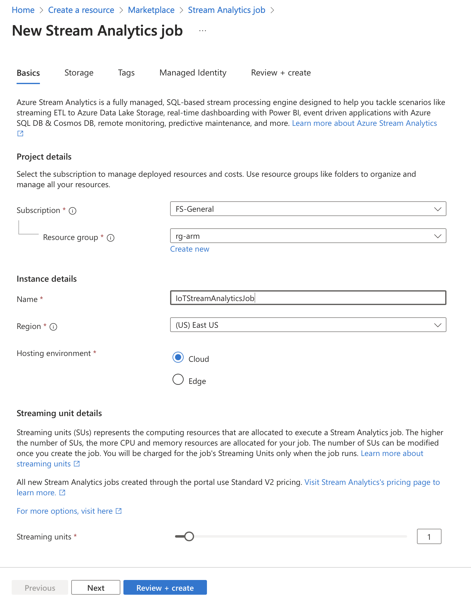

4. Provide the necessary information:
   - **Subscription**: choose the Azure subscription you want to use for this job.
   - **Resource group**: select the resource group you previously created (e.g., your IoT project’s resource group).
   - **Name**: provide a meaningful, unique name for your Stream Analytics job (e.g., IoTStreamAnalyticsJob).
   - **Region**: choose the same Azure region as your IoT Hub for optimal performance and minimal latency.
   - **Hosting environment**: select Cloud for Azure-managed infrastructure.
   - **Streaming units**: set this to 1 (appropriate for initial testing and smaller workloads, you can scale up later).
   ![Azure New Stream Analytics job Basics form with a resource group and job name entered, Cloud selected as the hosting environment, and one streaming unit set.](https://learn.arm.com/learning-paths/embedded-and-microcontrollers/azure-iot/figures/10.png)
5. After reviewing your settings carefully, click **Review + create**, confirm that all details are correct, and then click **Create** to deploy your Azure Stream Analytics job.

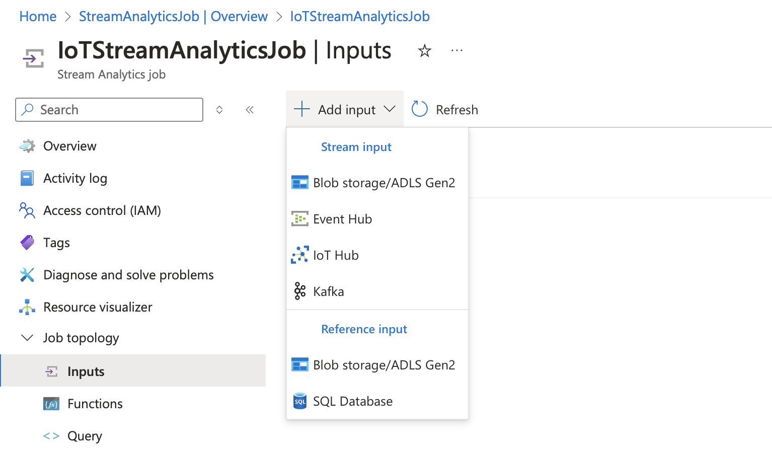

After successfully creating the Stream Analytics job, you will need to configure your Azure IoT Hub as an input source. This configuration allows Stream Analytics to read real-time telemetry data directly from your IoT devices. Follow these steps:
1. Navigate to your newly created Stream Analytics job in the Azure Portal.
2. On the left-hand menu, under the **Job topology** section, select **Inputs**.
3. Click **Add input**, and choose **IoT Hub** as the input type.
   ![Azure Stream Analytics job Inputs page with the Add input menu open and IoT Hub listed as a stream input source.](https://learn.arm.com/learning-paths/embedded-and-microcontrollers/azure-iot/figures/11.png)

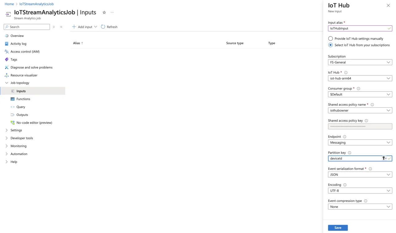

4. Enter the following configuration details:
   - **Input Alias**: provide a name, such as `IoTHubInput`.
   - **IoT Hub**: select the Azure IoT Hub you created earlier.
   - **Consumer group**: choose `$Default`, unless you have explicitly created a custom consumer group.
   - **Shared access policy name**: select `iothubowner` (which provides full access for reading data from IoT Hub).
   - **Endpoint**: select Messaging.
   - **Partition key**: Type `deviceId` (this helps ensure the data streams are partitioned by device identifiers).
   - **Event serialization format**: select `JSON`, as our telemetry data is transmitted in `JSON` format.
   - **Encoding**: Choose **UTF-8**.
   - **Event compression type**: Set this to None.
   ![Azure Stream Analytics IoT Hub input form with alias IoTHubInput, an IoT Hub and consumer group selected, deviceId as the partition key, and JSON with UTF-8 encoding.](https://learn.arm.com/learning-paths/embedded-and-microcontrollers/azure-iot/figures/12.webp)
5. After entering these details, carefully verify them for accuracy and completeness. Click **Save** to apply the changes and successfully link your Azure IoT Hub as the input source for your Stream Analytics job.

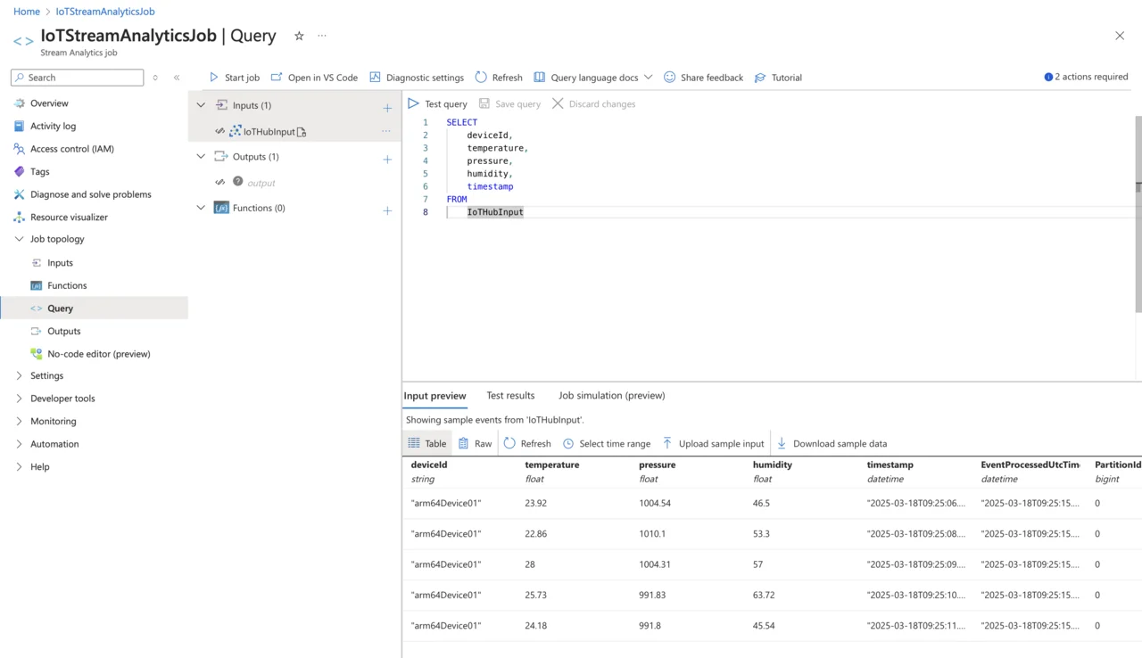

Now that you have configured your Azure IoT Hub as an input source, the next step is to create and run a Stream Analytics query. This query defines how incoming IoT data will be filtered, transformed, or routed for further processing. Follow these steps:
1. Navigate to your Stream Analytics job in the Azure Portal.
2. Under the Job topology menu on the left, select **Query**.
3. In the query editor, enter the following simple `SQL-like` query to stream all incoming data from your IoT device:

This straightforward query selects all relevant fields (deviceId, temperature, pressure, humidity, and timestamp) directly from your configured input (IoTHubInput), which corresponds to the Azure IoT Hub you previously connected.
Before running this query, ensure your Python IoT simulator `iot_simulator.py` is actively sending telemetry data. After the simulator begins transmitting data, you can test and verify your Stream Analytics query within the Azure Portal using the built-in Test query feature. Doing this allows you to view live-streamed sensor data in real-time and confirm that your streaming pipeline is working as expected:
![Azure Stream Analytics Query page showing a query that selects device ID, temperature, pressure, humidity, and timestamp from IoTHubInput, with sample sensor readings in the input preview below.](https://learn.arm.com/learning-paths/embedded-and-microcontrollers/azure-iot/figures/13.webp)
Constructing queries in Azure Stream Analytics involves using a straightforward SQL-like syntax specifically optimized for real-time stream processing. Typically, a query contains a `SELECT` statement to specify which fields from the incoming telemetry data to process, and a `FROM` statement to indicate the source stream. Queries can be expanded with advanced features such as filtering, aggregations, and temporal window functions to handle more complex scenarios.
In the current example, you implemented a simple query using `SELECT` and `FROM` clauses to view and forward all incoming sensor data from our IoT device without any additional filtering or transformation. This straightforward query effectively demonstrates how Azure Stream Analytics ingests and processes real-time IoT data, establishing a foundation upon which you can build more advanced and powerful data analytics workflows in the future.
