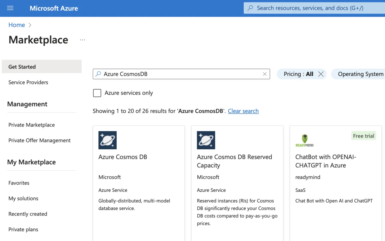

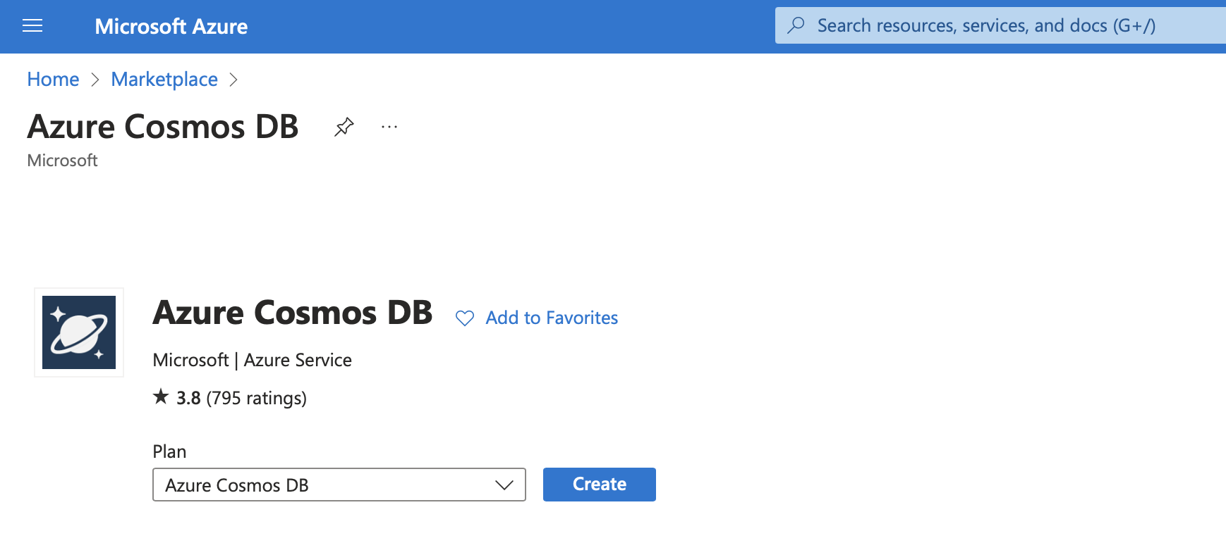

  2. Select Create a resource, search for “Azure Cosmos DB”, and click Create: Image Alt Text:Azure Marketplace search results for Azure Cosmos DB, with the Microsoft Azure Cosmos DB tile visible for selection. Image Alt Text:Azure Marketplace Azure Cosmos DB product page with the Azure Cosmos DB plan selected and the Create button available.

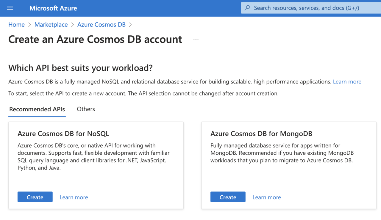

  3. Select Azure Cosmos DB for NoSQL, then click Create. Image Alt Text:Azure Cosmos DB account creation page offering API choices, with the Create button under Azure Cosmos DB for NoSQL.

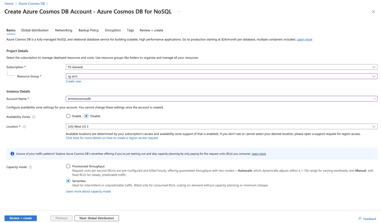

  4. Fill in the required details:
  • Subscription: select your subscription.
  • Resource Group: use your existing IoT resource group or create a new one.
  • Account Name: provide a unique name (for example, armiotcosmosdb).
  • Availability Zones: disable.
  • Region: choose the same region as your IoT Hub and Stream Analytics job.
  • Select serverless as capacity mode.
  • Apply Free Tier Discount: apply
  • Check Limit total account throughput. Image Alt Text:Azure Cosmos DB for NoSQL account Basics form with a resource group and account name entered, availability zones disabled, and Serverless selected as the capacity mode.
  1. Click Review + create, then click Create.

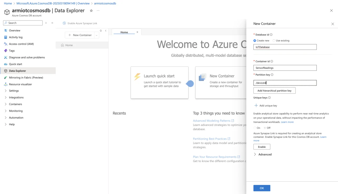

  • Navigate to your Cosmos DB account and select Data Explorer.
  • Click New Container, then create a database with a name such as “IoTDatabase”, and create a container named “SensorReadings”.
  • Select an appropriate partition key (recommended: /deviceId).
  • Enable analytical store capability to perform near real-time analytics on your operational data, without impacting the performance of transactional workloads: Off.
  • Click OK. Image Alt Text:Azure Cosmos DB Data Explorer New Container pane with a new IoTDatabase database, SensorReadings container, and /deviceId partition key entered.

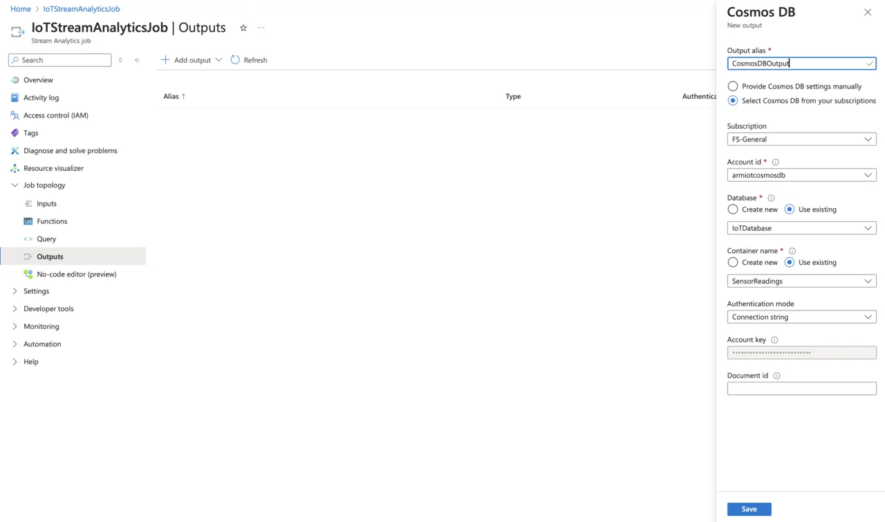

  3. Click Add output, and select Cosmos DB: Image Alt Text:Azure Stream Analytics job Outputs page with the Add output menu open and Cosmos DB available as an output destination.
  4. In the Cosmos DB pane, type “CosmosDBOutput” for the alias name, leave other fields at their default values, and click the Save button: Image Alt Text:Azure Stream Analytics Cosmos DB output form with alias CosmosDBOutput and the existing Cosmos DB account, IoTDatabase database, and SensorReadings container selected.

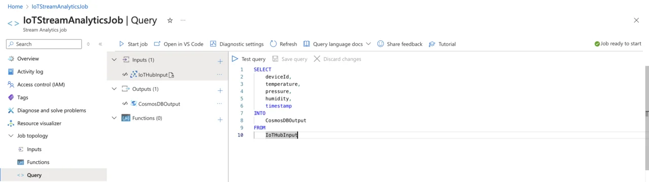

Update Your Stream Analytics Query
Now that you have the output configured, lets modify the query. To do so, select Query under Job topology. Then, modify your existing query to explicitly specify your Cosmos DB output alias:
SELECT
    deviceId,
    temperature,
    pressure,
    humidity,
    timestamp
INTO
    CosmosDBOutput
FROM
    IoTHubInput
Image Alt Text:Azure Stream Analytics Query page showing IoT Hub sensor fields selected INTO CosmosDBOutput FROM IoTHubInput, so incoming telemetry is written to Cosmos DB.
