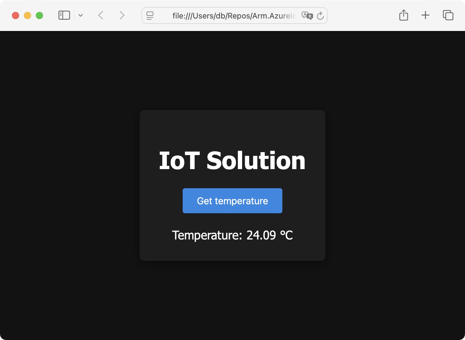

Testing the Implementation:
Make sure you have saved all three files (index.html, main.js, and styles.css). Next:
  1. Start the IoT Simulator to begin streaming data to the Azure IoT Hub.
  2. Open the index.html file locally in your web browser.
  3. Click the Get temperature button.
You should now see real-time temperature readings displayed:
Image Alt Text:Locally opened IoT Solution web page with the Get temperature button and a returned temperature reading of 24.09 degrees Celsius.

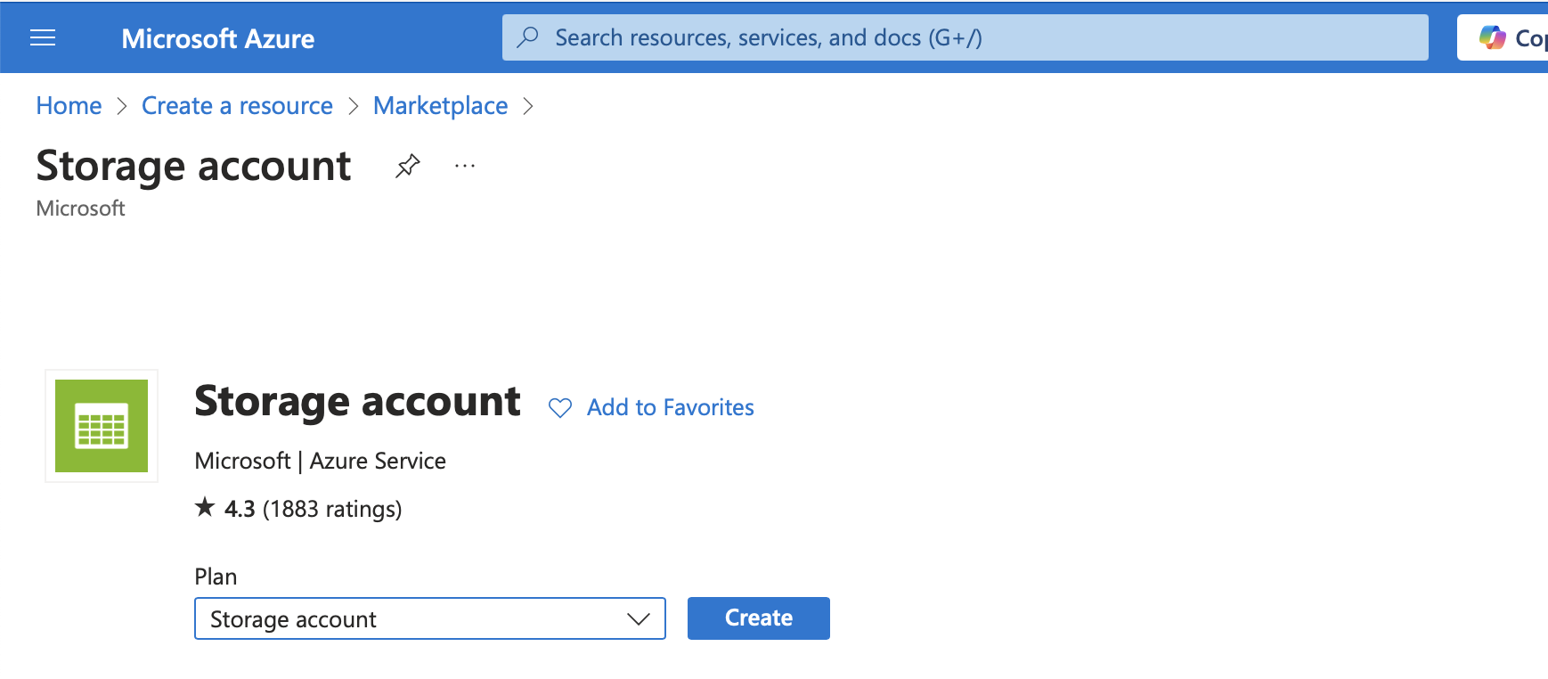

  2. Create a Storage Account:
  • Click Create a resource.
  • Search for “Storage account”. Image Alt Text:Azure Marketplace search results for storage account, with the Microsoft Storage account tile among the results.
  • Click Create. Image Alt Text:Azure Marketplace Storage account product page with its plan selected and the Create button available.

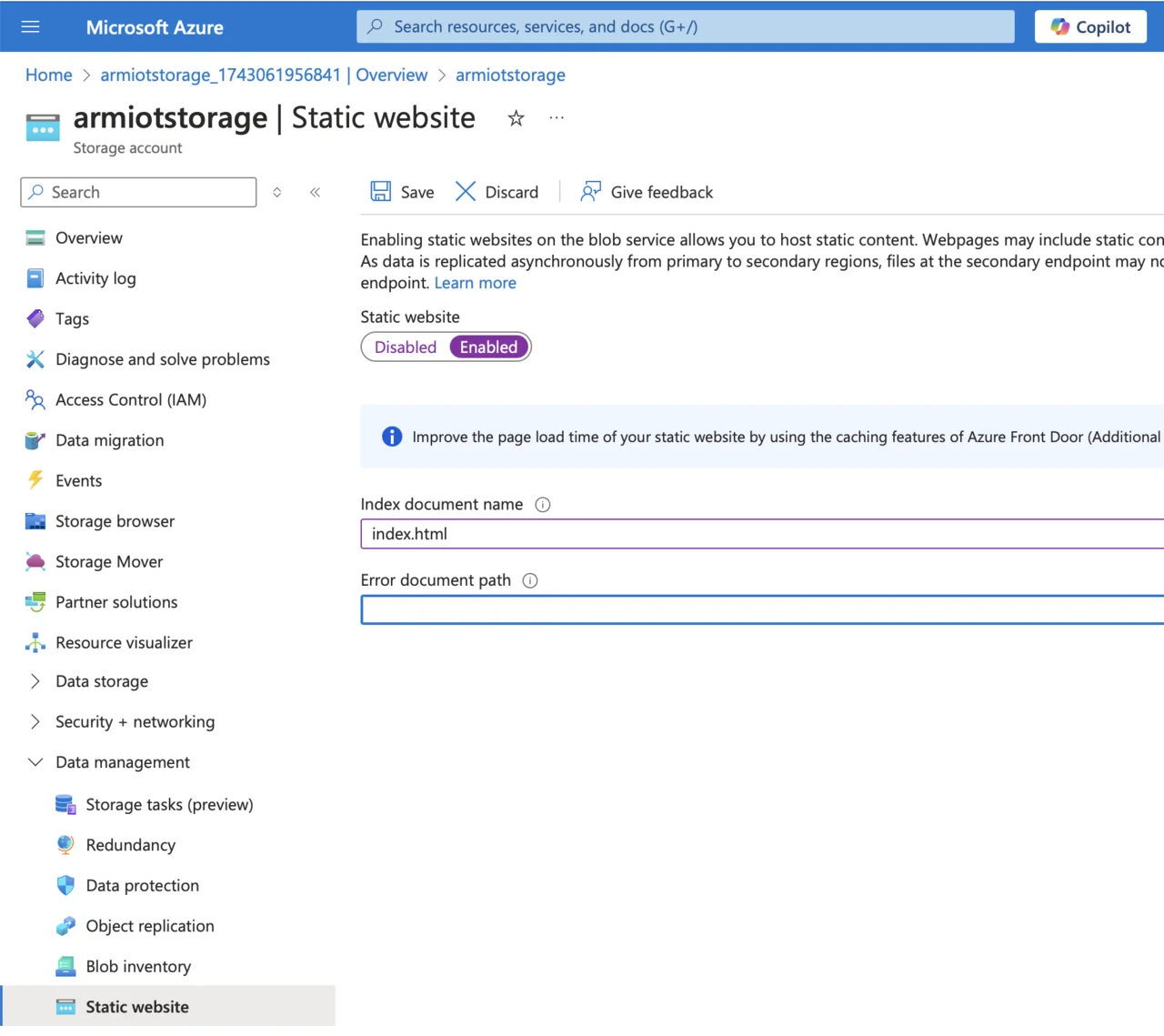

  1. Enable Static Website Hosting:
  • Navigate to your newly created storage account.
  • Under Data management, click Static website.
  • Select Enabled.
  • Set index.html as the index document name. Image Alt Text:Azure Storage account Static website settings with Enabled selected and index.html entered as the index document name.
  • Click Save.
After saving, Azure provides you with a URL like: https://.z22.web.core.windows.net/. Save this URL, as it will serve as the public endpoint for your website.

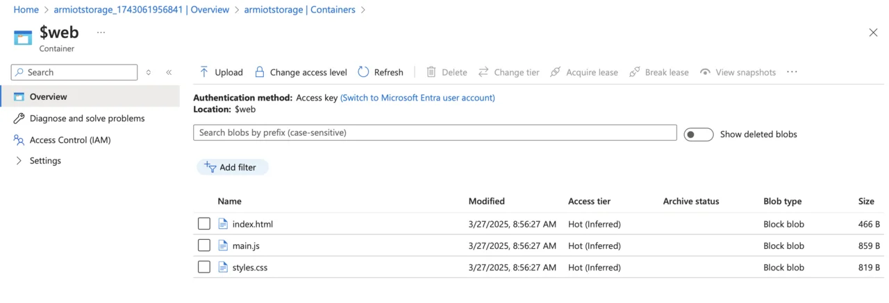

Upload Files to Azure Blob Storage
You can upload your website files directly using the Azure Portal or via Azure Storage Explorer. Here, use the Azure Portal:
  1. Navigate to your storage account.
  2. Under Data storage, select Containers.
  3. Open the container named ”$web” (created automatically when enabling static websites).
  4. Click Upload and select your three website files (index.html, main.js, styles.css), and upload them.
Image Alt Text:Azure Storage $web container listing the uploaded index.html, main.js, and styles.css files for the IoT web portal.

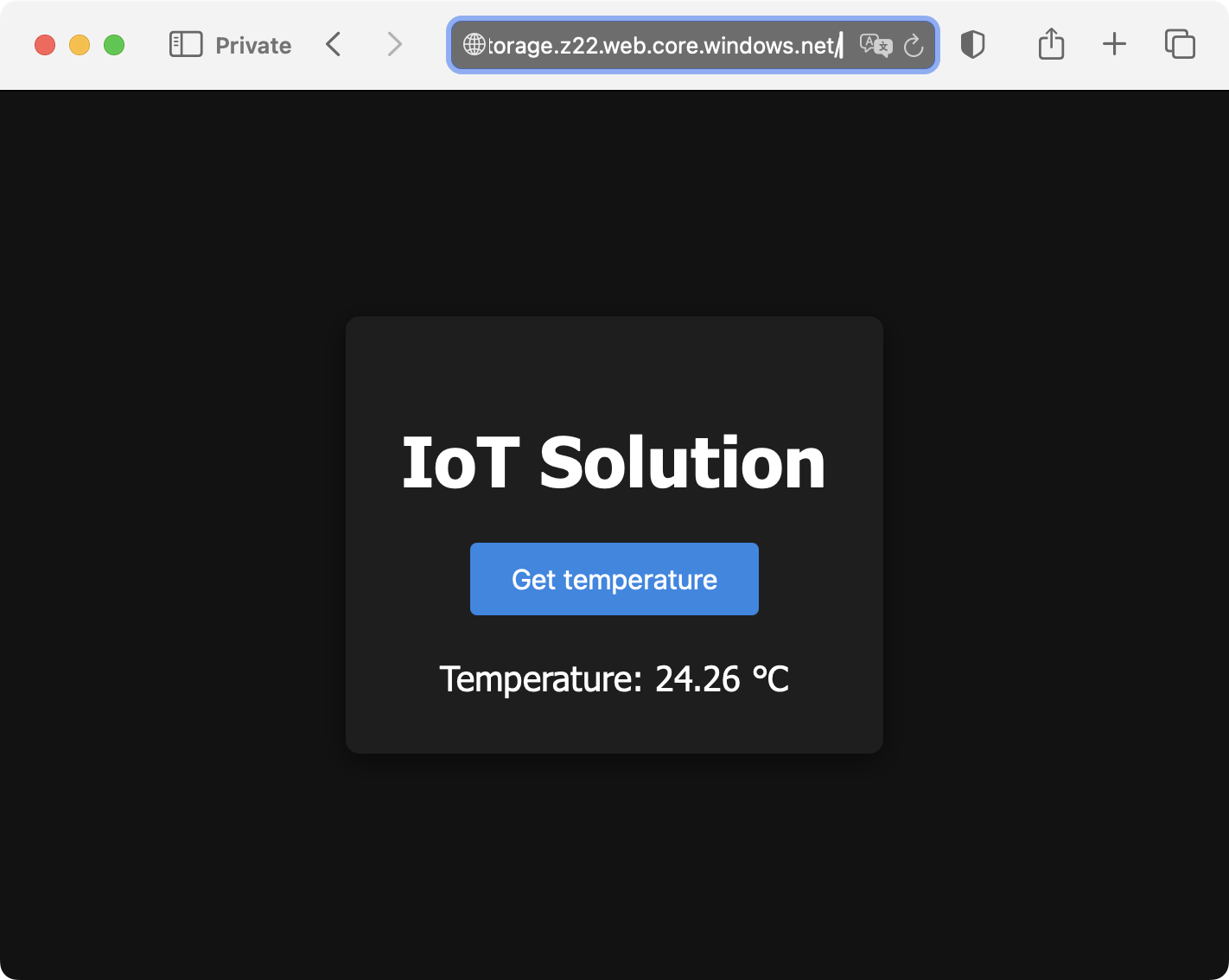

Verify the Deployment
After uploading your files, open a browser and navigate to https://.z22.web.core.windows.net/.
Your static website should load, allowing you to test the Get temperature button (to see temperatures make sure to start the IoT simulator):
Image Alt Text:Deployed IoT Solution web page at an Azure Storage static website address, with the Get temperature button and a returned reading of 24.26 degrees Celsius.
