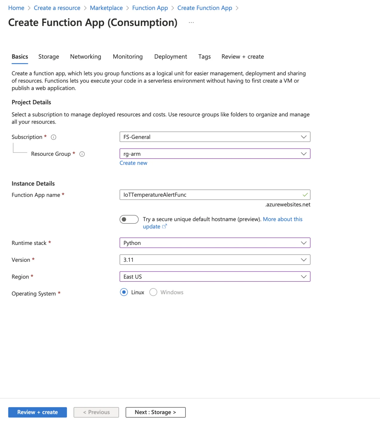

  2. Click Create a resource, type “Function App”, and select it: Image Alt Text:Azure Marketplace search results for Function App, with the Microsoft Function App tile and its Create menu visible.

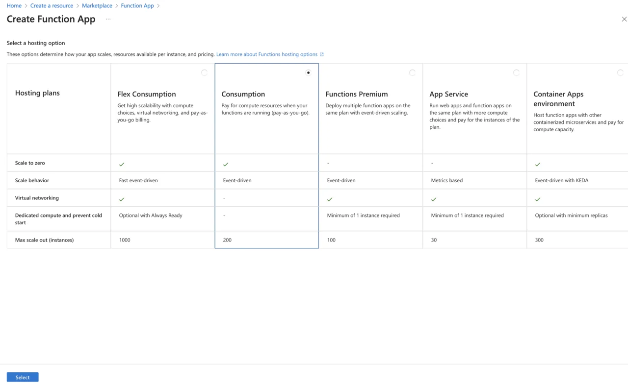

  3. Click Create, then select Consumption as a hosting option: Image Alt Text:Azure Create Function App hosting options with the Consumption plan selected and the Select button available to continue.
  4. Provide the required details:
  • Subscription: Your Azure subscription.
  • Resource Group: Select your existing IoT resource group.
  • Function App Name: Provide a unique name (e.g., IoTTemperatureAlertFunc).
  • Runtime Stack: Select Python.
  • Version: Select 3.11
  • Region: Select the same region as your Cosmos DB and IoT Hub.
  • Operating System: Select Linux as Windows is unavailable for Python.
  1. Click Review + Create, and then Create.
Image Alt Text:Azure Create Function App Basics form with a resource group and function app name entered, Python 3.11 selected as the runtime, and Linux selected as the operating system.

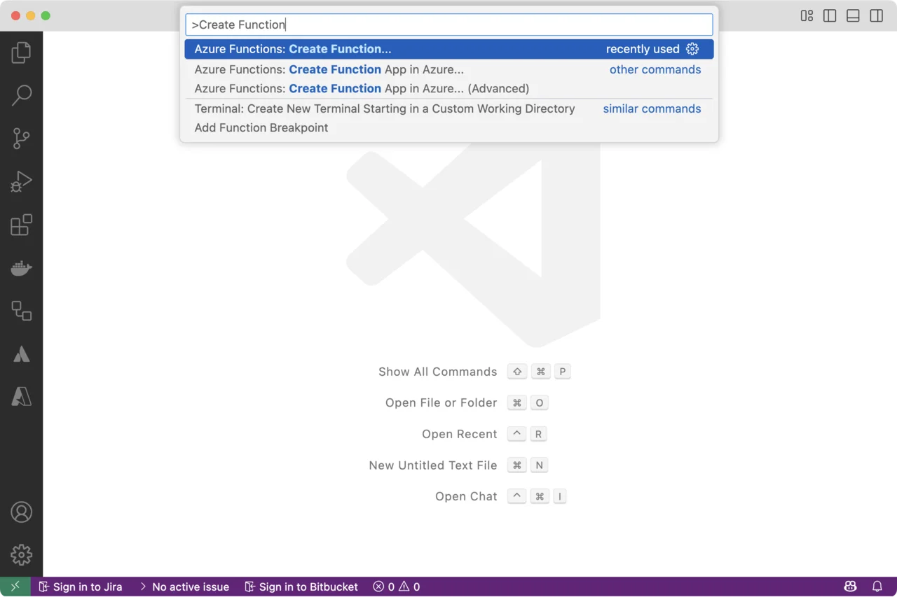

  1. In Visual Studio Code, click View->Command Palette…
  2. Type “Create Function”: Image Alt Text:Visual Studio Code Command Palette showing Azure Functions: Create Function as the selected command.
  3. Select Azure Functions: Create Function…

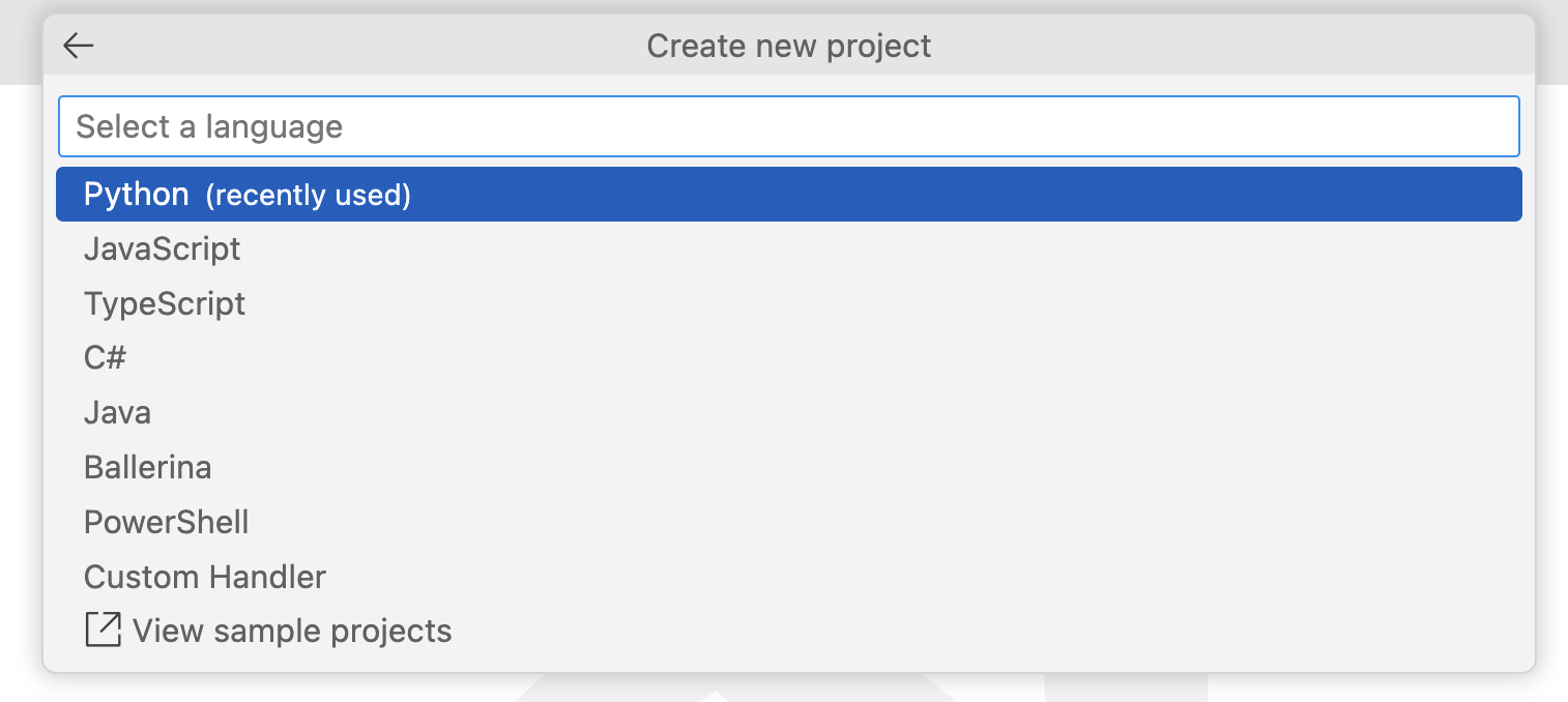

  5. Visual Studio Code will display the wizard, which enables you to configure your function: Image Alt Text:Visual Studio Code Create new project wizard at the language selection step, with Python highlighted for the Azure Function project.
  6. Use this wizard to configure the function:
  • Select a language: Select Python
  • Select a Python programming model: Model V2 (Recommended)

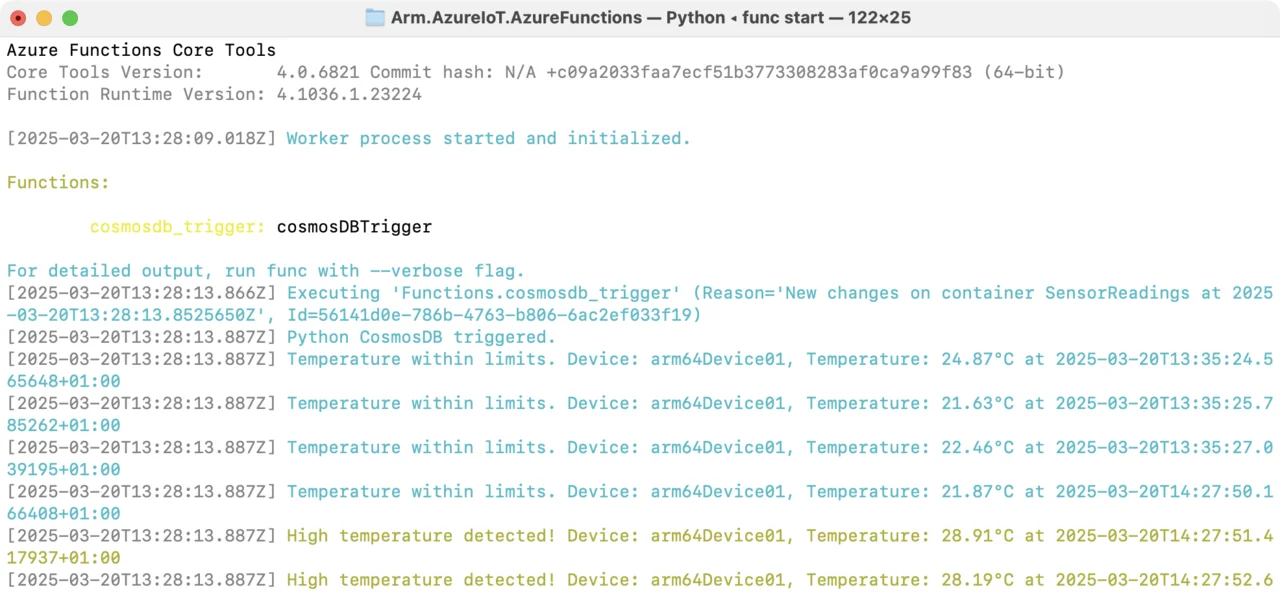

To run your function locally proceed as follows:
  1. In the Terminal navigate to the folder, in which you saved the function (here that is Arm.AzureIoT.AzureFunctions).
  2. Type the following command:
func start
  1. Run the iot_simulator.py in a separate terminal window.
You should then see the following logs, depending on the generated temperature values:
Image Alt Text:Azure Functions Core Tools terminal output showing the Cosmos DB trigger running for new sensor readings. Normal temperatures are logged as within limits, while readings above 28 degrees Celsius are flagged as high.

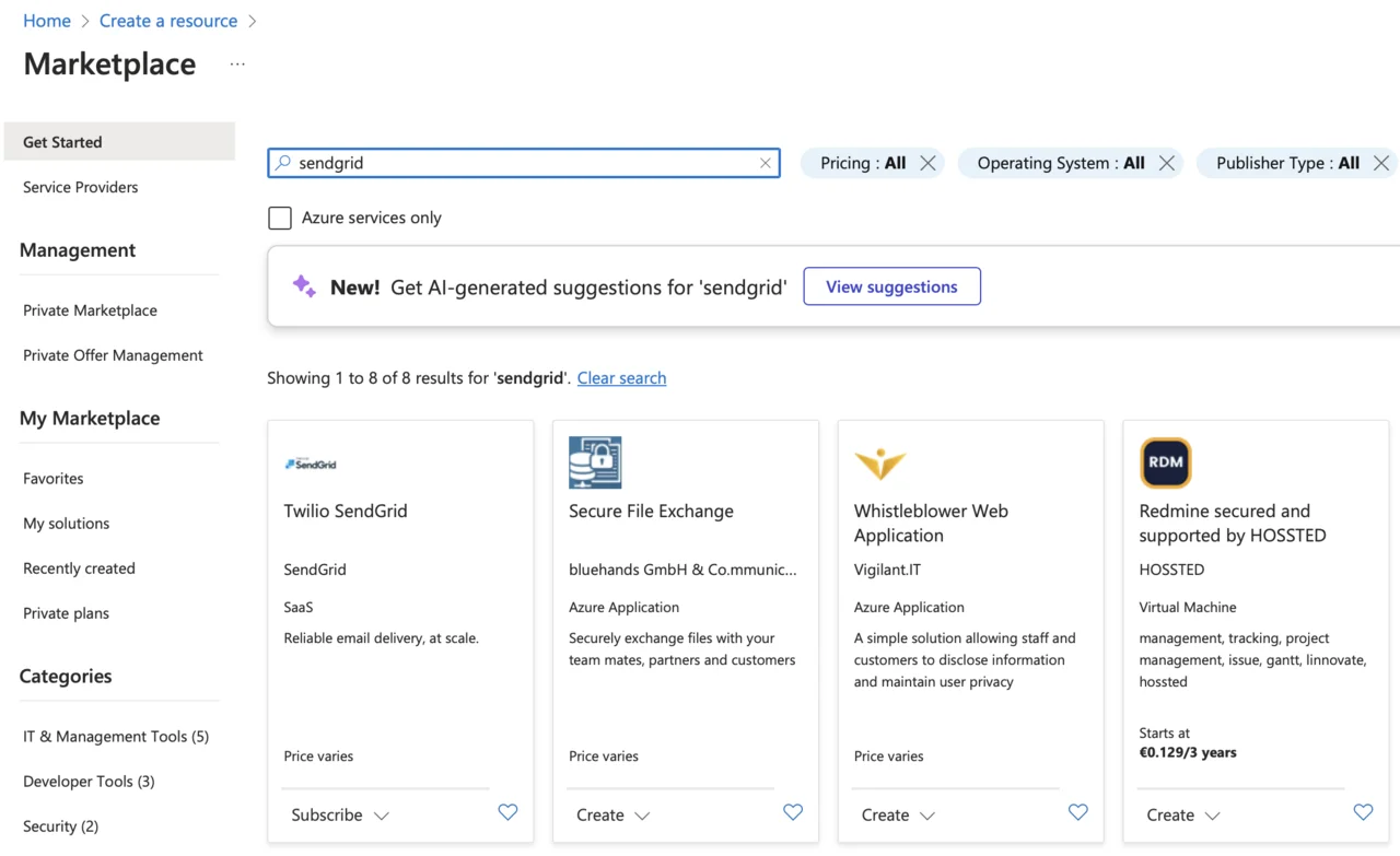

Create a SendGrid Account in Azure
Follow these steps to create a SendGrid account:
  1. Sign in to the Azure Portal.
  2. Click “Create a resource” and search for SendGrid. Image Alt Text:Azure Marketplace search results for SendGrid, with the Twilio SendGrid tile and its Subscribe menu visible.

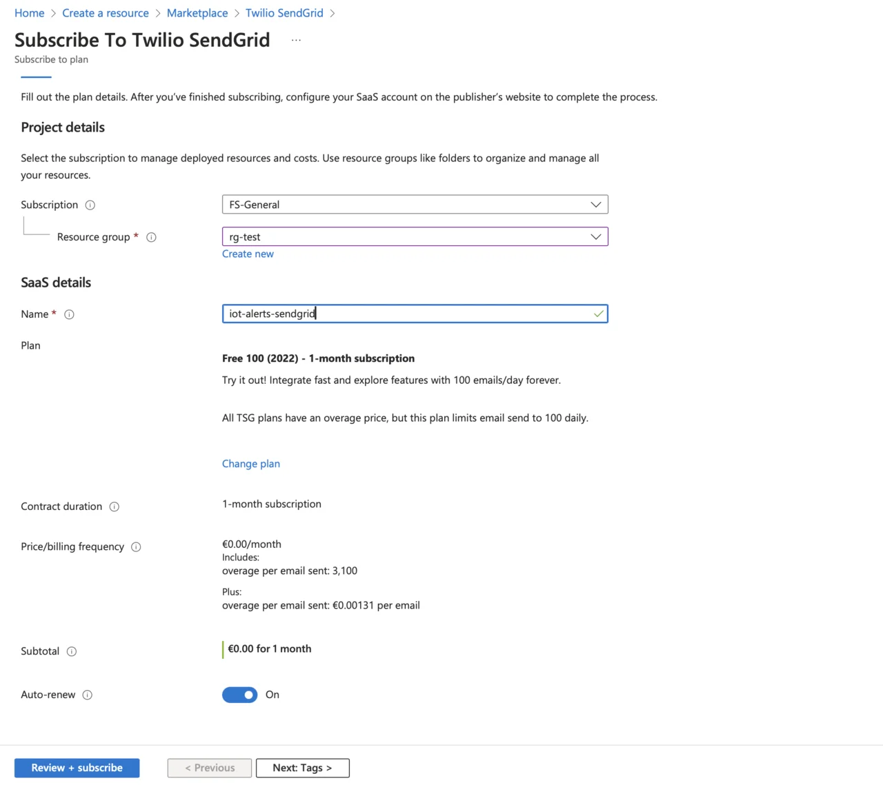

  3. Select Twilio SendGrid, choose the Free 100 (2022) plan, and then click Subscribe.
  4. Provide the following details:
  • Subscription: Select your Azure subscription.
  • Resource group: Choose your existing IoT project resource group.
  • Name: Enter a descriptive name (e.g., iot-alerts-sendgrid). Image Alt Text:Azure Twilio SendGrid subscription form showing the resource group, an example account name, and the Free 100 plan before review and subscription.

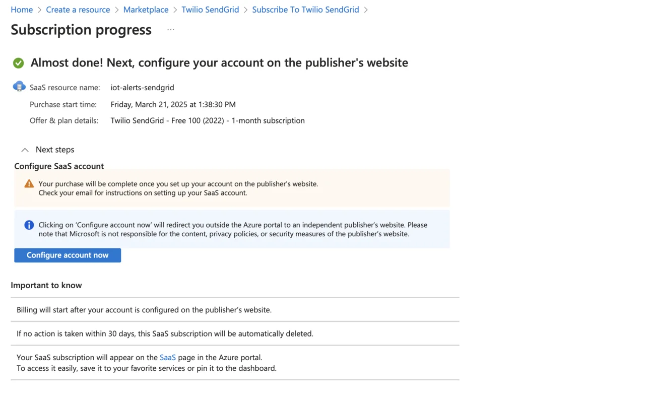

  1. Click Review + subscribe and then Subscribe.
  2. On the next screen, click Configure account now: Image Alt Text:Azure Twilio SendGrid subscription progress page prompting the user to finish setup on the publisher’s website with the Configure account now button.

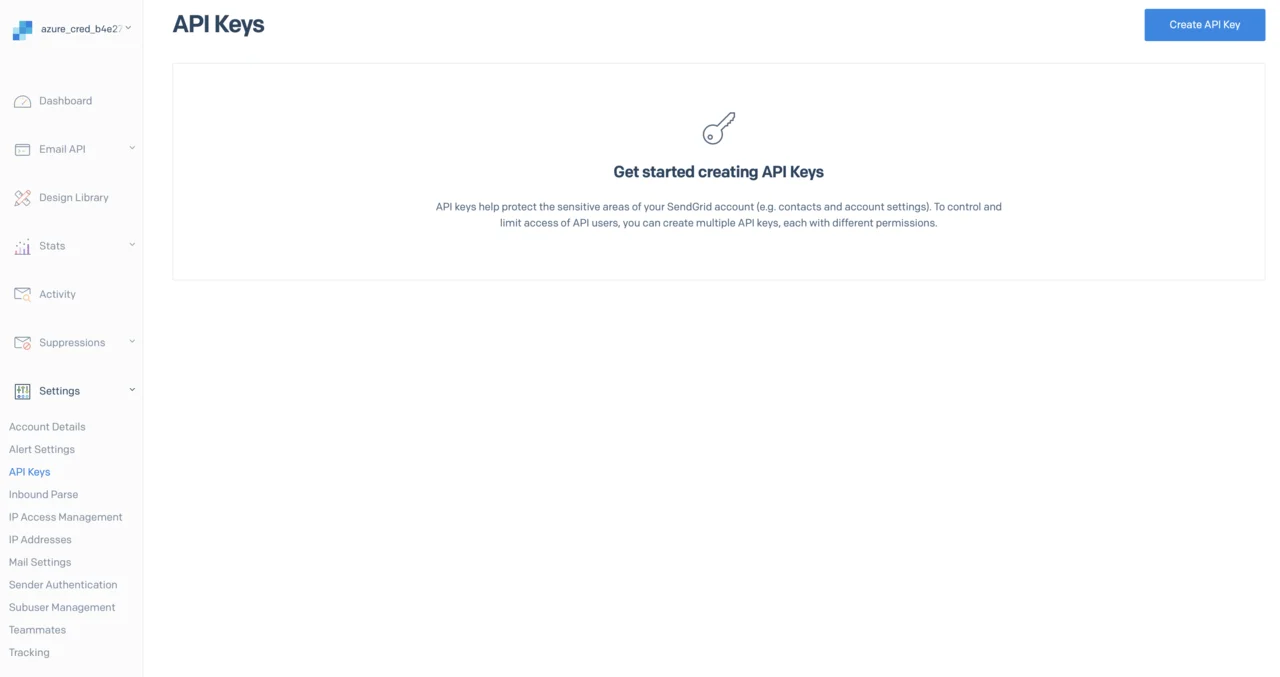

  5. After the sender identity is verified, click API Keys in the left menu: Image Alt Text:SendGrid API Keys page with API Keys selected under Settings and the Create API Key button in the upper right.
  6. Click Create API Key. In the popup window, enter a key name (e.g., iot-api-key), and select Full Access. Image Alt Text:SendGrid Create API Key form with an example key name entered, Full Access selected, and the Create and View button ready to generate the key.
  7. Copy the generated API key securely. You will not be able to retrieve it later.

Now, start your function:
func start
Then run the iot_simulator.py to send telemetry data, and wait for alert notifications.
You have now successfully configured real-time monitoring with email notifications. You can proceed to enhance your IoT solution by aggregating data and creating dashboards or visualizations.
