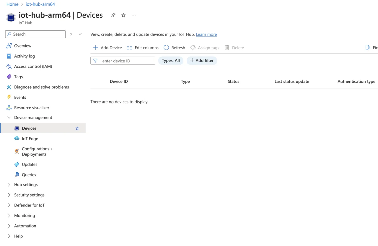

1. Register a Device on Azure IoT Hub:
   - Open the Azure Portal, go to your IoT Hub, and click **Devices** under **Device management**:

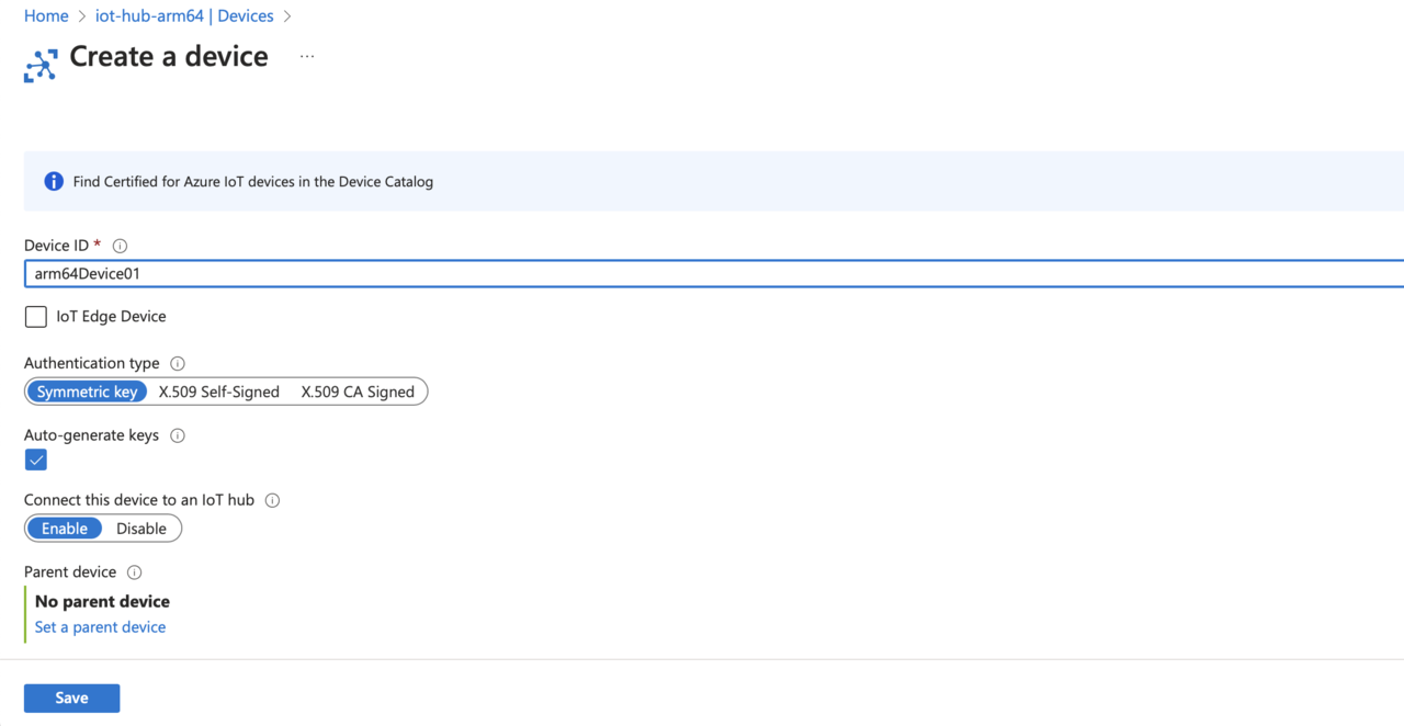

   - Click **Add Device**, enter a device ID (for example, “arm64Device01”), and leave the authentication type as **Symmetric key**:
   ![Image Alt Text:img7 alt-text](https://learn.arm.com/learning-paths/embedded-and-microcontrollers/azure-iot/figures/07.webp)
   - Click **Save**.

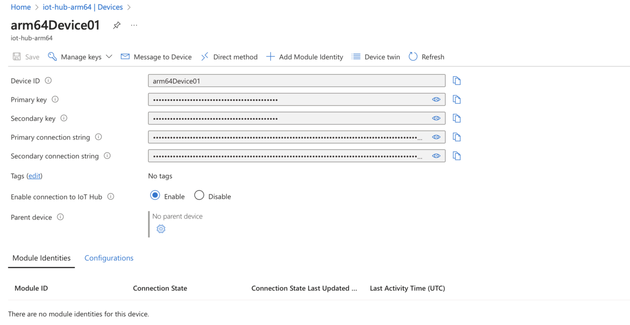

2. Next, you’ll need to retrieve the connection string to integrate your Python application with Azure IoT Hub.
   - From the device list, select your newly-created device, “arm64Device01”.
   - Copy the **Primary connection string** from the device details page. You’ll need this connection string to authenticate your Python application when connecting and streaming telemetry data.
   ![Image Alt Text:img8 alt-text](https://learn.arm.com/learning-paths/embedded-and-microcontrollers/azure-iot/figures/08.webp)
Ensure this connection string is stored securely, as it provides authentication credentials for your device.
