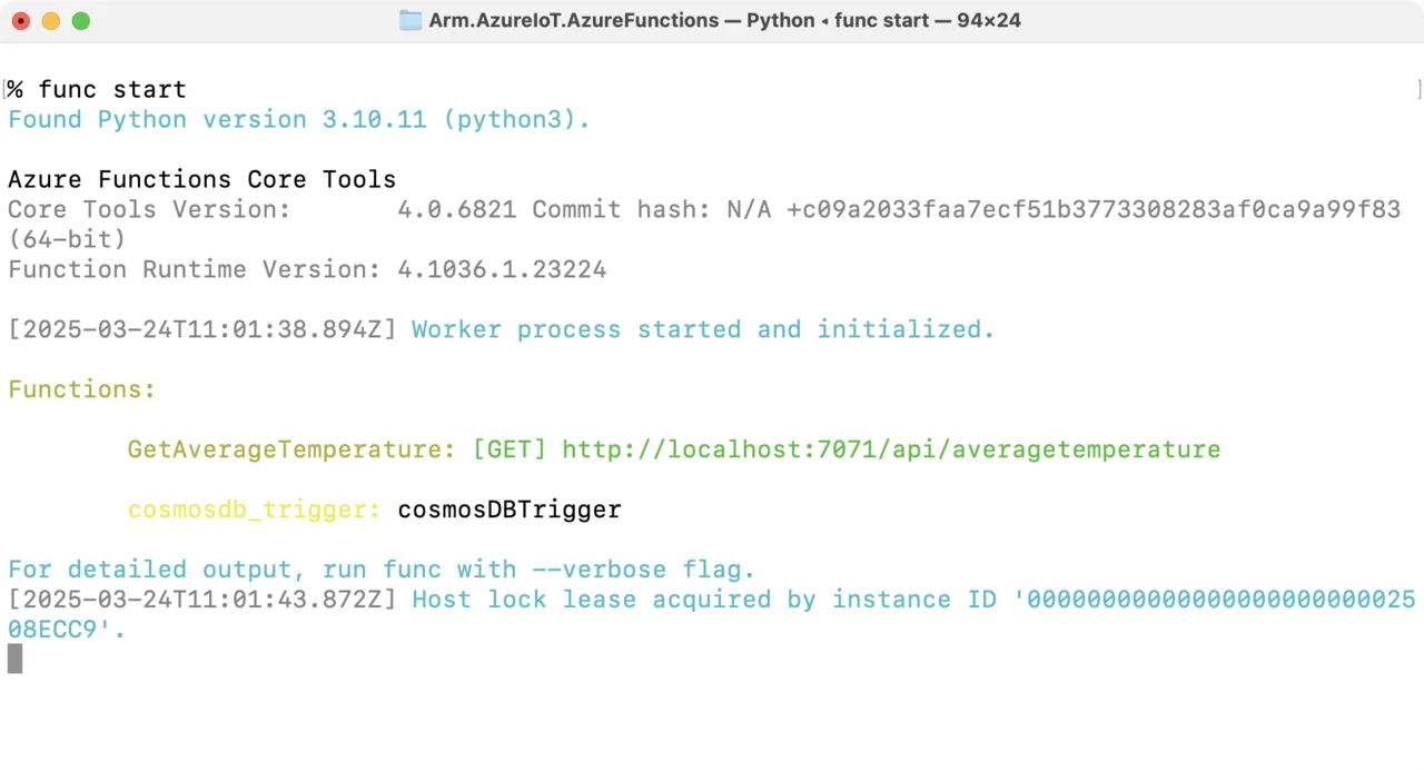

You are now ready to launch the function. Run the following command:
func start
Once running, observe the HTTP trigger endpoint, which should appear similar to the following: Image Alt Text:Terminal output from func start showing GetAverageTemperature running at a local HTTP endpoint, confirming the Azure Function is ready for a browser request.

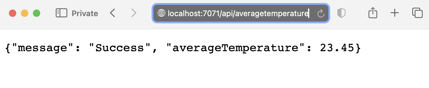

Next, start the simulator to stream sensor data and open the HTTP trigger endpoint URL in your web browser. You will see the calculated average temperature displayed: Image Alt Text:Browser response from the local average temperature endpoint showing a Success message and an averageTemperature value of 23.45.

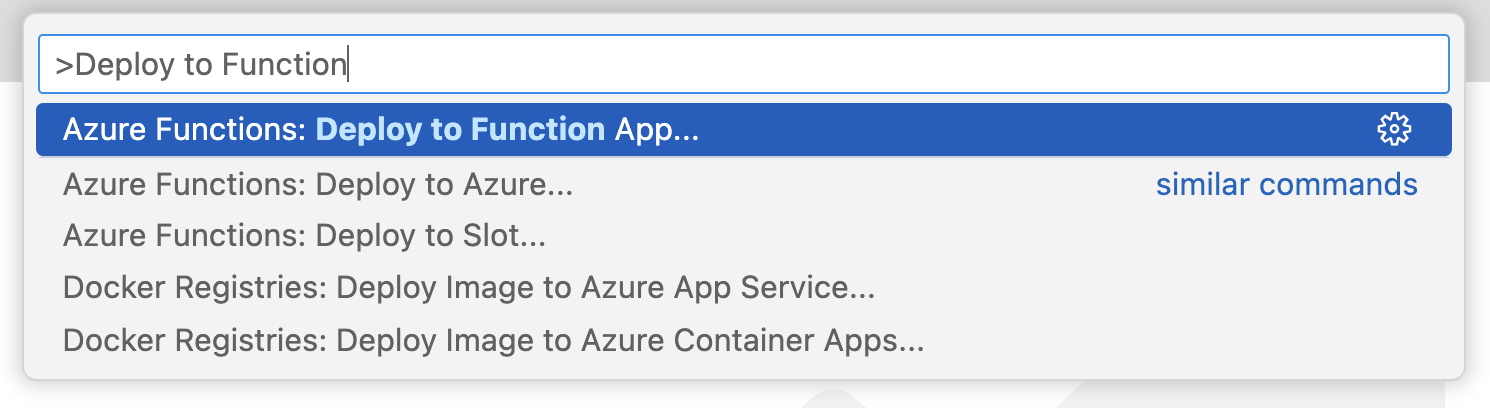

  1. In Visual Studio Code, open the Command Palette (Ctrl+Shift+P on Windows/Linux, or Cmd+Shift+P on macOS) and search for “Azure Functions: Deploy to Function App”: Image Alt Text:Visual Studio Code Command Palette with Azure Functions: Deploy to Function App selected to publish the local function.

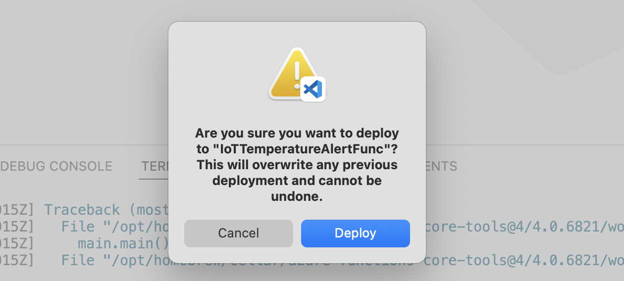

  • Select a function app: Select the Function App that you previously created in Azure (in this example, “IoTTemperatureAlertFunc”)
  • Confirm your deployment: Image Alt Text:Visual Studio Code deployment confirmation warning that publishing to IoTTemperatureAlertFunc will overwrite its previous deployment, with Deploy available to continue.
  1. Wait for the deployment to complete. This process typically takes a few moments. Once deployed, your Azure Function is hosted in Azure and ready for use.

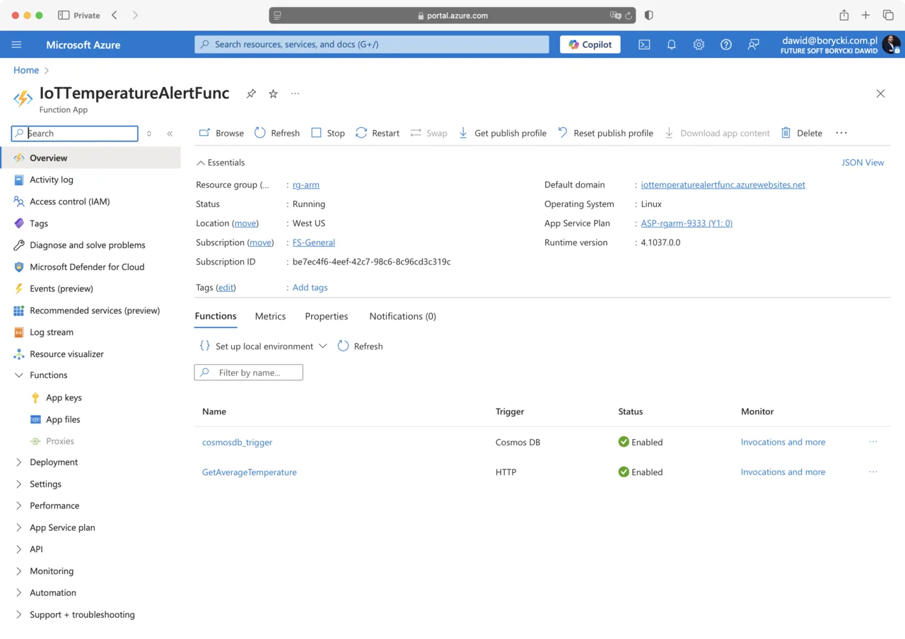

  2. Open the Azure Portal, and go to your function app (in this example, “IoTTemperatureAlertFunc”). You will see the deployed functions: Image Alt Text:Azure Function App overview showing both cosmosdb_trigger and GetAverageTemperature listed as enabled functions after deployment.

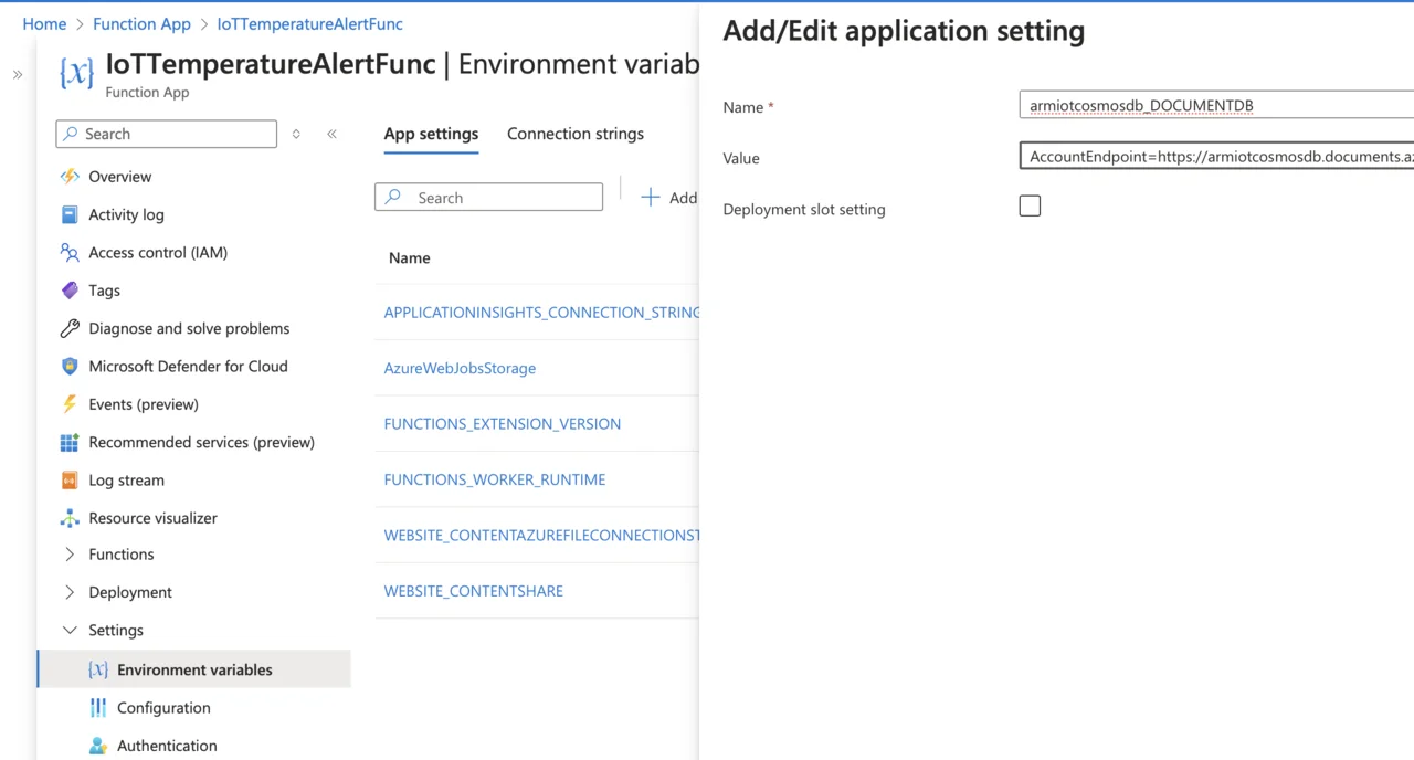

You have just deployed the functions to Azure. Previously, when testing the functions locally, you used the local.settings.json file to store the Cosmos DB connection string. However, this local configuration file is not deployed to Azure. Therefore, you need to update the corresponding settings directly within the Azure portal.
Azure Function App settings, which are also known as application settings or environment variables, are designed to securely store sensitive configuration information, such as database connection strings, API keys, and other confidential details. Storing the Cosmos DB connection string as an app setting in Azure ensures secure management of your database credentials, allowing your function to safely access Cosmos DB without exposing sensitive information within your source code.
Follow these steps to configure the Cosmos DB connection string
  1. In the Azure Portal navigate to Azure Function App.
  2. Click Environmental variables (under Settings).
  3. Click the + Add button.
  4. Enter the name you used in your code (such as “armiotcosmosdb_DOCUMENTDB”).
  5. Paste the Cosmos DB connection string into the Value field: Image Alt Text:Azure Function App Environment variables page with the Add/Edit application setting pane open for the Cosmos DB connection string name and value.
  6. Click Apply to add the setting.
  7. Click Apply at the bottom to apply changes. Then, confirm to save changes

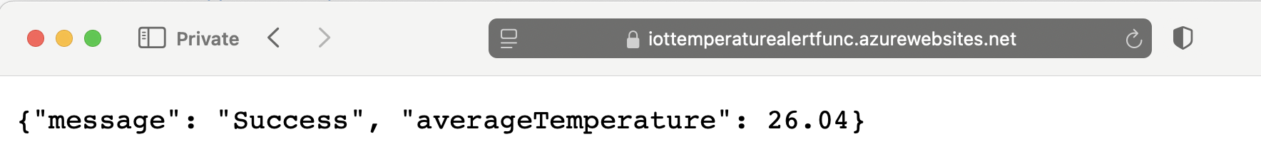

  4. Open this URL in your web browser.
  5. Start your IoT simulator to begin streaming telemetry data to Cosmos DB.
  6. Refresh or access the function URL again, and you should see the calculated average temperature displayed: Image Alt Text:Browser response from the deployed GetAverageTemperature endpoint showing a Success message and an averageTemperature value of 26.04.
This confirms your Azure Function successfully connects to Cosmos DB, retrieves real-time data, and calculates the average temperature as intended
