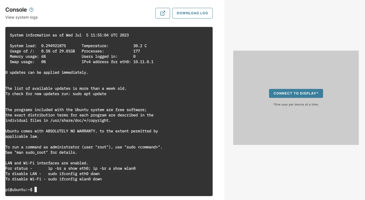

Wait for the device to be created.
![AVH console showing device status message indicating the Raspberry Pi 4 virtual device is ready with Ubuntu Server boot logs displayed#center](device_ready.webp “Device ready"us message indicating the Raspberry Pi 4 virtual device is ready with Ubuntu Server boot logs displayed#center](device_ready.webp “Device ready”)
When it’s ready, log in with the default username pi and password raspberry.
You’re now ready to install AWS IoT Greengrass Core on your virtual Raspberry Pi.
