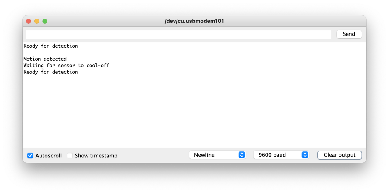

You can further check that your code is running properly by opening the Serial Monitor from the Tools menu of the Arduino IDE. There you should see all of the output messages, including count of detected motion events, coming from your sketch.
Image Alt Text:Screenshot of the Arduino IDE Serial Monitor window displaying debug messages from the motion detection sketch. The output shows repeated “Motion detected” messages followed by motion event counts, confirming that the PIR sensor is triggering correctly and the sketch is processing the interrupts.
