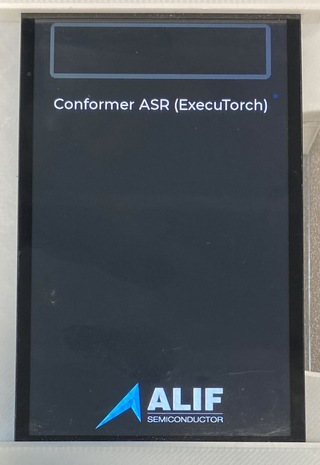

If the port was open before you changed SW4, close and reopen it. Press and release RESET (SW1). The UART startup log should report Model initialisation complete. Wait for the display to show Conformer ASR (ExecuTorch) before testing audio.
Image Alt Text:E8 display showing Conformer ASR (ExecuTorch) with an empty spectrogram, ready for speech capture.Conformer ASR ready to record

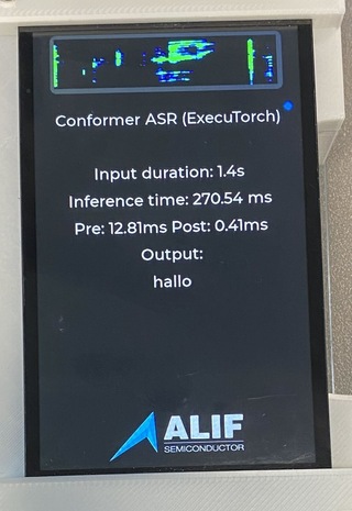

  4. Wait for the transcription to appear on the display and a Decoded output: line to appear in the console.
The display also shows the spectrogram, input duration, and processing times. Compare the text with what you said and record any errors. Repeat with a different phrase to check that another recording works.
Image Alt Text:E8 display showing a speech spectrogram, processing times, and the transcription hallo after a recording.Example transcription after releasing the joystick

INFO - Decoded output: this is a inch testif
The decoded words are the actual output of that run. Completed inference and nonzero counters verify execution but don’t establish transcription accuracy.

Spoken phrase“this is a speech test”
LCD and UART transcription“this is a inch testif”
Input duration shown on LCD2.4 s
Inference time shown on LCD267.31 ms
Preprocessing / postprocessing shown on LCD25.12 ms / 0.53 ms
Earlier spoken phrase / LCD transcription“hello world” / “her low world”
Standalone RESETApplication restarted and completed the second phrase test
The firmware reported a 400 MHz Cortex-M55 HP clock and an Ethos-U85 with 256 MACs per cycle in Shared_Sram mode. It ran bare-metal on the HP core with no debugger attached. OS thread count and CPU affinity don’t apply.
These are measurements from one test session. These values are therefore not pass thresholds or a word-error-rate benchmark. The LCD timings were reported by the operator. The decoded output and NPU counters for the second phrase were captured from UART. Repeated ARM_PDM_EVENT_ERROR messages were also present. Their cause and relationship to the recognition errors weren’t established.
