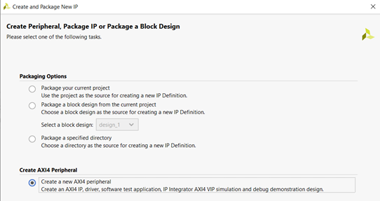

  1. Start by clicking “Tools” -> “Create and Package New IP”. Click “Next” and choose the following option:
    Image Alt Text:Creating AXI4 peripheral
    Figure 2.1. Creating AXI4 peripheral

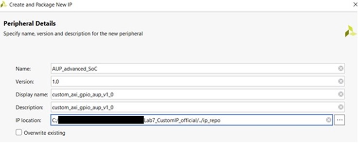

  2. Give the following name to the IP (you may keep the IP location path as provided by default):
    Image Alt Text:Adding peripheral details
    Figure 2.2. Adding peripheral details

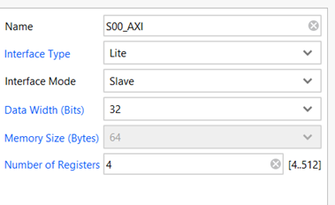

  3. You need a Subordinate interface and four 32-bit registers for the switches and LEDs.
    Image Alt Text:Peripheral settings for Subordinate interface
    Figure 2.3. Peripheral settings for Subordinate interface

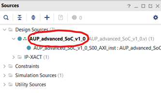

  4. On the last page, choose “Edit IP” and click “Finish”. In the “Sources” window, you will see two Verilog files in Design Sources:
  • A top file, i.e., AUP_advanced_SoC_v1_0.v
  • A filename that ends with “S00_AXI”, i.e., AUP_advanced_SoC_v1_0_S00_AXI.v
These are the basic template files generated for an AXI-Lite peripheral. You can now implement custom GPIO logic by making some changes to these template files.
  1. Double-click to open the top-level Verilog file called “AUP_advanced_SoC_v1_0.v”:
    Image Alt Text:Editing top-level Verilog file
    Figure 2.4. Editing top-level Verilog file

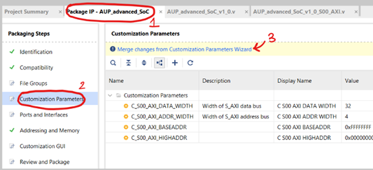

  8. Save the changes in the file (Ctrl+S). Next, go to the “Package IP – AUP_advanced_SoC” tab, choose the “Customization Parameters” option on the left and click “Merge Changes from Customization Parameters Wizard” to update the IP package with the changes made in HDL files:
    Image Alt Text:. Saving all the changes
    Figure 2.6. Saving all the changes

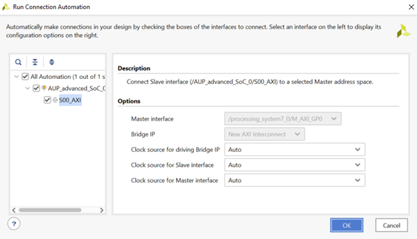

  12. Click the “+” option under “IP Repositories” on the right and choose the AXI4 peripheral folder you created earlier (if it hasn’t already appeared) and click “Ok”. Right-click in the empty space of the “Diagram” box again and choose “Add IP”. Type “custom” in the search box and choose “custom_axi_gpio_asoc_v1_0” from the options.
  13. Click “Run Connection Automation” and then click “OK” to connect the AXI-Lite Subordinate interface on GPIO peripheral to the AXI Manager interface on Arm processor.
    Image Alt Text:Connect AXI-Lite Subordinate interface (Custom IP) to AXI Manager interface
    Figure 2.8. Connect AXI-Lite Subordinate interface (Custom IP) to AXI Manager interface
