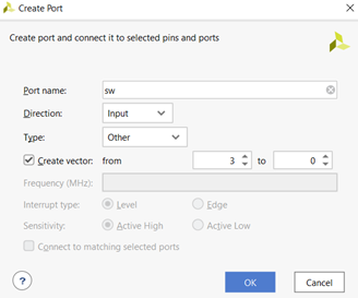

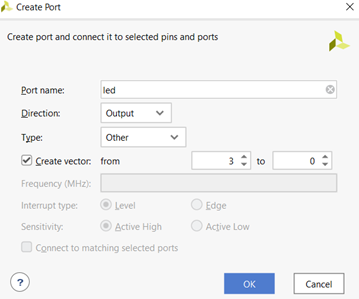

1. Right-click on the empty space again in the diagram and choose “Create Port…” (Ctrl+K). Create 2 ports with the following settings and names:
   ![Screenshot of Vivado Create Port dialog showing settings for creating an led output port with Direction set to Output and Type set to Data, width 4 bits to connect to external LEDs on the Zybo board](https://learn.arm.com/learning-paths/embedded-and-microcontrollers/advanced_soc/images/picture15.png)
   _Figure 3.1. Creating output port_
   ![Screenshot of Vivado Create Port dialog showing settings for creating an sw input port with Direction set to Input and Type set to Data, width 4 bits to read switch states from the Zybo board](https://learn.arm.com/learning-paths/embedded-and-microcontrollers/advanced_soc/images/picture16.png)
   _Figure 3.2. Creating input port_

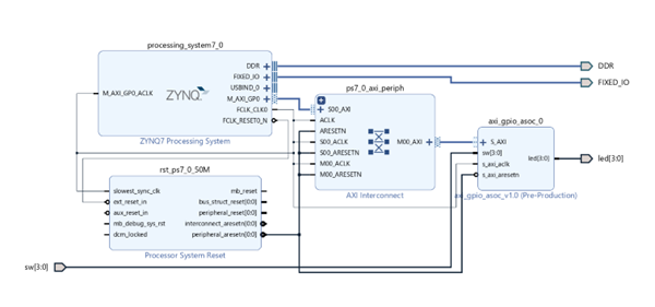

2. Wire the “sw[3:0]” input to the “sw[3:0]” port of the “axi_gpio_asoc_0” block and the same for the “led[3:0]” output to the equivalent port of the block as shown in the diagram below. This connects them to external ports of the ZYNQ chip:
   ![Screenshot of Vivado block design showing the complete system with ZYNQ Processing System, AXI Interconnect, custom GPIO peripheral, and external sw and led ports wired together for switch input and LED output control](https://learn.arm.com/learning-paths/embedded-and-microcontrollers/advanced_soc/images/picture17.png)
   _Figure 3.3. Vivado block diagram_

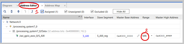

3. Two IP blocks will be generated automatically. The “Processor System Reset” IP is used to generate reset signals for different peripherals. The “AXI Interconnect” IP here is used to interconnect AXI4-Lite Subordinate and AXI Manager. Select the “Address Editor” tab next to “Diagram” and change the “64K” to “4K”. Save all your progress.
   ![Screenshot of Vivado Address Editor tab showing the axi_gpio_asoc_0 peripheral address range field where you change the default 64K allocation to 4K to efficiently use memory address space](https://learn.arm.com/learning-paths/embedded-and-microcontrollers/advanced_soc/images/picture18.png)
   _Figure 3.4. Changing peripheral address settings_

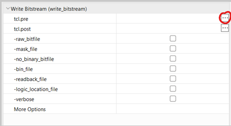

5. Right-click the “Generate Bitstream” option in the “Flow Navigator” on the left and select “Bitstream settings”. Click the three dots next to “tcl.pre”:
   ![Screenshot of Vivado Bitstream Settings dialog showing the tcl.pre field with a browse button where you specify the pins.tcl script to suppress I/O pin warnings during bitstream generation](https://learn.arm.com/learning-paths/embedded-and-microcontrollers/advanced_soc/images/picture19.png)
   _Figure 3.5. Changing bitstream settings_

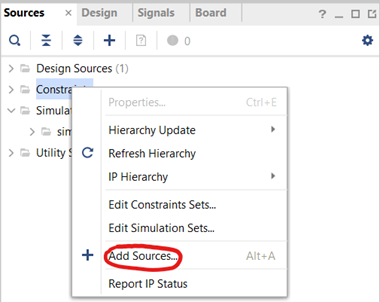

6. Select the “New Script” option, click the three dots next to the empty box, choose the “pins.tcl” file you created earlier and click “Ok” on all windows. Right-click the “Constraints” under the sources tab and select “Add sources”:
   ![Screenshot of Vivado Sources panel showing the right-click context menu on Constraints with Add Sources option highlighted to add physical pin constraint files for the FPGA](https://learn.arm.com/learning-paths/embedded-and-microcontrollers/advanced_soc/images/picture20.png)
   _Figure 3.6. Adding sources_

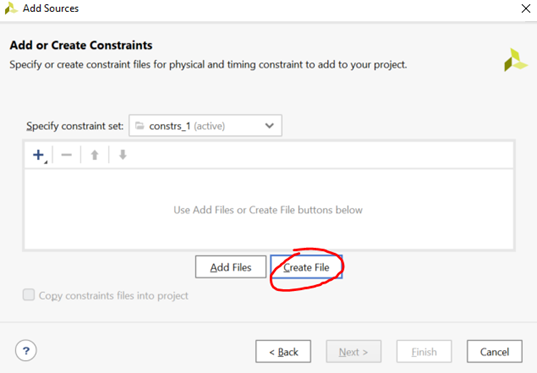

7. Select “Add or create constraints” and click “Next”. Select “Create File”, give any name to the file for example pin_constraints, and click “Finish”:
   ![Screenshot of Vivado Add or Create Constraints dialog showing the Create File option where you specify the constraint file name that will map GPIO signals to physical FPGA pins on the Zybo board](https://learn.arm.com/learning-paths/embedded-and-microcontrollers/advanced_soc/images/picture21.png)
   _Figure 3.7. Creating a constraints file_
