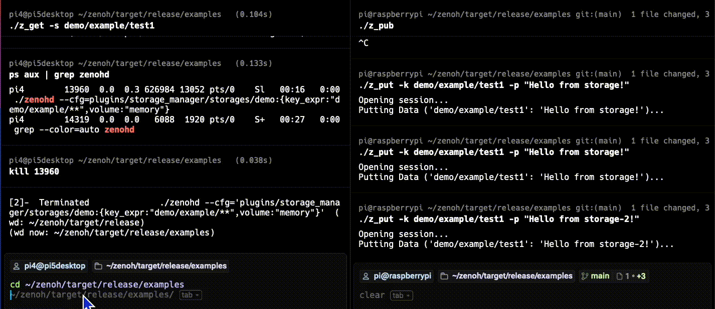

The result is shown below:
![Image Alt Text:img3 Zenoh queryable node responding to on-demand queries from a remote device](https://learn.arm.com/learning-paths/cross-platform/zenoh-multinode-ros2/zenoh_ex3.gif)
*Figure 3: Computation on Query using Queryable*
The response is generated dynamically by the queryable handler, and not fetched from stored data.
