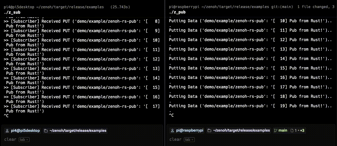

The result is shown below:
![Image Alt Text:Animated terminal demonstration showing z_put publishing a value to Zenoh storage on one device and z_get retrieving the stored value from another device, illustrating asynchronous data access across nodes](https://learn.arm.com/learning-paths/cross-platform/zenoh-multinode-ros2/zenoh_ex2.gif)
_Figure 2: Storage and Query_
If you have more than two Raspberry Pi devices, you can run the `z_get` command on a third device to validate that storage queries work seamlessly across a multi-node setup.
This example shows how Zenoh’s storage with query model supports asynchronous data access and resilient state-sharing - critical capabilities in robotics and industrial IoT systems where network connectivity may be intermittent or system components loosely coupled.
