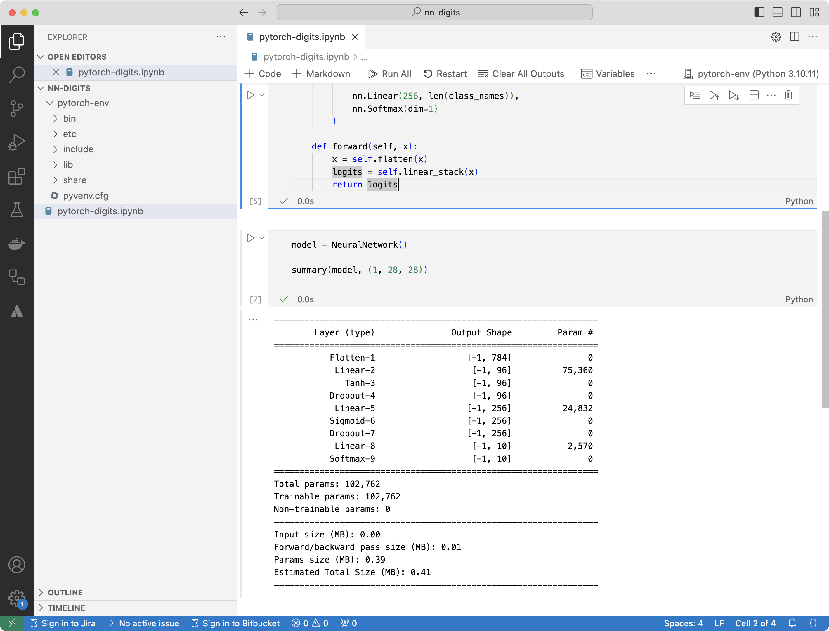

The next step initializes the model and displays the summary using the torchsummary package:
```python
model = NeuralNetwork()
summary(model, (1, 28, 28))
After running the notebook, you will see the output as shown in Figure 4:
![Model architecture summary output](https://learn.arm.com/learning-paths/cross-platform/pytorch-digit-classification-arch-training/figures/4.webp)
*Model architecture summary output*
You will see a detailed summary of the NeuralNetwork model’s architecture, including the following information:
1. **Layer Details**
   The summary lists each layer of the network sequentially, including:
   - The flatten layer, which reshapes the 28x28 input images into a 784-element vector.
   - The linear layers with 96 and 256 nodes, respectively, along with the activation functions (Tanh and Sigmoid) applied after each linear transformation.
   - The dropout layers that randomly deactivate 20% of the neurons in the respective layers.
   - The final linear layer with 10 nodes, corresponding to the output probabilities for the 10 digit classes, followed by the softmax function.
2. **Input and Output Shapes**
   For each layer, the summary shows the shape of the input and output tensors, helping to trace how the data flows through the network. For example, the input shape starts as (1, 28, 28) for the image, which gets flattened to (1, 784) after the flatten layer.
3. **The summary**
   The summary provides the total number of trainable parameters in each layer, including both weights and biases.
   This includes:
   - 75,360 parameters for the first Linear layer (784 inputs × 96 nodes + 96 biases).
   - 24,832 parameters for the second Linear layer (96 nodes × 256 nodes + 256 biases).
   - 2,570 parameters for the output Linear layer (256 nodes × 10 output nodes + 10 biases).
   - At the end, you will see the total number of parameters in the model, which is 102,762 trainable parameters.
This summary provides a clear overview of the model architecture, the dimensional transformations happening at each layer, and the number of parameters that will be optimized during training.
Running the model now will produce random outputs, as the network has not been trained to recognize any patterns from the data. The next step is to train the model using a dataset and an optimization process, such as gradient descent, so that it can learn to make accurate predictions.
At this point, the model makes predictions, but since it hasn’t been trained, the predictions are random and unreliable. The network’s weights are initialized randomly, or use the default initialization methods, so the output probabilities from the softmax layer are essentially random.
Technically, the code will run without errors as long as you provide it with an input image of the correct dimensions, which is 28x28 pixels. The model can accept input, pass it through the layers, and return a prediction - a vector of 10 probabilities. However, the results are not useful until the model is trained.
