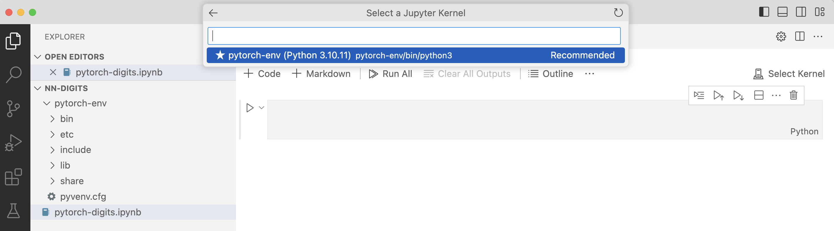

  4. Select the Python kernel you created earlier, pytorch-env. To do so, click Kernels in the top right-hand corner. Then, click Jupyter Kernel…, and you will see the Python kernel as shown below:
Image Alt Text:Screenshot of Visual Studio Code showing the Jupyter Kernel selection dialog with the pytorch-env Python kernel listed and highlighted for selectionPython kernel selection in VS Code

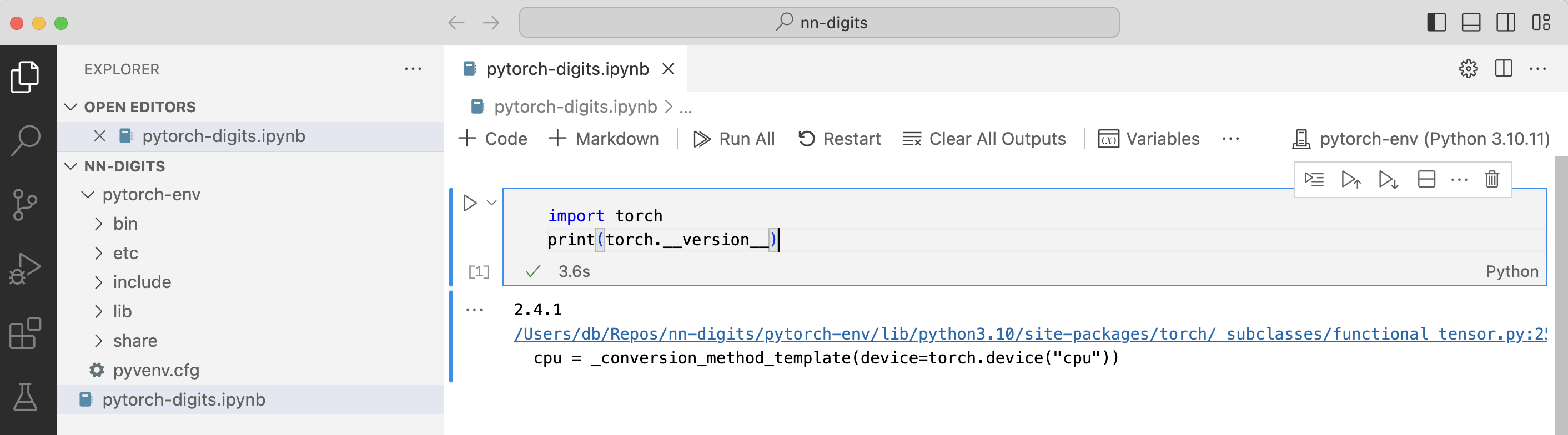

  1. In your Jupyter notebook, run the following code to verify PyTorch is working correctly:
import torch
print(torch.__version__)
It will look as follows: Image Alt Text:Screenshot of Jupyter Notebook in Visual Studio Code showing the executed cell with the torch import statement and version output, confirming PyTorch is installed and working correctlyJupyter Notebook with PyTorch version output
