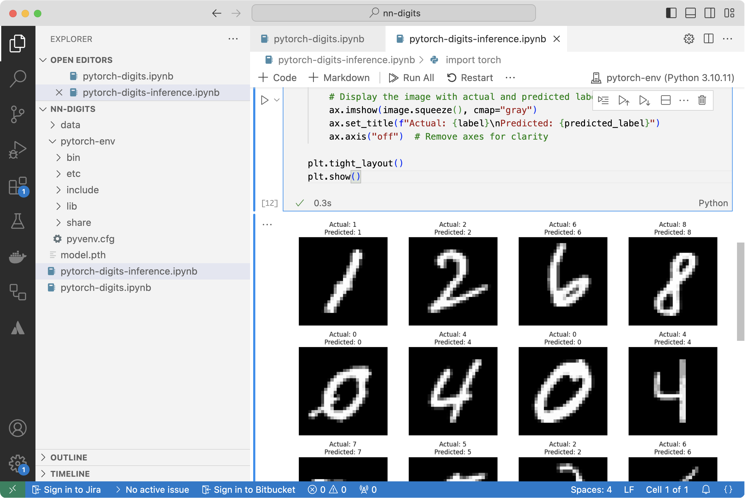

This code performs inference on the saved PyTorch model using 16 randomly-selected images from the MNIST test dataset, and then displays them alongside their predicted and actual labels.

Next, load the MNIST test dataset using datasets.MNIST() with train=False to specify that it is the test data. The dataset is automatically downloaded if it is not available locally.
Load the saved model using torch.jit.load("model.pth") and set the model to evaluation mode using model.eval(). This ensures that layers like dropout and batch normalization behave appropriately during inference.
Then select 16 random images and create a 4x4 grid of subplots using plt.subplots(4, 4, figsize=(12, 12)) for displaying the images.
Afterwards, perform inference and display the images in a loop. Specifically, for each of the 16 selected images, the image and its label are retrieved from the dataset using the random index. The image tensor is expanded to include a batch dimension (image.unsqueeze(0)) because the model expects a batch of images. Inference is performed with model(image_batch) to get the prediction. The predicted label is determined using torch.argmax() to find the index of the maximum probability in the output. Each image is displayed in its respective subplot with the actual and predicted labels. You can use plt.tight_layout() to ensure that the layout is well-adjusted, and plt.show() to display the 16 images with their predicted and actual labels.

After running the code, you should see results similar to the following figure:
Image Alt Text:Visualization showing a grid of MNIST handwritten digits with the model’s predictions displayed above each digit, allowing you to visually verify the model’s classification accuracy across multiple test samplesModel inference results on test digits
