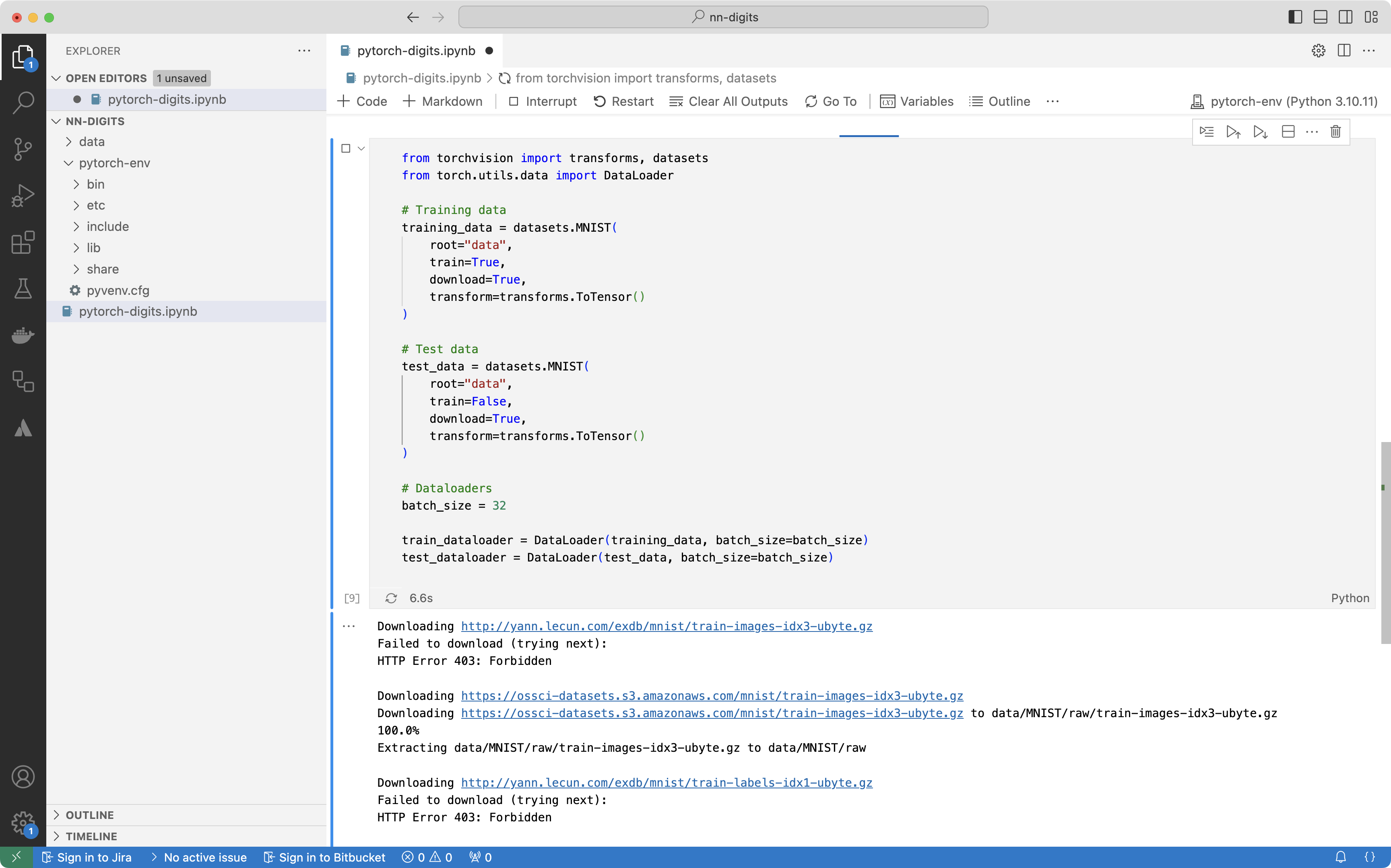

Start by downloading the MNIST dataset.
Open the pytorch-digits.ipynb
you created earlier.
Add the following statements:
from torchvision import transforms, datasets
from torch.utils.data import DataLoader
# Training data
training_data = datasets.MNIST(
root="data",
train=True,
download=True,
transform=transforms.ToTensor()
# Test data
test_data = datasets.MNIST(
root="data",
train=False,
download=True,
# Dataloaders
batch_size = 32
train_dataloader = DataLoader(training_data, batch_size=batch_size)
test_dataloader = DataLoader(test_data, batch_size=batch_size)
Using this code enables you to:
Specifically, the datasets.MNIST
function downloads the MNIST dataset, with train=True
indicating training data and train=False
indicating test data. The transform=transforms.ToTensor()
argument converts each image in the dataset into a PyTorch tensor, which is necessary for model training and evaluation.
The DataLoader wraps the datasets and enables efficient loading of data in batches. It handles data shuffling, batching, and parallel loading. Here, the train_dataloader and test_dataloader are created with a batch_size of 32, meaning they will load 32 images per batch during training and testing.
This setup prepares the training and test datasets for use in a machine learning model, enabling efficient data handling and model training in PyTorch.
To run the above code, you will need to install certifi package:
pip install certifi
The certifi Python package provides the Mozilla root certificates, which are essential for ensuring the SSL connections are secure. If you’re using macOS, you might also need to install the certificates by running:
/Applications/Python\ 3.x/Install\ Certificates.command
Make sure to replace ‘x’ with the version number of Python that you have installed.
After running the code, you will see output similar to Figure 5:
Figure 5. Output

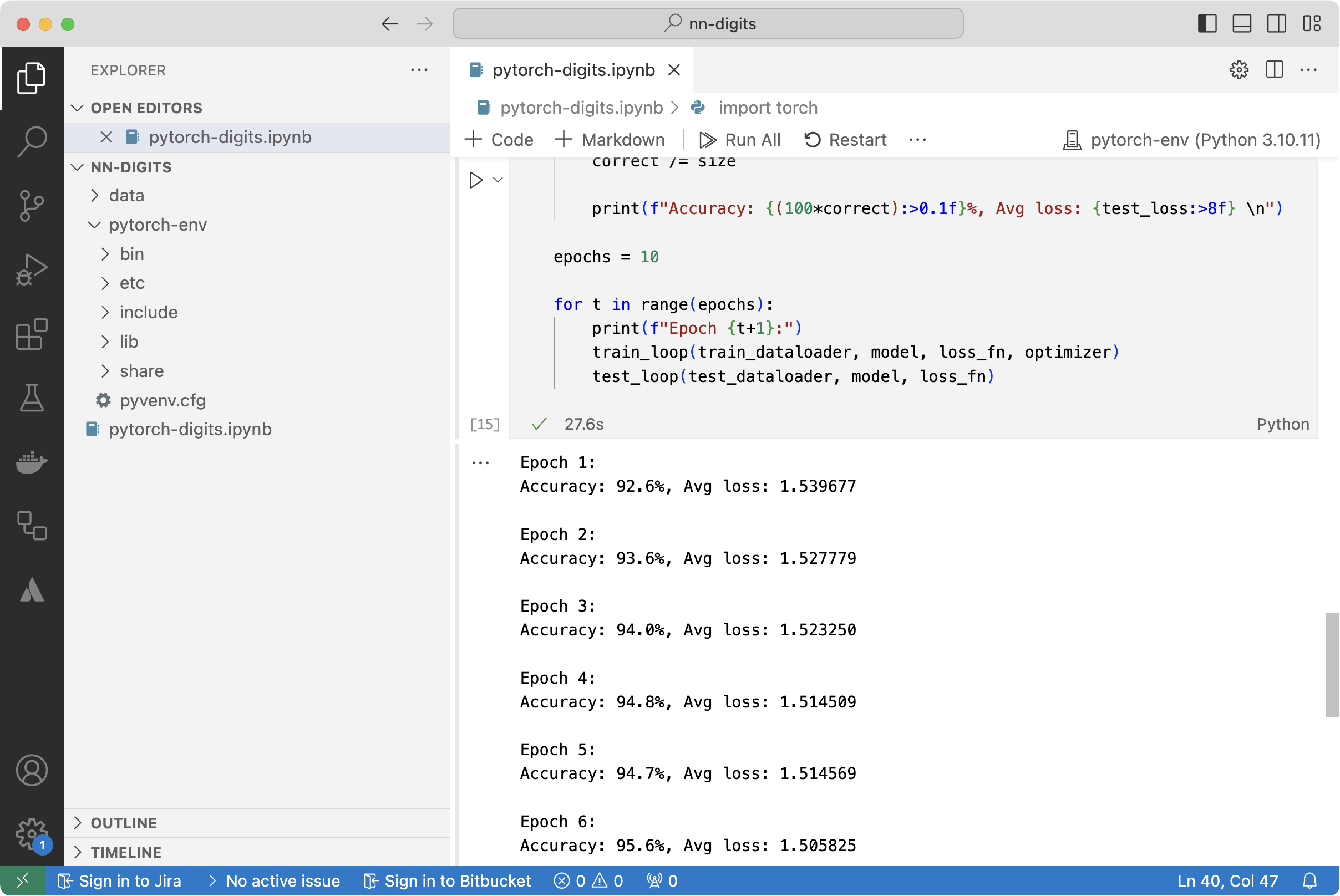

You can now invoke these methods to train and evaluate the model using 10 epochs.
epochs = 10
for t in range(epochs):
print(f"Epoch {t+1}:")
train_loop(train_dataloader, model, loss_fn, optimizer)
test_loop(test_dataloader, model, loss_fn)
After running the code, you see the following output showing the training progress, as displayed in Figure 2.
Figure 2. Output 2
Once the training is complete, you see output similar to:
Epoch 10:
Accuracy: 95.4%, Avg loss: 1.507491
The output shows the model achieved around 95% accuracy.
