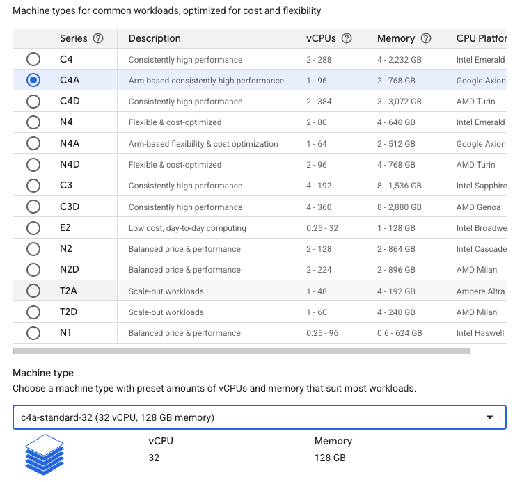

- Under Machine configuration:
- Specify an Instance name, Region, and Zone.
- Set Series to C4A.
- Select c4a-standard-32 as the machine type.
Creating a Google Axion C4A virtual machine in the Google Cloud Console

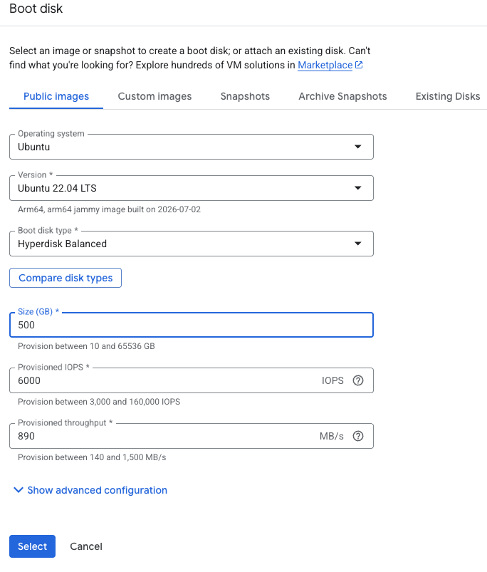

- Under OS and storage, select Change, then choose an Arm-based operating system image.
- For this Learning Path, select Ubuntu 22.04 LTS (Arm64).
- To allocate sufficient disk space, increase Size (GB) from 10 to 500.
- To apply the image changes, select Choose.
Ubuntu 22.04 LTS Arm64 boot disk configured with 500 GB

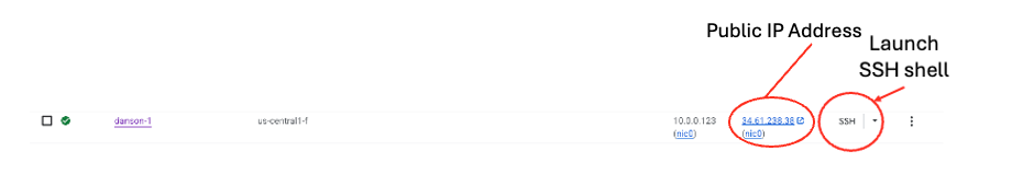

After the instance starts, select SSH next to the VM in the instance list to open a browser-based terminal session.
Connecting to a running C4A virtual machine using SSH
