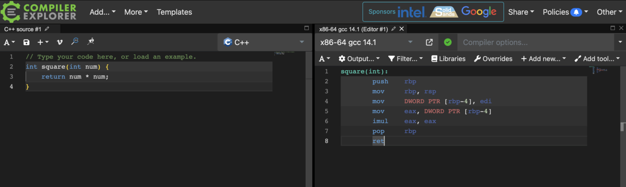

To access Compiler Explorer, open a browser and go to [https://godbolt.org](https://godbolt.org).
This leads you to the page shown below in Figure 1. Your view might be slightly different.
![Figure 1. Compiler Explorer](https://learn.arm.com/learning-paths/cross-platform/mca-godbolt/open.webp)
The left side of the page contains the source code. In Figure 1, the language is set to C++, but you can click on the programming language to select a different language for the source code.
Copy the code below and paste it into Compiler Explorer as C++ source code:
