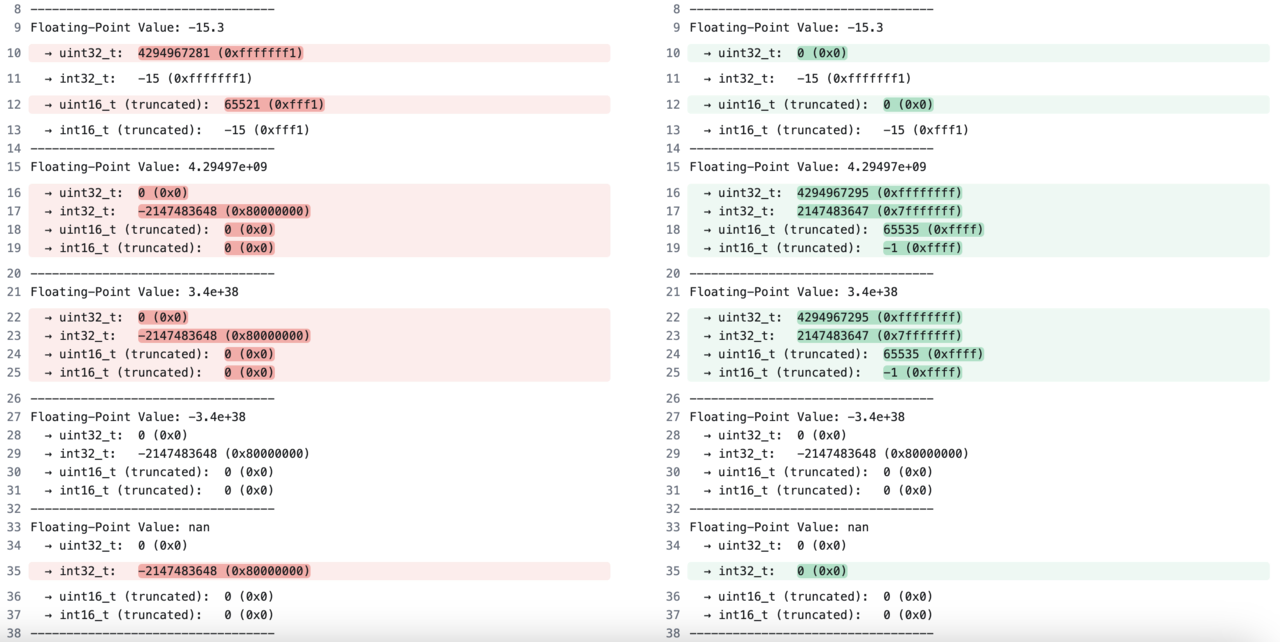

For easy comparison, the image below shows the x86 output (left) and Arm output (right). The highlighted lines show the difference in output:
Image Alt Text:Side-by-side terminal output comparison showing x86 results on the left and Arm results on the right, with highlighted lines indicating differences in undefined floating-point conversion behaviors such as out-of-range signed-to-unsigned conversionsx86 vs Arm floating-point conversion output comparison
As you can see, there are several cases where different behavior is observed in these undefined scenarios. For example, when trying to convert a signed number to an unsigned number or dealing with out-of-bounds values.
