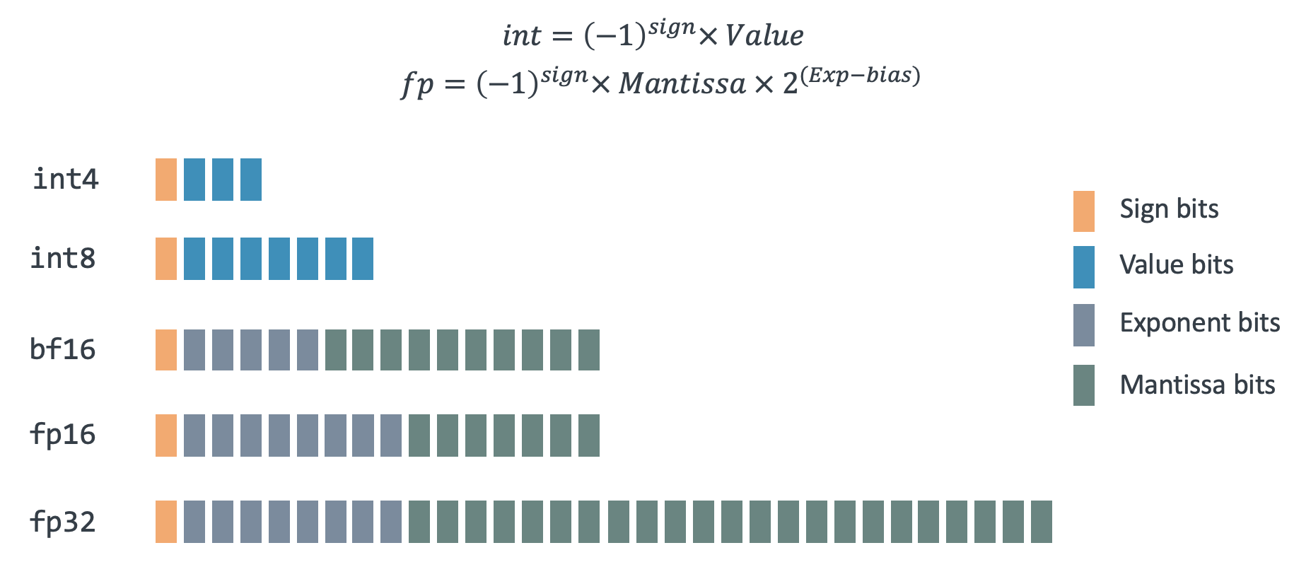

The graphic below shows various forms of floating-point representation supported by Arm, each with varying number of bits assigned to the exponent and significand.
Floating-point formats supported by Arm

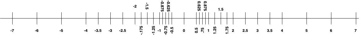

For example, with 3 bits for the significand and an exponent range of -1 to 2, only a limited set of values can be represented. The diagram below illustrates these values.
ULP spacing visualization showing quantization gaps
