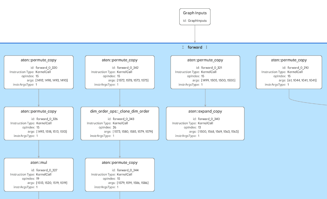

The following is a small snippet image:
Portable GPT-2 execution graph
In the artifact, notice the following:
- The graph has 589 operator nodes and no XNNPACK delegate regions. Including the graph input and output nodes, Model Explorer displays 591 nodes.
- Most visible operator names use the
aten::namespace. ATen is PyTorch’s core operator library. - The model has two fixed-shape inputs with shape
[1, 128], corresponding to a batch size of 1 and a fixed sequence length of 128 tokens. - The output shape is
[1, 50257], which represents logits over the GPT-2 vocabulary for the wrapped last-token output. - Repeated transformer patterns are visible. Look for groups of
aten::addmm,aten::bmm,aten::_softmax,aten::native_layer_norm, residualaten::add, and theaten::pow,aten::tanh, andaten::muloperations used by the GELU activations. - Many layout and shape-manipulation operators are present, such as
aten::permute_copy,aten::expand_copy,aten::unsqueeze_copy, anddim_order_ops::_clone_dim_order. These operators are useful to notice because they can affect memory movement and become boundaries around optimized backend regions.

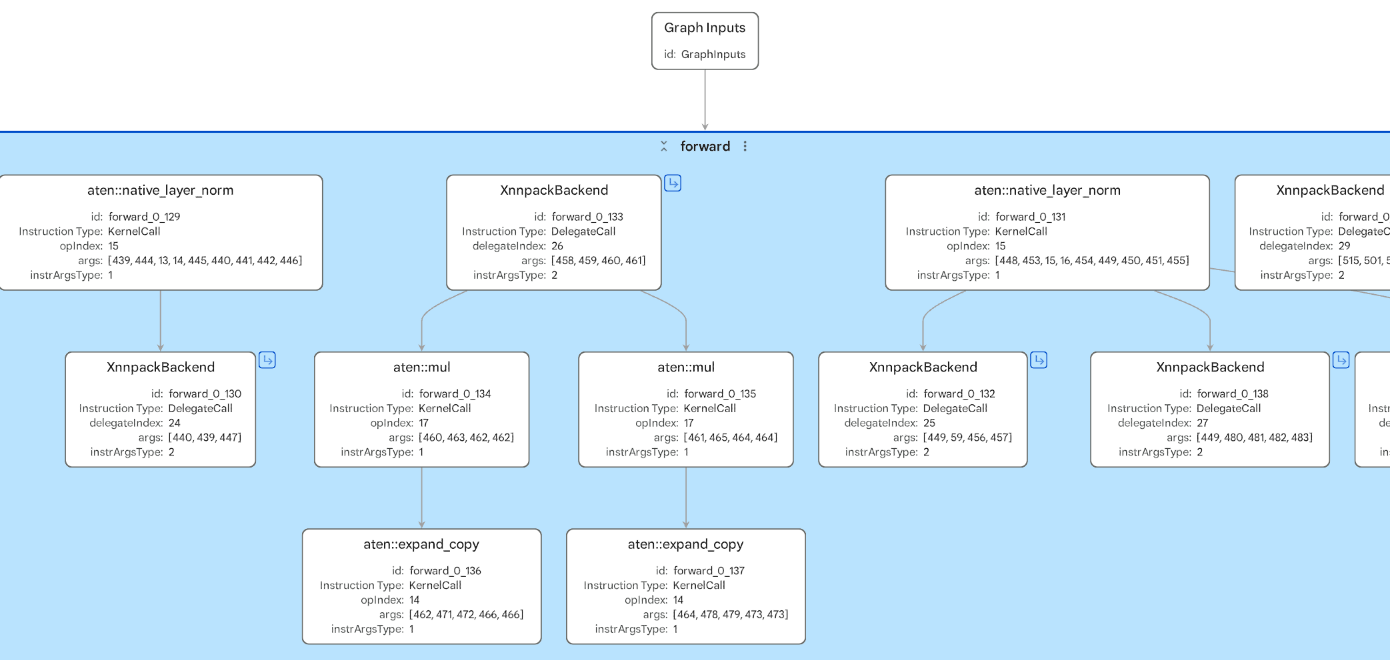

The backend has changed the execution plan:
Fragmented XNNPACK delegation in GPT-2
- The top-level graph is smaller than the portable graph, with 336 operator nodes instead of 589. Including the graph input and output nodes, Model Explorer displays 338 nodes.
- The graph contains 75
XnnpackBackendnodes. These represent the delegated regions that’ll execute through XNNPACK. - Model Explorer exposes the XNNPACK delegate subgraphs. Open a delegate subgraph to see backend-level operators such as
XNNFullyConnected,XNNBatchMatrixMultiply,XNNStaticTranspose,XNNStaticReshape,XNNAdd,XNNMultiply,XNNTanh, andXNNSoftmax. - The input and output contract remains the same as the portable artifact: two
[1, 128]inputs and one[1, 50257]output. - Some
aten::operators still remain at the top level, including shape, masking, normalization, and elementwise operations. These are the parts of the graph that stayed on the default ExecuTorch path. - The graph isn’t one single XNNPACK region. GPT-2 contains attention, masking, reshapes, and layout changes, so delegation is fragmented into many backend regions.

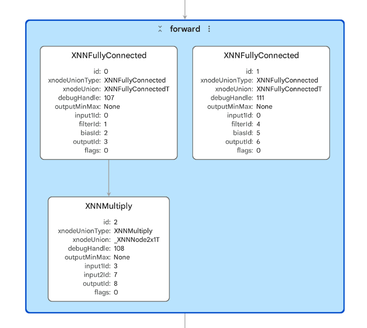

Operators inside a GPT-2 XNNPACK delegate region
This is the key difference to notice: XNNPACK doesn’t replace the whole .pte. It captures supported subgraphs and leaves the rest of the program in ExecuTorch. In performance work, the balance between large delegated regions and remaining default-path operators is often more important than the raw number of delegate nodes.
