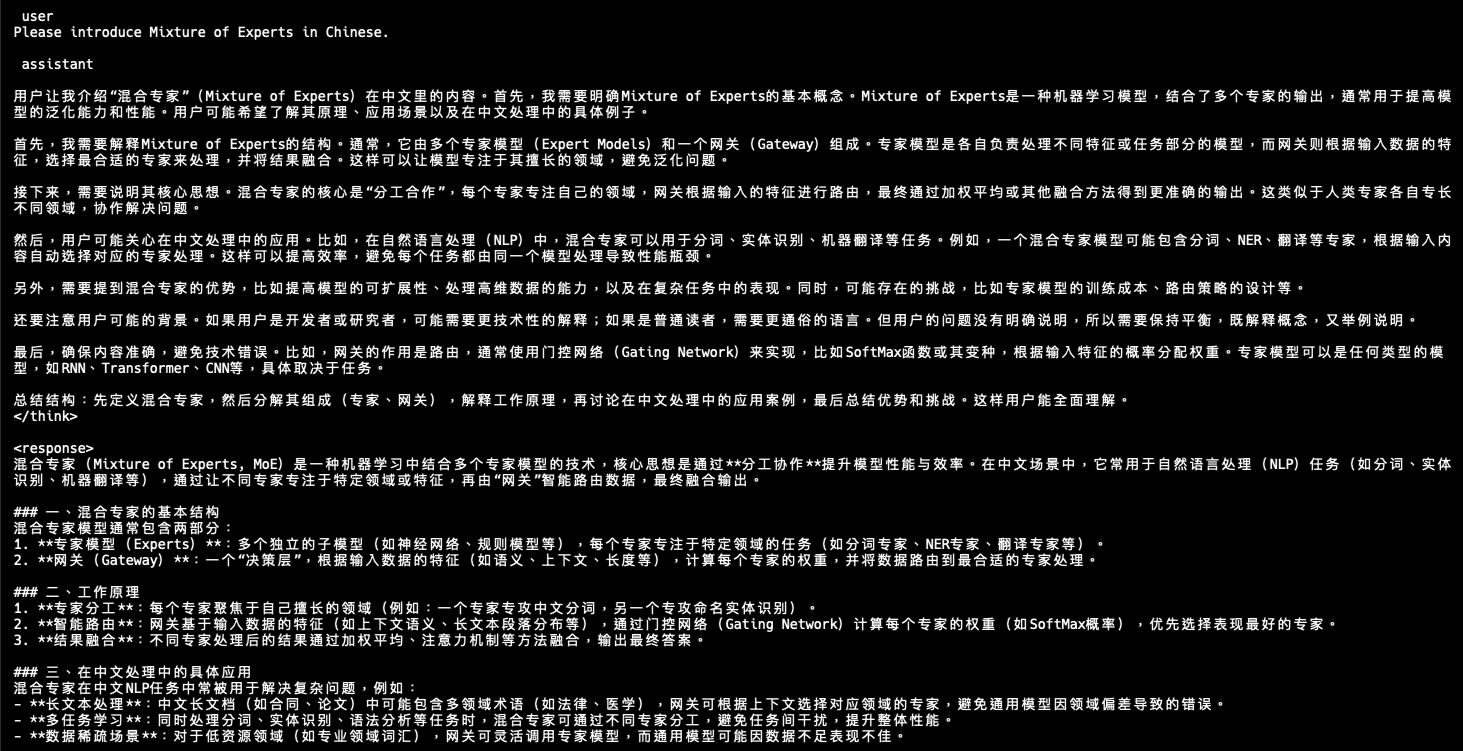

Once inference is complete, the expected output looks like this (in Chinese):
Image Alt Text:Terminal output showing ERNIE-4.5 model response in Chinese with structured markdown formatting explaining Mixture of Experts conceptIntroducing Mixture of Experts in Chinese
This answer demonstrates the model’s multilingual and structured reasoning ability. It begins with a narrative explanation introducing the concept of Mixture of Experts (MoE), followed by a well-organized markdown-style summary with section headers and bullet points. The response describes MoE as a model combining multiple specialized sub-models (experts) and a routing mechanism (gateway) to activate only a few experts per input. It explains how routing selects top experts based on input features and how the system reduces computation by activating only a small number of experts per token. The answer also gives examples such as word segmentation and translation, explaining how different experts might focus on distinct subtasks in Chinese NLP applications.
This confirms the GGUF model is successfully loaded, the llama.cpp build functions as expected, and CPU-only inference on Armv9 is working.
The prompt “Please introduce Mixture of Experts in Chinese.” was chosen because it tests two important capabilities. First, it verifies bilingual capability since the instruction is in English but the answer is expected in Chinese, confirming that ERNIE-4.5’s multilingual support works correctly. Second, it engages MoE behavior by having the model explain a technical concept in Chinese, which likely activates different experts within the model during inference. Even though routing isn’t explicitly logged, the richness and precision of the output suggest that MoE routing functions as designed. This type of prompt increases the likelihood of multiple experts being activated simultaneously, including language generation, machine learning knowledge, and Chinese translation experts.
