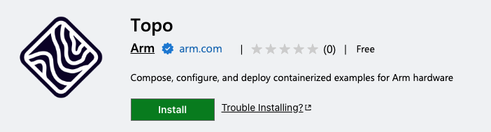

Install the extension
Install the Topo extension from the Visual Studio Marketplace using the link above.
Image Alt Text:Screenshot of the Topo extension install page in Visual Studio Code.Topo extension install page for Visual Studio Code
A guide is provided on the extension page, but some brief steps are also shown here. If you are familiar with Topo CLI, you should have little trouble using the extension. After installation, open the Topo view from the VS Code activity bar.

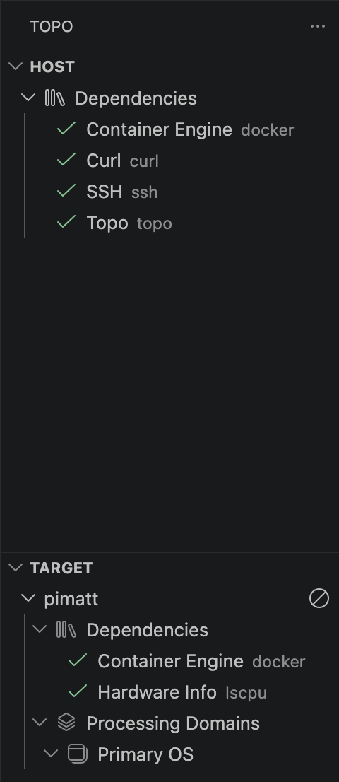

Add and inspect a target
The Topo sidebar shows your host by default. Use the sidebar to also add your Arm-based Linux target. The target is the same SSH destination you used with the CLI, for example user@my-target.
The extension shows the host and target state, available Topo actions, and deployed applications, providing similar insights to topo health and topo ps.
Image Alt Text:Screenshot of the Topo sidebar in Visual Studio Code showing target and deployment actions.Topo sidebar in Visual Studio Code

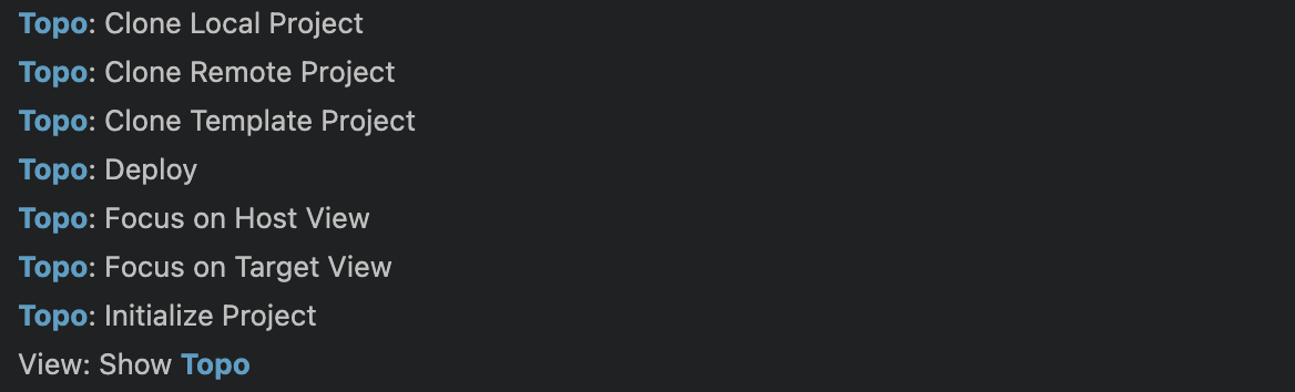

The command palette exposes the usual Topo commands such as listing compatible projects, cloning projects, and deploying projects.

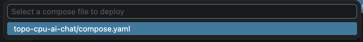

Deploy from VS Code
After cloning or selecting a Topo Project, you can deploy it. Open or clone the LLM chat example, then deploy it using the VS Code extension.
Image Alt Text:Screenshot of deploying a Topo workload from Visual Studio Code.Deploy a Topo workload from Visual Studio Code

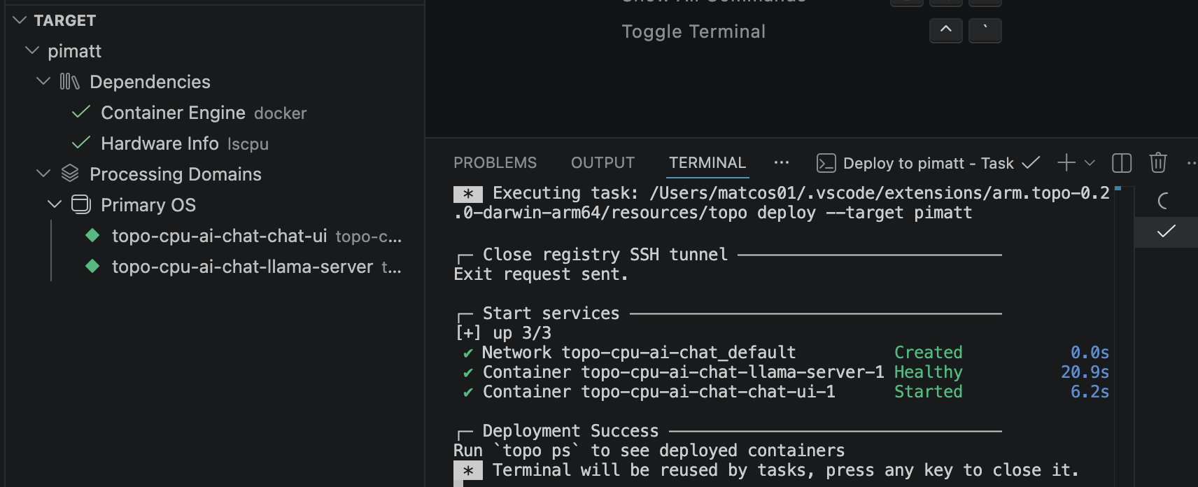

When deployment completes, you will see the processes running on the target in the Topo sidebar:
Image Alt Text:Screenshot of a deployed LLM chatbot processes shown in the Topo VS Code extension.Deployed LLM chatbot processes in the Topo VS Code extension
