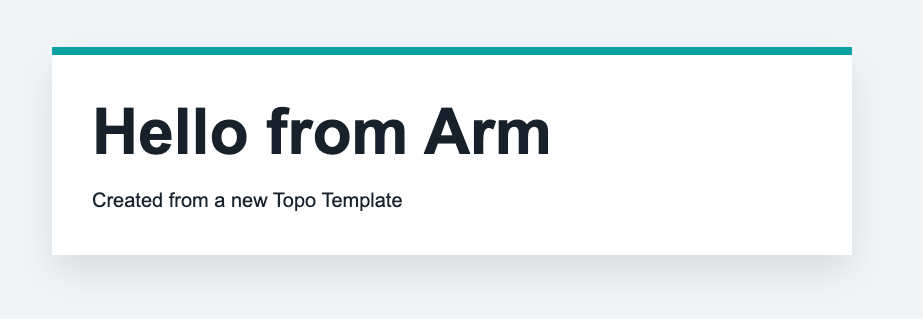

When deployment completes, open http://<target-ip-address>:8088/ in your browser. You can also forward the port over SSH:
ssh -L 8088:localhost:8088 user@my-target
Then open http://localhost:8088/ in your browser.
Image Alt Text:Screenshot of the new Topo Template - a web page with the text &ldquo;Hello from Arm&rdquo; as the title. This confirms successful deployment and provides a visual reference for the expected result.Hello from Arm web page
Confirm that the container is running:
topo ps --target user@my-target
The output includes the message-card service and port 8088.
