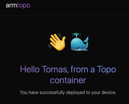

### View the application
If the target is reachable on your network, open `http://<target-ip-address>:8000/` in your browser.
If you prefer to forward the port over SSH, run:
```bash
ssh -L 8000:localhost:8000 user@my-target
Then open `http://localhost:8000/` in your browser.
The “Hello World” application appears as follows:
![Image Alt Text:Screenshot of the Hello World web interface. This confirms successful deployment and provides a visual reference for the expected result.](https://learn.arm.com/learning-paths/cross-platform/create-your-own-topo-project/hello_tomas.png)
*Hello World web interface*
