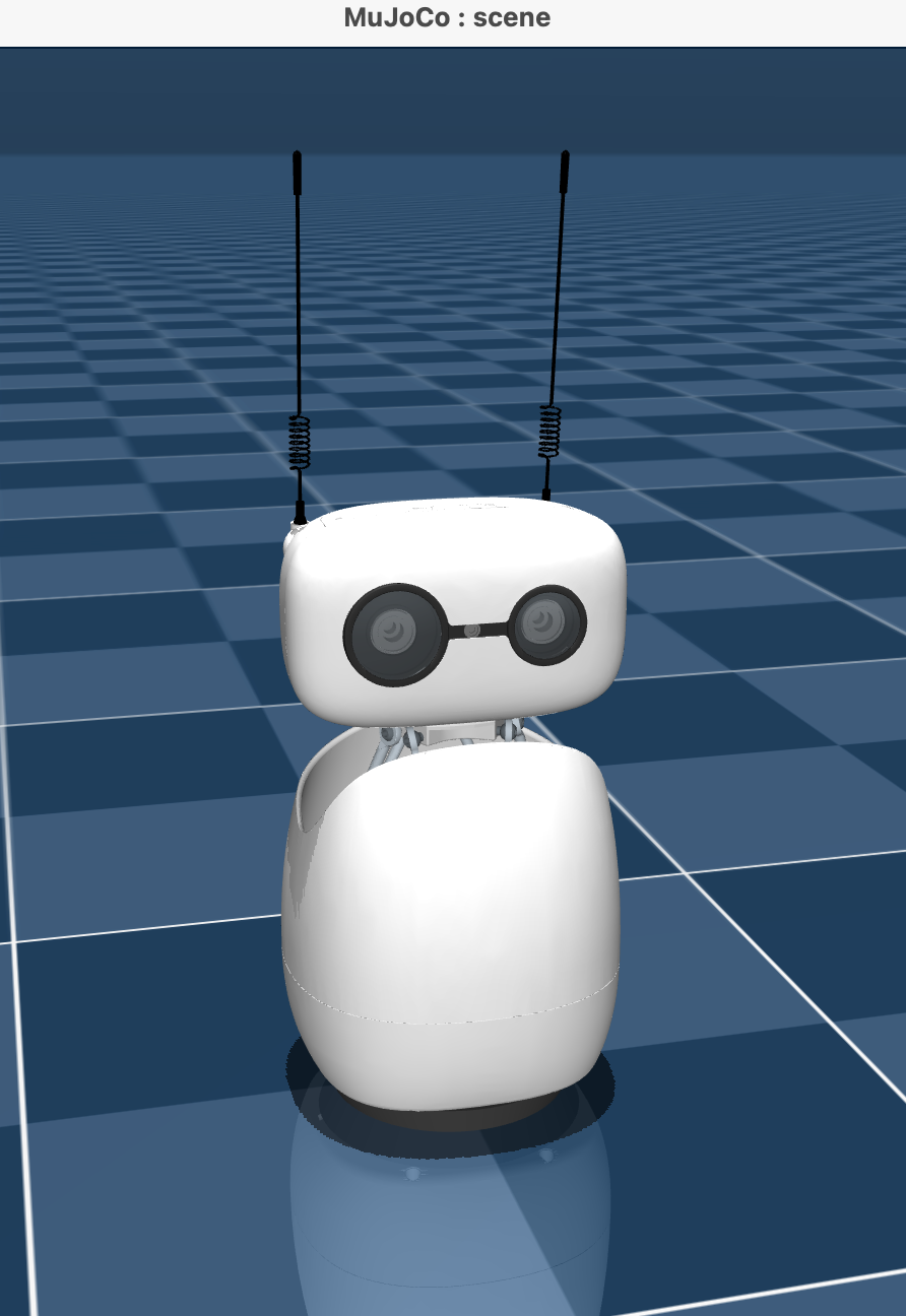

The simulation can take several minutes to start up. When the simulation is ready, the output is similar to:
__output__ reachy_mini.daemon.daemon - INFO - Daemon started successfully.
__output__ uvicorn.error - INFO - Application startup complete.
__output__ uvicorn.error - INFO - Uvicorn running on http://0.0.0.0:18000 (Press CTRL+C to quit)
__output__ reachy_mini.utils.discovery - INFO - mDNS service registered: reachy_mini on port 18000
__output__ reachy_mini.media.media_server - INFO - Pipeline latency (live=True, min_latency=30000000, max_latency=1200000000)
Leave this terminal running after it completes and boots the simulation view.
![MuJoCo simulation window with Reachy Mini](https://learn.arm.com/learning-paths/cross-platform/build-a-reachy-robot-app-on-pi/mujoco.png)
The script starts the Reachy Mini daemon with simulation enabled, binds FastAPI to `0.0.0.0`, and disables localhost-only mode so the Raspberry Pi can connect. In this Learning Path, you’ll use port `18000`.
The daemon is the network boundary between the Pi app and the simulated robot. The Pi doesn’t run MuJoCo. It connects to this daemon and sends the same SDK motion commands that it would send to a physical Reachy daemon.
