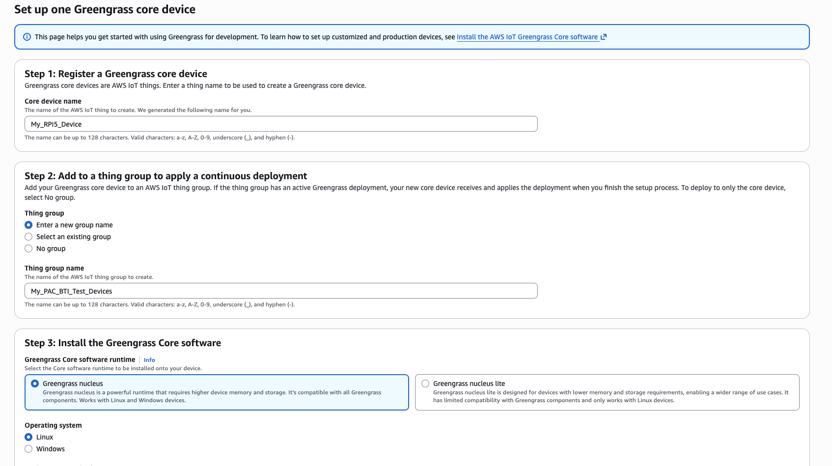

1. Open the AWS Console and go to **IoT Core** > **Greengrass devices** > **Core devices**.
2. Select **Set up core device** > **Set up one core device**.
3. Enter a name for your core device.
4. For **Thing group**, select **Enter a new group name**.
   Use `My_PAC_BTI_Test_Devices` as the **Thing group name**. Save the name because you’ll reuse this group for your Armv9 device in the next section.
5. For **Greengrass Core software runtime**, select **Greengrass nucleus** for installation.
6. For **Operating system**, select **Linux**.
![Greengrass core device setup — Linux and installer selection](https://learn.arm.com/learning-paths/cross-platform/aws-greengrass-pacbti-test/images/greengrass-1.png)
*Greengrass core device setup — Linux and installer selection*
