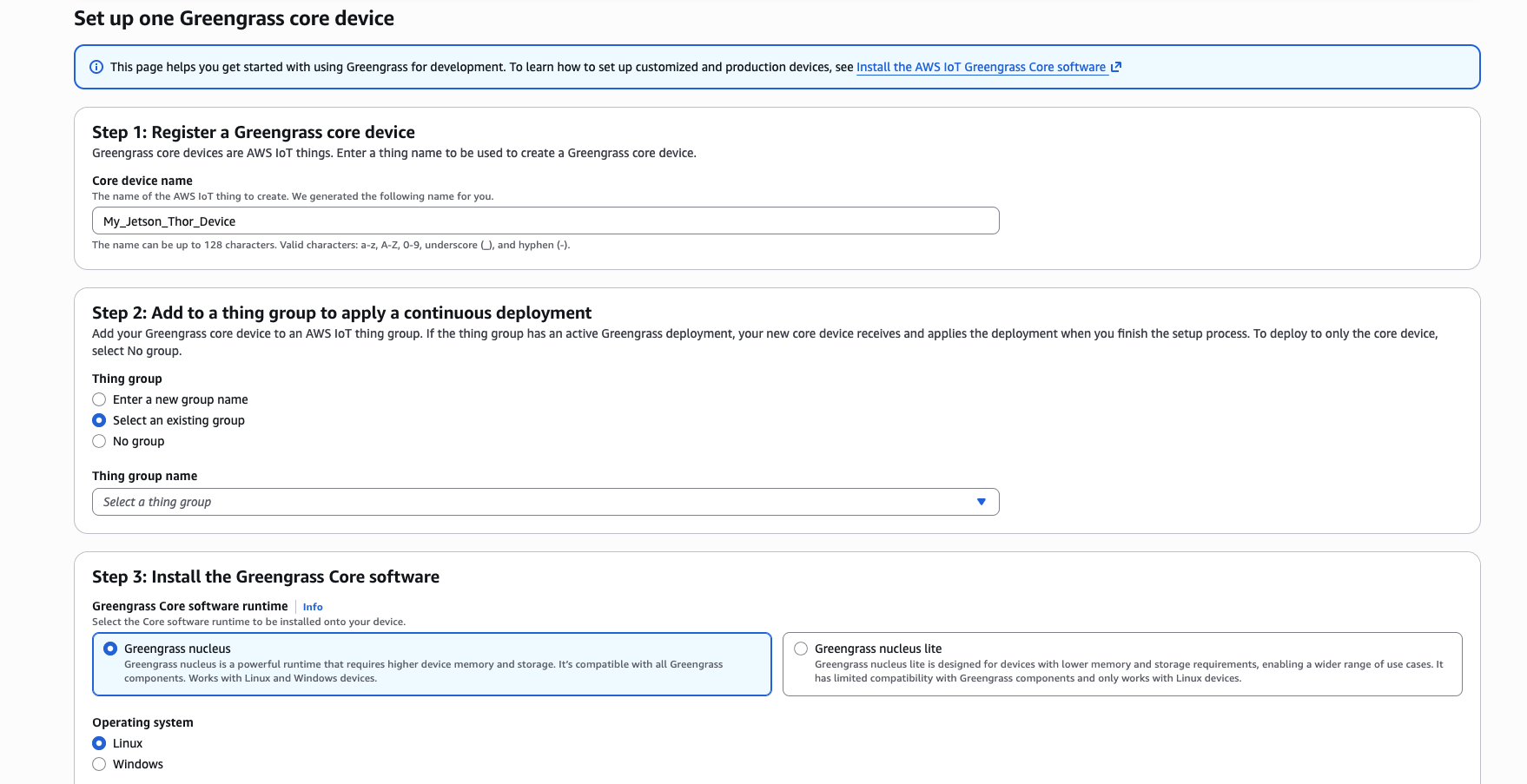

Open the AWS Console and go to IoT Core > Greengrass devices > Core devices.
Select Set up core device > Set up one core device.
Enter a core device name that is different from your RPi5 device.
For Thing group, select Select an existing group and choose
My_PAC_BTI_Test_Devices.For Greengrass Core software runtime, select Greengrass nucleus for installation.
For Operating system, select Linux.
Greengrass core device setup — selecting the existing thing group

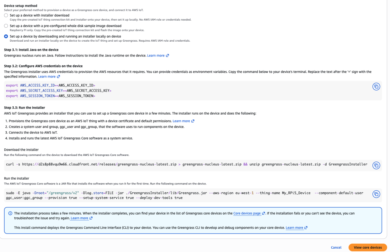

For Device setup method, select Set up a device by downloading and running an installer locally on device.
Follow the generated installer instructions on the Jetson Thor and authenticate with your AWS credentials.
Generated installer commands for the Jetson Thor
