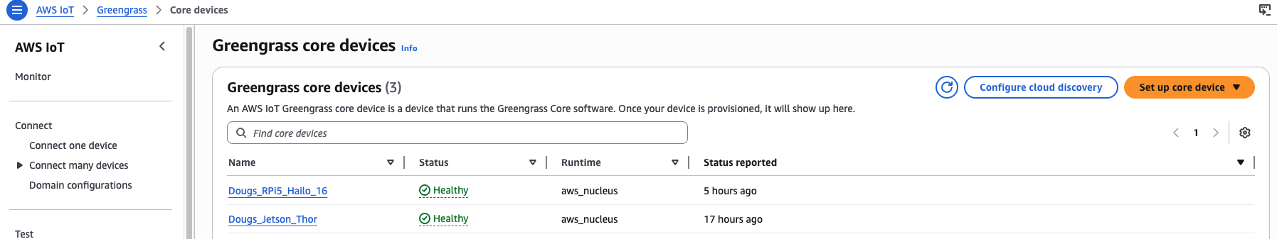

- In the AWS Console, go to IoT Core > Greengrass devices > Core devices and record both core device names.
Greengrass Core devices list

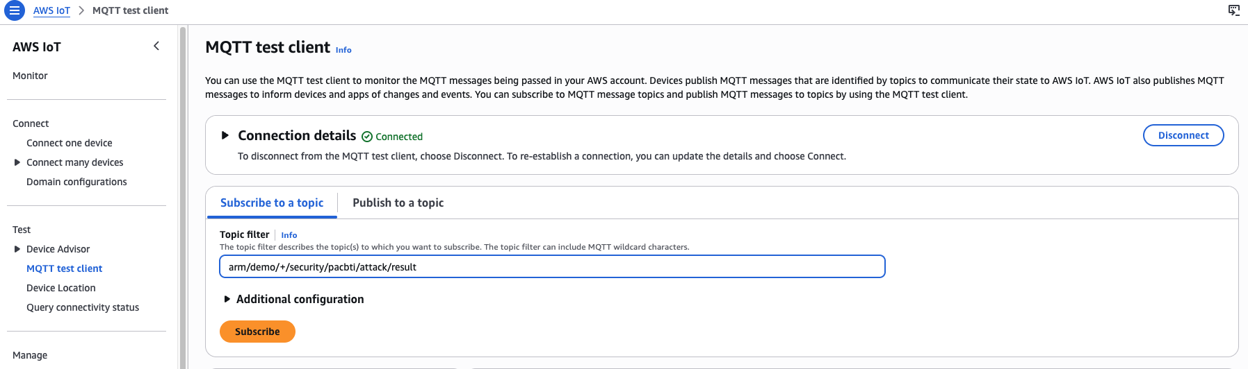

In the AWS Console, open IoT Core > MQTT test client and select Subscribe to a topic.
For Topic filter, enter the following topic:
arm/demo/+/security/pacbti/attack/result
- Select Subscribe.
MQTT test client subscribed to the PAC/BTI result topic

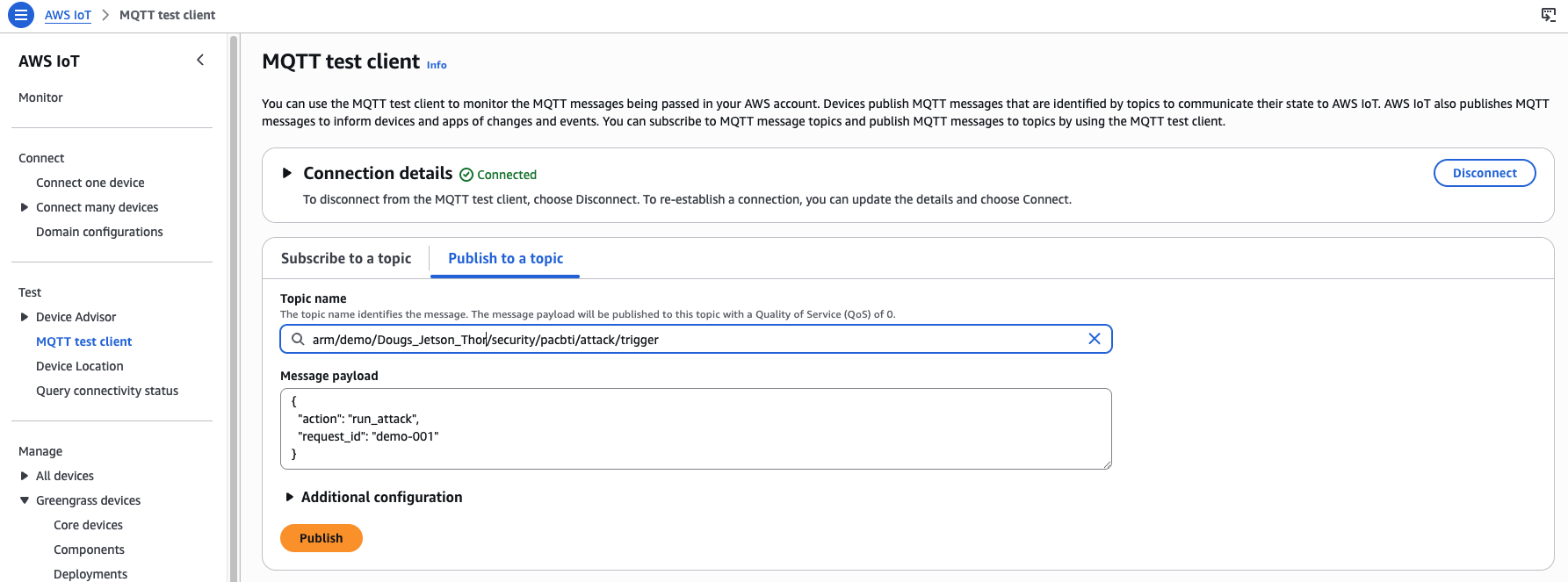

On the same page, select the Publish to a topic tab.
For Topic name, enter the following, replacing YOUR_CORE_DEVICE_NAME with the name of your Jetson Thor device:
arm/demo/YOUR_CORE_DEVICE_NAME/security/pacbti/attack/trigger
- Set the Message payload:
"action": "run_attack",
"request_id": "demo-001"
- Select Publish.
MQTT publish to Thor device trigger topic

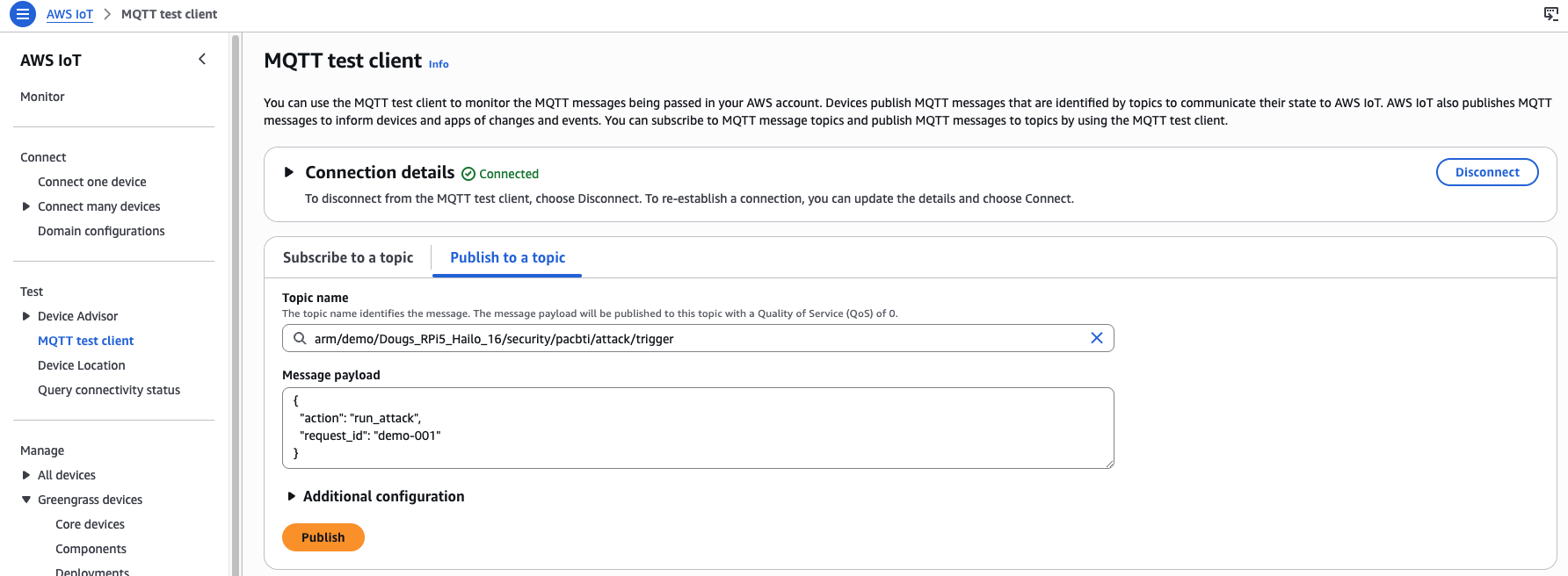

- Under Publish to a topic, set the Topic name as follows. Replace YOUR_CORE_DEVICE_NAME with your RPi5 core device name:
- Select Publish.
MQTT publish to RPi5 device trigger topic
Review the result for the Raspberry Pi 5 device
