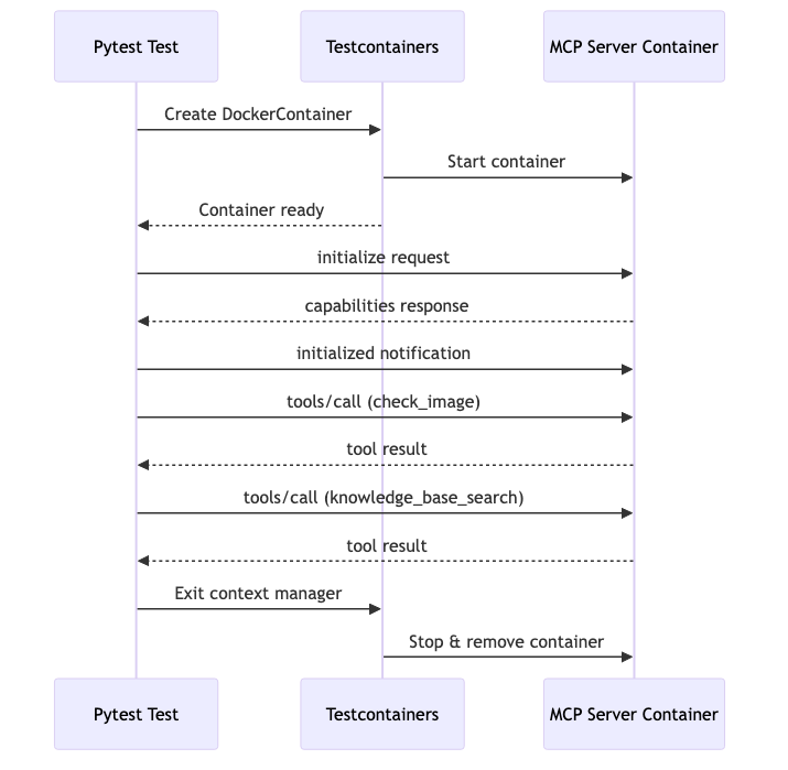

Before writing tests, you need to understand how MCP servers communicate. MCP uses JSON-RPC 2.0 over standard input/output (stdio transport). The following diagram shows the communication flow between your test code, Testcontainers, and the MCP server:
Image Alt Text:MCP communication sequence diagram showing: Pytest Test creates DockerContainer via Testcontainers, which starts the MCP Server Container. The test then sends initialize request, receives capabilities response, sends initialized notification, then makes tools/call requests for check_image and knowledge_base_search, receiving results for each. Finally, the test exits the context manager, triggering Testcontainers to stop and remove the containerMCP JSON-RPC Communication Flow The communication follows this sequence:
StepDirectionMessage Type
1Client → Serverinitialize request with protocol version
2Server → ClientResponse with server capabilities
3Client → Serverinitialized notification
4Client → Servertools/call requests to invoke tools
Each message is a JSON object followed by a newline character.
