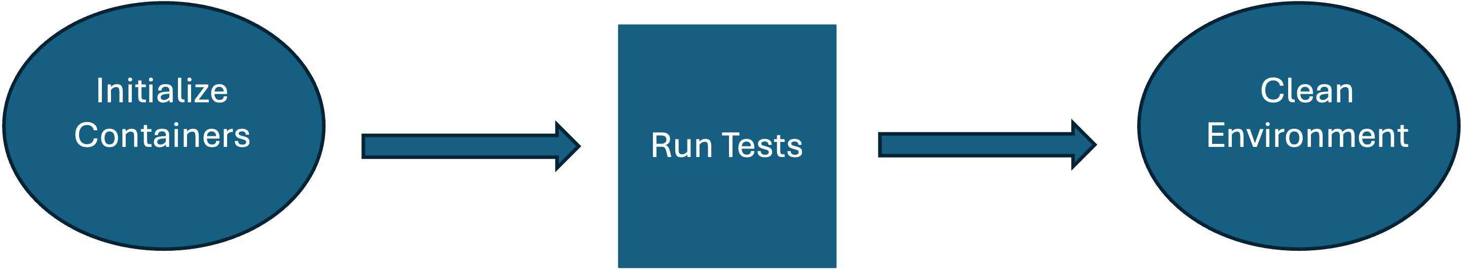

Understanding Testcontainers for Python
Testcontainers is a Python library that provides lightweight, throwaway instances of Docker containers for testing. Instead of mocking your MCP server, you can spin up the actual Docker container, run tests against it, and tear it down automatically.
Image Alt Text:Diagram showing Testcontainers workflow: test code creates a Docker container, runs tests against it, and automatically tears it down after completionTestcontainers flow
This approach offers several benefits:
  • Realistic testing: tests run against the actual server implementation
  • Isolation: each test run gets a fresh container instance
  • Reproducibility: tests behave consistently across development machines and CI environments
  • No external dependencies: tests don’t require a pre-deployed server
