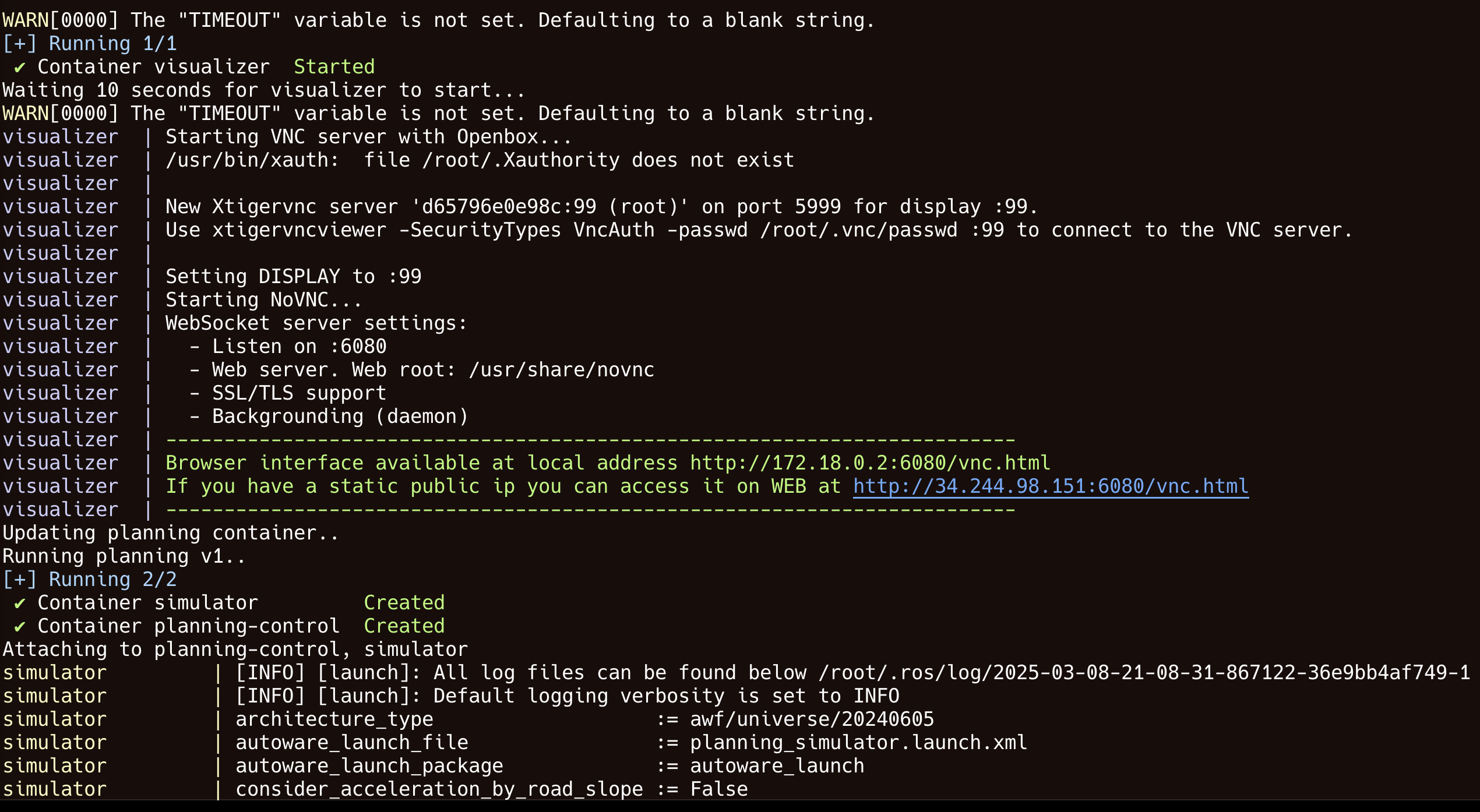

To start the Planning Visualizer Demo, execute the following script:
```bash
./docker/run.sh
This Bash script sets up environment variables and orchestrates the execution of Open AD Kit’s visualizer, planning-control, and simulator using the previously mentioned Docker Compose setup. The script runs in a loop, continuously testing two different planning configurations: `CONF_FILE_FAIL` and `CONF_FILE_PASS`.
Once the script starts successfully, you will see a similar output to the image below.
You can use your browser to monitor the simulation data in real-time.
![Terminal output showing run.sh execution with VNC URL](https://learning-paths/automotive/openadkit1_container/vnc_address.webp "Terminal output showing run.sh execution with VNC URL")
Now you can use the browser to access visualization. In this example the URL is `http://34.244.98.151:6080/vnc.html`

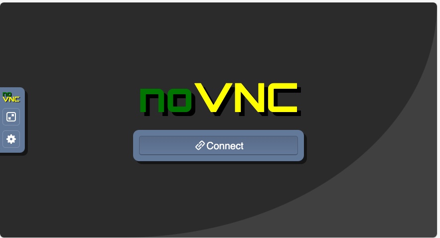

To access the visualizer:
1. Open a web browser and go to: `http://<server-ip>:6080/vnc.html`
2. Click **Connect** on the VNC login screen.
   ![VNC connection screen with Connect button](https://learning-paths/automotive/openadkit1_container/openadkit_connect.jpg "VNC connection screen with Connect button")

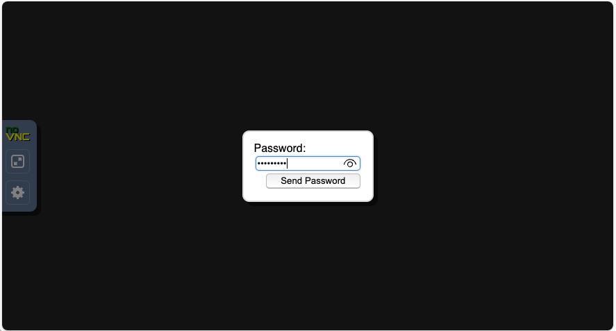

3. Enter the default VNC password: **“openadkit”**.
   ![VNC password authentication dialog](https://learning-paths/automotive/openadkit1_container/openadkit_passwd.jpg "VNC password authentication dialog")
You are now in the Open AD Kit simulation environment.

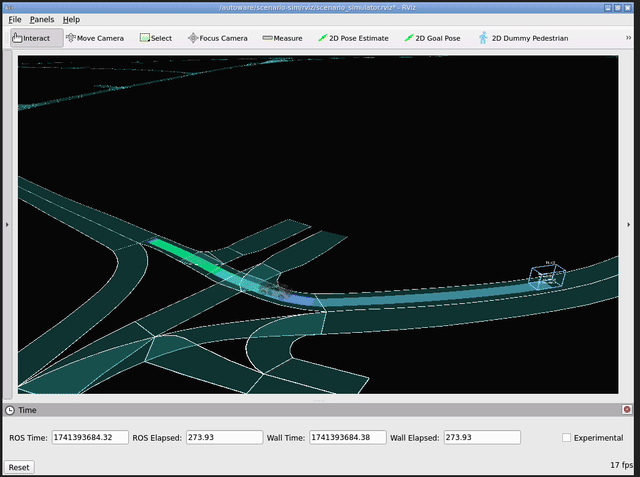

The demo will continuously repeat the two scenarios:
- **fail_static_obstacle_avoidance.param.yaml**: In the first scenario, the vehicle remains stationary behind the obstacle.
- **pass_static_obstacle_avoidance.param.yaml**: In the second scenario, the vehicle is permitted to change lanes to maneuver around the obstacle.
The vehicle starts from a stationary position, moves along the road, and stops when there is a vehicle ahead, waiting for the obstruction to clear before proceeding.
After each simulation run, it automatically restarts after 90 seconds. You can use the mouse to adjust different viewing angles for observation.
![Open AD Kit simulation showing obstacle avoidance scenarios](https://learning-paths/automotive/openadkit1_container/openadkit_1.gif "Open AD Kit simulation showing obstacle avoidance scenarios")
