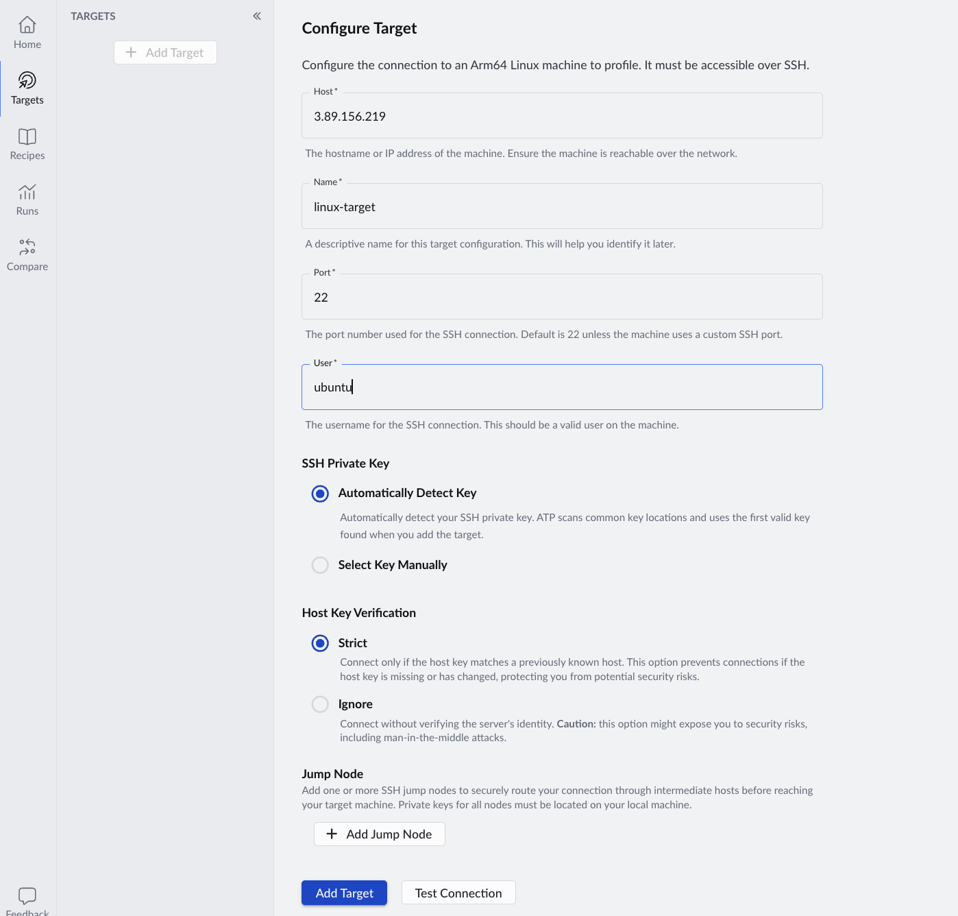

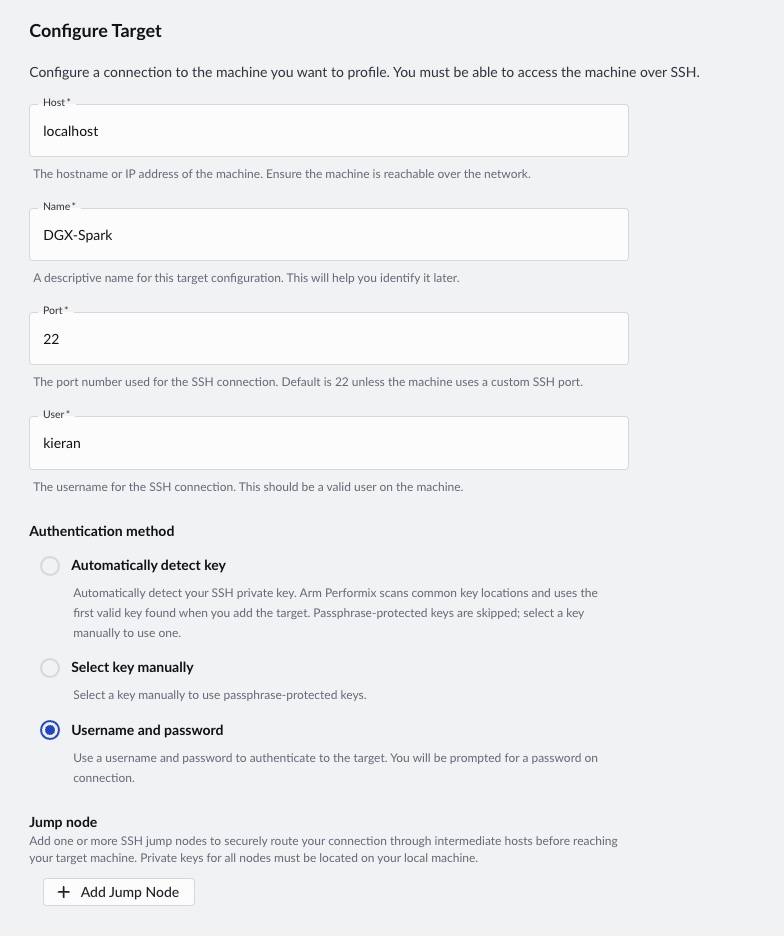

In the Configure Target form, provide the following details:
~/.ssh/id_rsa or ~/.ssh/id_ed25519)~/.ssh/known_hosts file
Configure Target form with connection settings
Select Add Target.

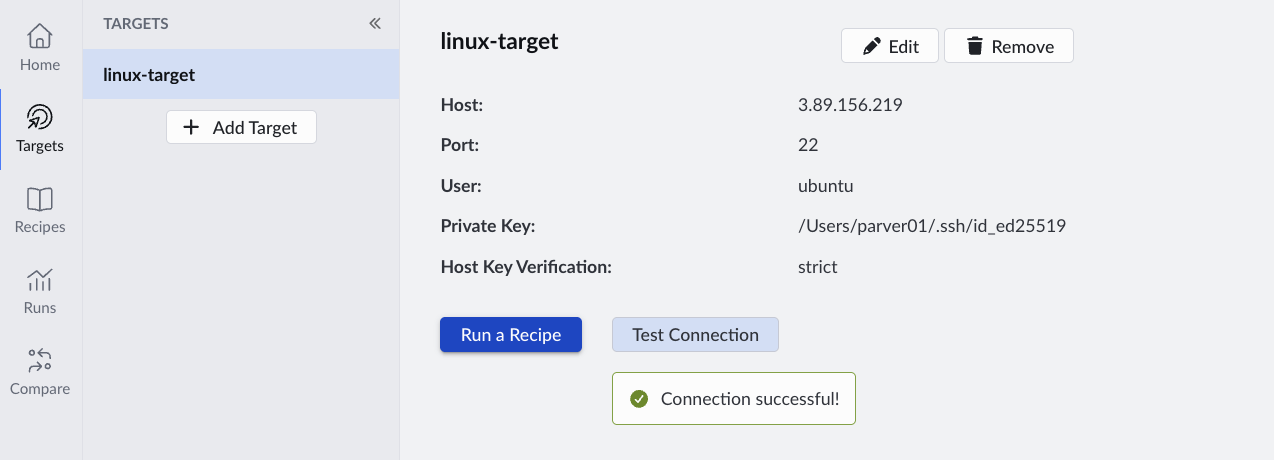

The target appears in the targets list and is ready for profiling.
You can select the Test Connection button to verify your connection to the Performix Linux target is successful.
Successful Arm Performix target connection test
