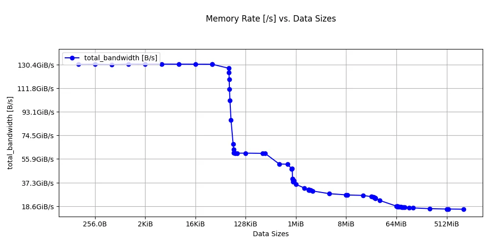

Some of the tests also generate graphs.
An example of a bandwidth graph is shown below:
Image Alt Text:Graph showing memory bandwidth sweep benchmark results with data size in MB on x-axis ranging from 0.001 to 1000, and bandwidth in GB/s on y-axis ranging from 0 to 300, displaying multiple colored lines representing different CPU configurations with performance peaks at smaller data sizes and declining bandwidth as data size increases beyond cache levels alt-txtBandwidth sweep benchmark results
