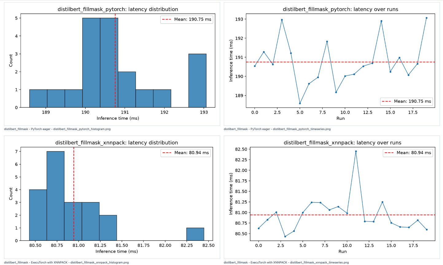

Example DistilBERT results are provided below, and yours will likely show a similar pattern, though are unlikely to be identical:
RuntimeWarmupsRunsMeanMedianMinMax
PyTorch eager220190.75 ms190.59 ms188.59 ms193.06 ms
ExecuTorch with portable kernels1120,699.95 ms20,699.95 ms20,699.95 ms20,699.95 ms
ExecuTorch with XNNPACK22080.94 ms80.82 ms80.43 ms82.45 ms
Image Alt Text:DistilBERT PyTorch and ExecuTorch with XNNPACK benchmark plots in the browser dashboard.
In the example data, you will see the same pattern repeated from the GPT-2 tests.
XNNPACK reduced mean latency from 190.75 ms for PyTorch eager execution, to 80.94 ms, a speedup of approximately 2.4×. The single run of the portable kernel artifact took around 20.7 seconds.
