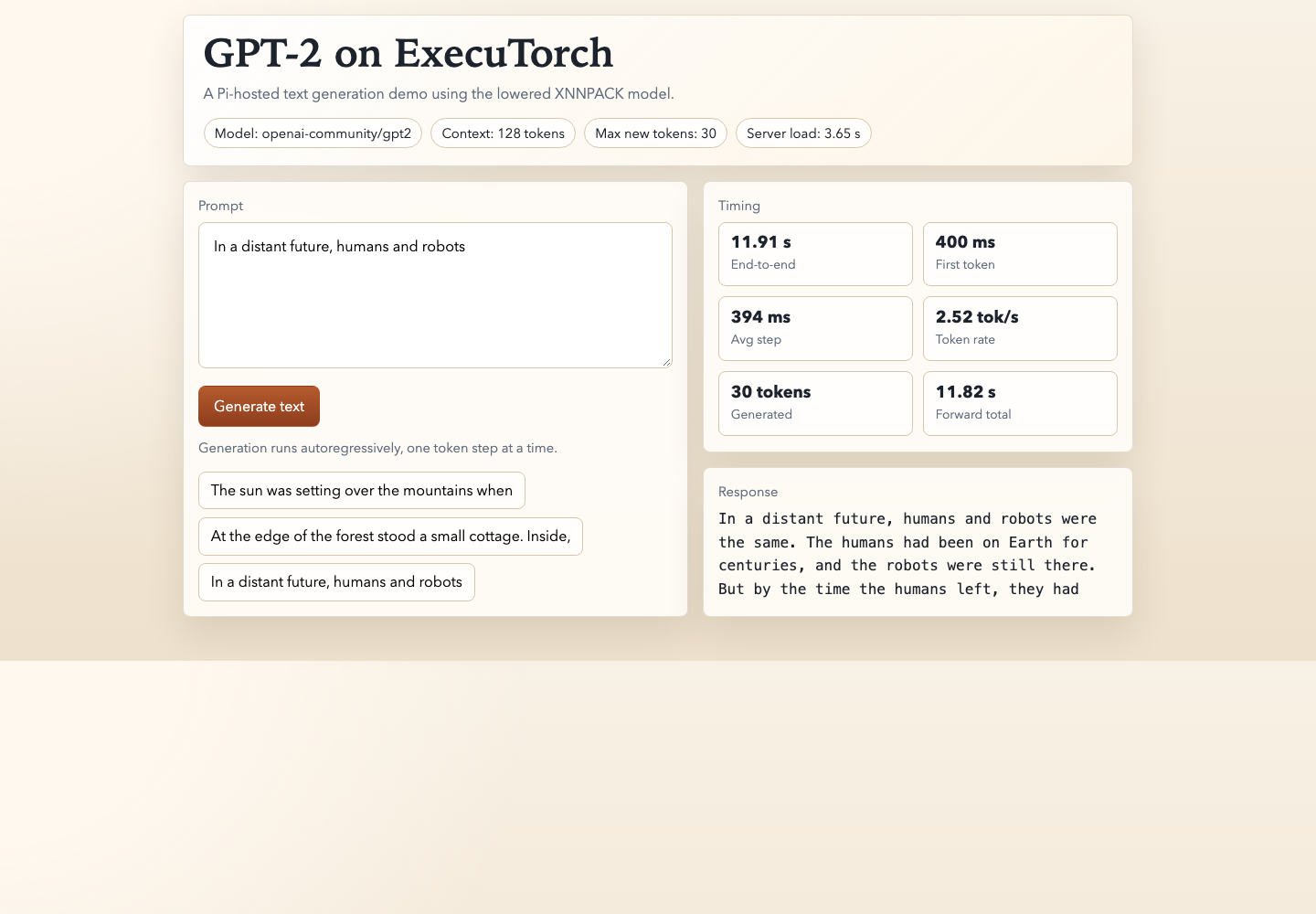

Try out the application by entering a prompt and generating text. The timing panel reports the end-to-end request time, first-token latency, average decode-step time, token rate, generated token count, and total model-forward time.
Do not worry if the generated text is strange. GPT-2 is an older base model, not a chat- or instruction-tuned model, and this demo uses a simple sampling loop. The purpose is to inspect the runtime integration and timing behavior, not to build a production text-generation application.
Image Alt Text:GPT-2 ExecuTorch text-generation demo running from the Raspberry Pi.
The demo takes longer than the benchmark because the benchmark measures one fixed next-token forward pass, while the demo generates many tokens. The demo does not use a KV cache, so each generated token runs another forward pass over the current context window. The total latency is the cost of many ExecuTorch forwards plus tokenization, sampling, and page handling.
